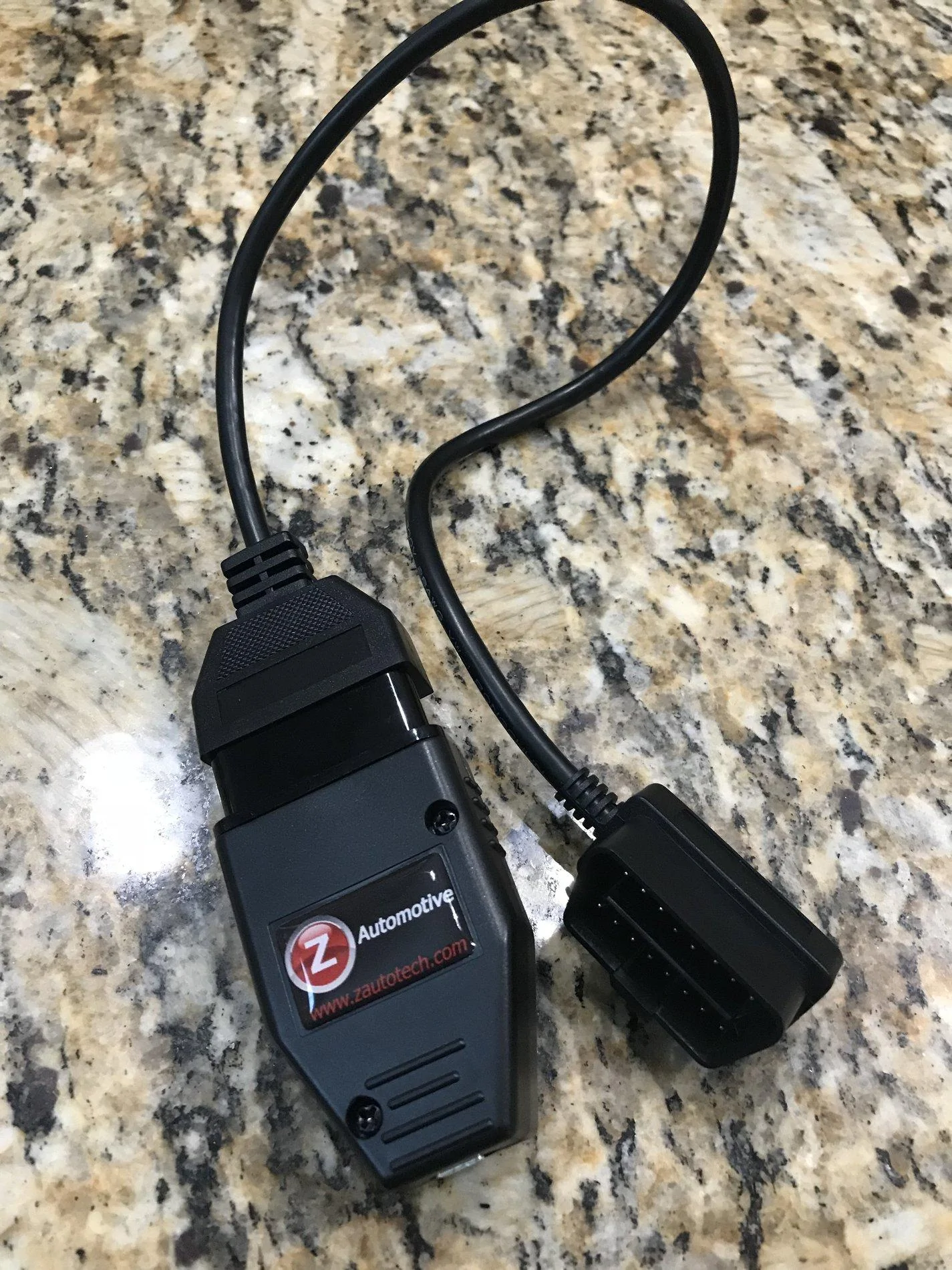

For those who are concerned with the obstacle of something slightly protruding from the OBD port or for those who are leaving it in for the Live features and want to conceal from prying eyes.......simple/cheap fix.
Yup, mine is being delivered tomorrow. HEY, great pic... exc. clarity, etc..
How much was that cable and where did you get it from?

Ok, installed the 12" long extender cable just now. Works aok. I velcro-ed the TazerJL to the underside of left kick panel. Fits right in there. Velcro-ed there, as l knew it would rattle if l di not. The SWG bypass module is velcro-ed just above OBDll port.
Thanks for the idea, Firemedicsparky.
