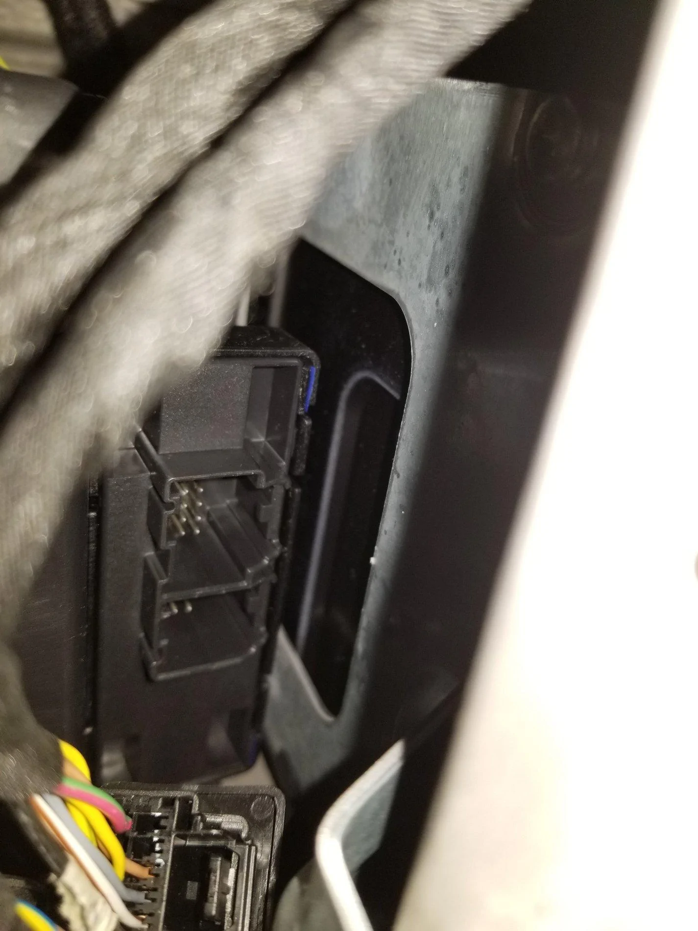

Ok, I spent an hour and a half trying to get that left plug out. I was able to firmly, and I mean firmly press the clip in and it would not budge. I tugged on the wires much harder than I ever should have. Thank goodness they didn't come out.
I'm going to try one more time Saturday morning when I am rested and can concentrate a little better.
Z-Auto, I need to know if there is a trick. The one on the right came out relatively easily, with a positive click. The one on the left makes no such noise. I stuck the right one back in so that I can drive my Jeep to work tomorrow.
If I can't get this left plug out, I'll be extremely disappointed because I love the features this product unlocks. However, I will be politely requesting a refund. It isn't worth tearing a wire loose and causing myself a big problem that will be difficult to explain when trying to get it repaired.

I had the tab pressed as far as it would go, with a solid, firm press. I also tried pushing the plug back up in there and there is no movement. The tolerances on this thing are tight. At one point, I even had a good grip on the other side of it so I didn't have to pull on the wire. No dice. There is no play or movement. The tab has plenty of travel, and I used it all, again, firmly pushing it all the way in.
I did all kinds of hand/finger yoga to get a good press. It took forever, but trust me, I got it. No luck.
The right one took a couple tries, but came out pretty easily.

Another concern this give me is having to unmarry it, reverse this, and do it again every time I take my Jeep to the dealership. There must be a better way to get in there. What if the lower dash panel were removed? Anybody tried that?

I just looked at mine, but I don't think removing the lower dash panel gains you any extra access to that plug since the clip is on the back side(towards the front of the vehicle.) Maybe removing the module that sits on the other side of that metal plate with the hole in it will make it easier to see/feel(If you can get your head in there)

Maybe a small flat blade screwdriver in between the latch and the "hook." That is if you can get a screwdriver in there.... You probably don't want to hear this, but I took mine out and put it back in a few times just now to make sure it would easily come back out and it did. Maybe you just have a lemon of a clip :headbang:

Yeah, I'm worried the clip is defective. To get a screwdriver up there, it has to be longer than any I have. I tried one that was pretty long and it was about an inch or so too short. I'm not sure it would have helped, though. I had a solid press on that clip.

I have a tip that might help. Rather than try and get both hands up there, first wrap the cable you want to pull out with a thin wide strap. Let the strap hang down on both sides about a foot. That way when you press the tab with one hand, you can easily pull the strap with the other hand. Note, I haven't tried this but I wish I thought of it earlier when I did mine.
