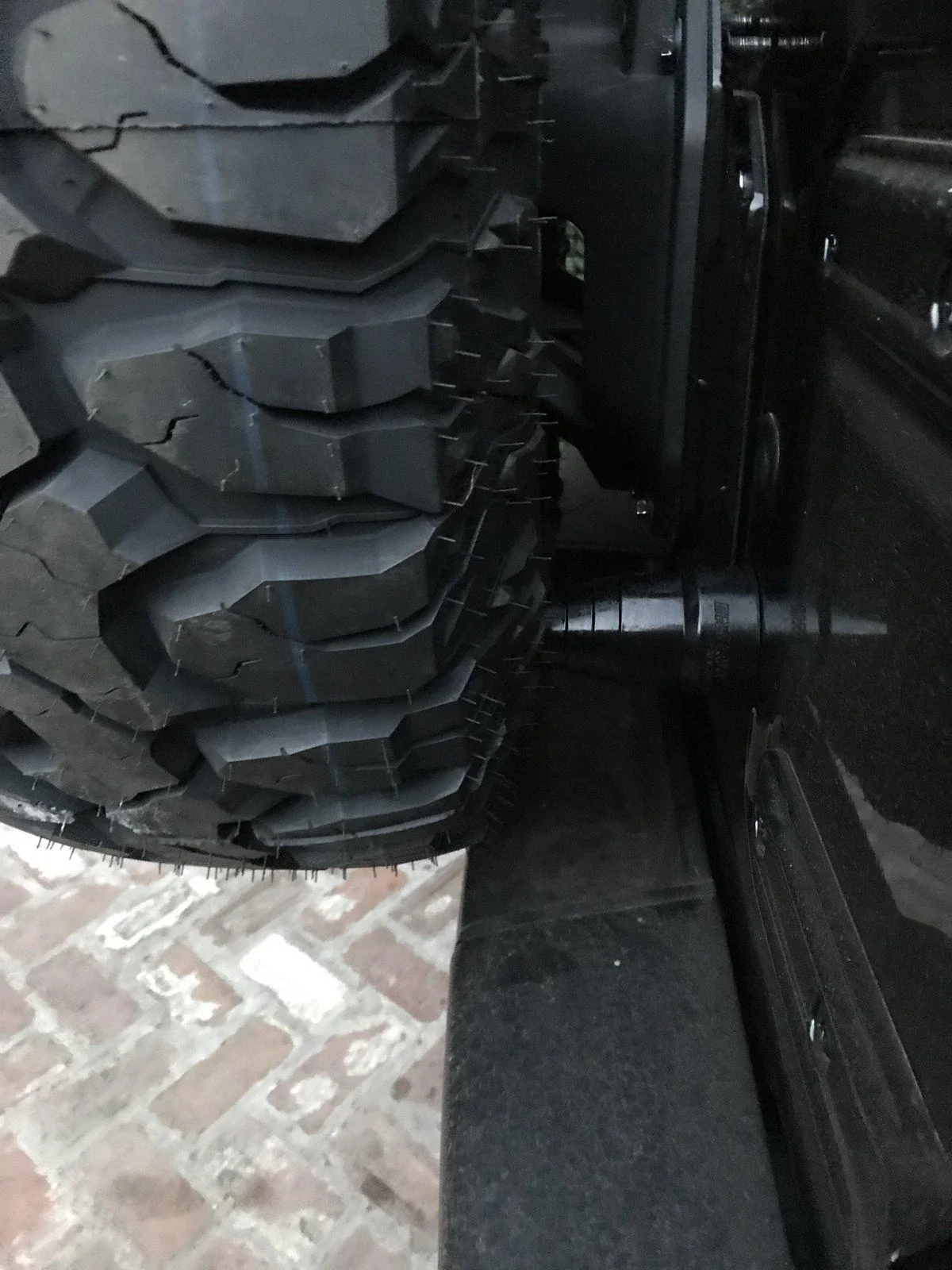

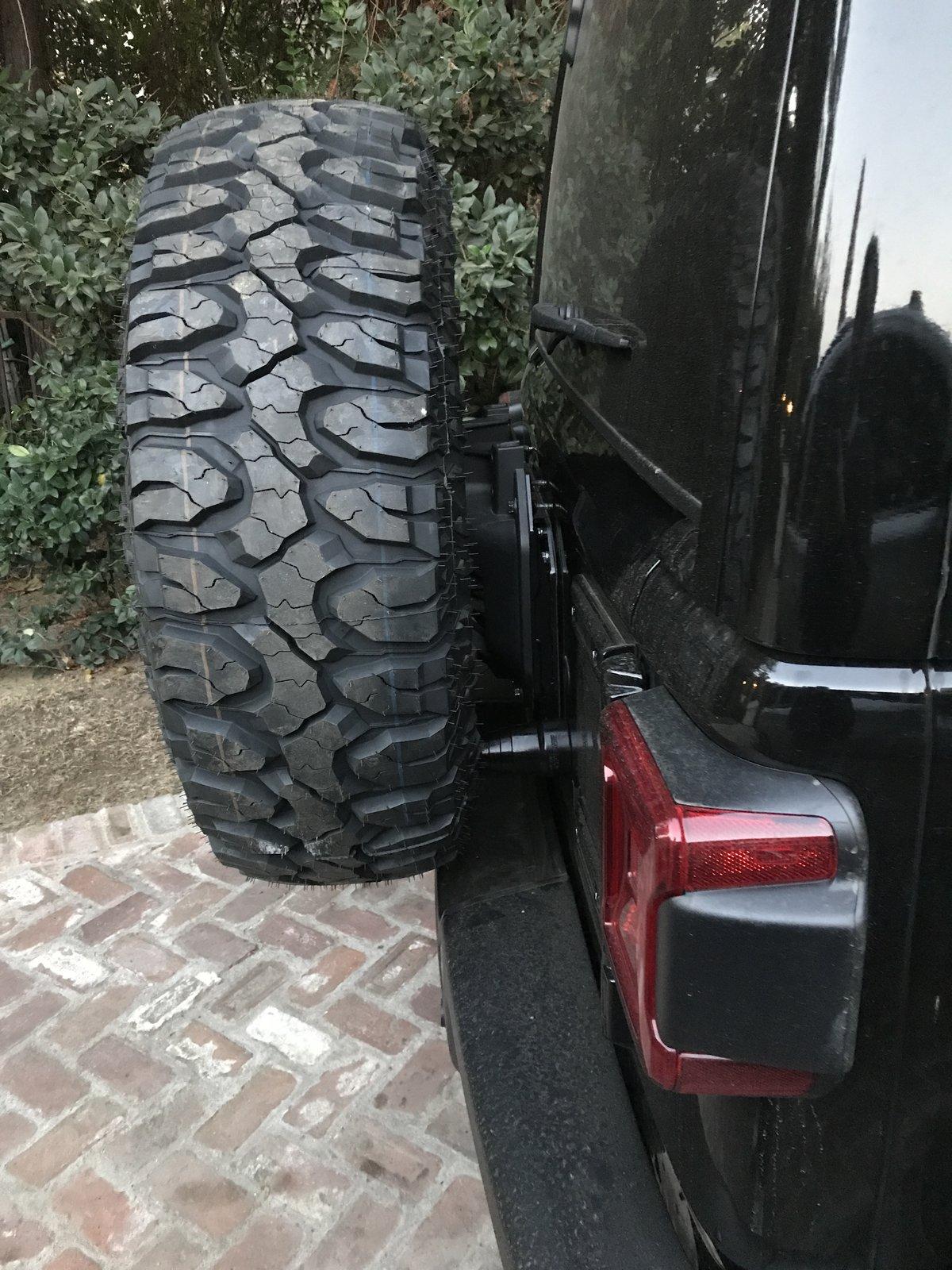

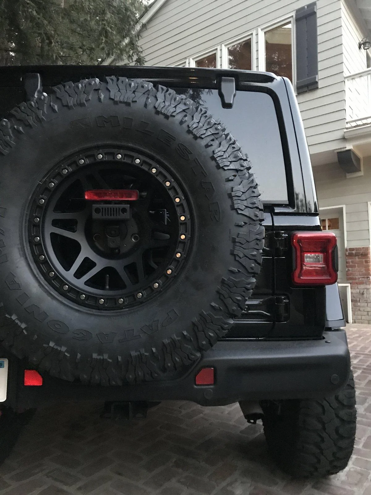

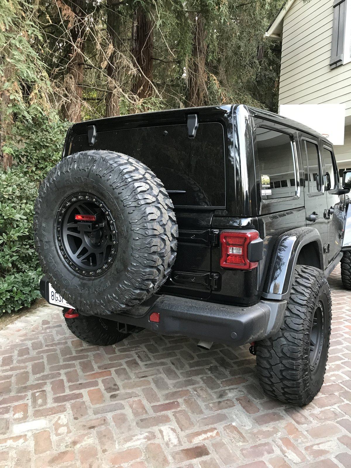

Hey guys I just put my spare setup on - Milestar 37’s w/ Method MR312’s, which seems to be on the lighter side. I used a relocation bracket but no reinforcement (yet). I did add extended isolators. I agree that these reinforcement brackets don’t seem to do much. I’m curious if you think this is fine on the stock tailgate or if I need to somehow reinforce or upgrade to something like the EVO carrier? Everything seems fine so far - no flex, opens and closes easily, no vibration.

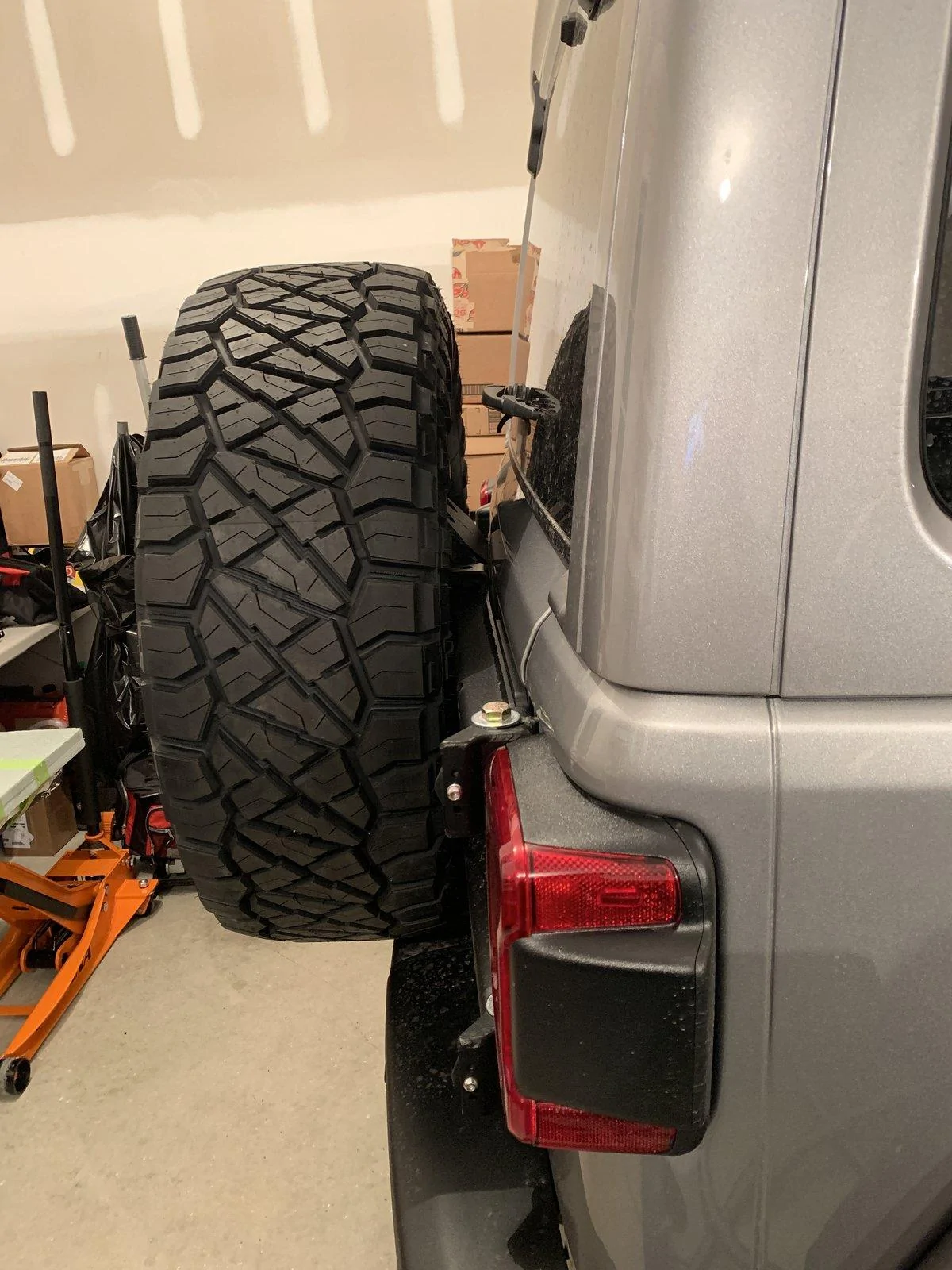

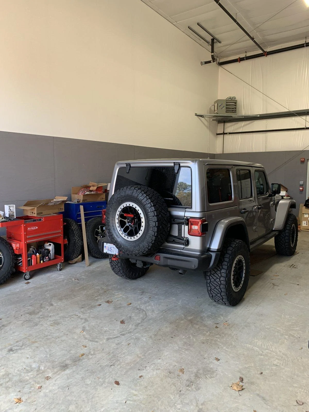

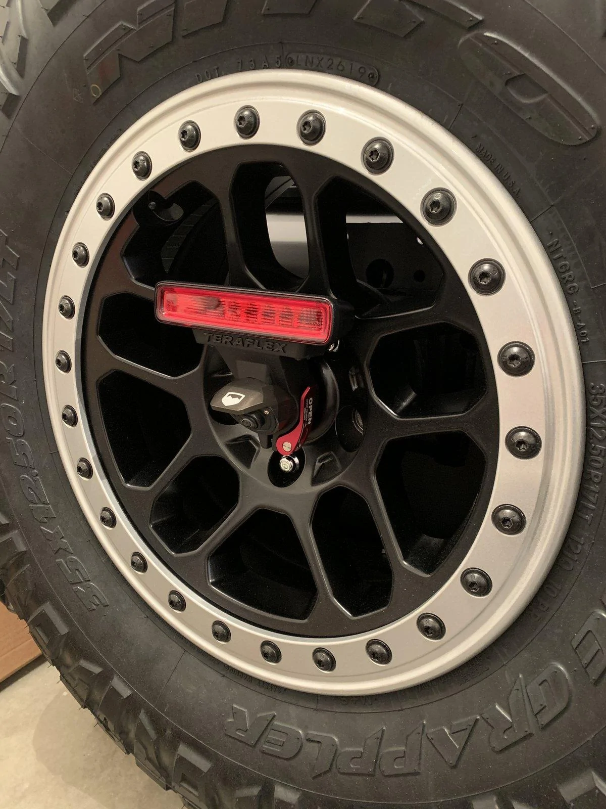

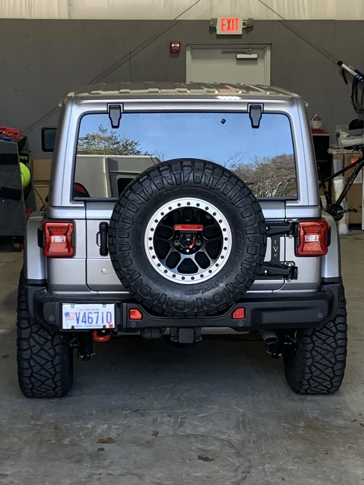

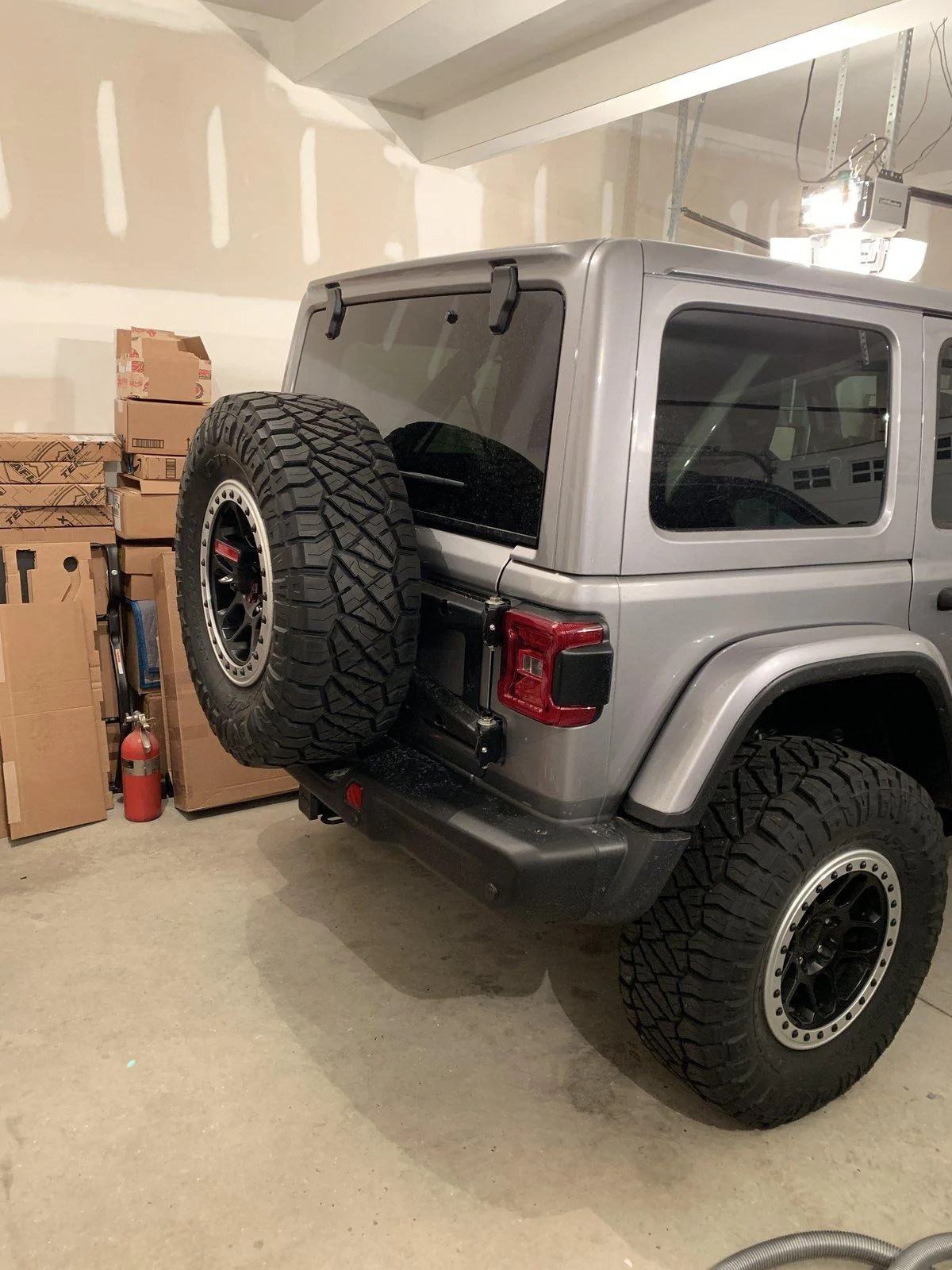

With a heavy ass Mopar beadlock and 35” Nitto Ridge Grappler weighing in at a 116 lbs my tailgate would drop a lot when I opened it. This was with the Mopar relocation/reinforcement waste of money kit. I since installed the Evo tire carrier and could not be happier. This thing is solid as a rock and looks great!!! I used the TeraFlex camera kit from their Alpha carrier because Evo’s solution is garbage and looks like a complete afterthought. I can’t imagine yours holding up very long the way it is, especially given that the tire now sits higher up and further out. The Evo carrier holds the tire really close to the body unlike most of these relocation kits. Evo Is not the only game in town though, Motobilt makes an awesome carrier, DV8, Rusty’s etc... Teraflex should be releasing theirs fairly soon as well. Let me know if you have any questions.

Their third brake like solution was an afterthought and an absolute joke, In order to change the tire you literally have to remove that little camera from the housing. I’m sorry but on the side of the road or trail I’m not caring a little T6 with me to remove a very fragile little HD camera in order to change a heavy ass spare tire. My other issue is the spacer plates that ride between the tailgate in the hinges are not thick enough and the quality of the fit and finish is abysmal for that price point. Also it’s just a very difficult carrier to line up and you almost have to concede certain things just to get it to work properly. But I don’t think it’s necessarily just an Evo problem, I think all of these types of carriers have the same types of issues, although other companies pay more attention to detail and have a better solution for the third brake light and camera. Just my opinion of course.
