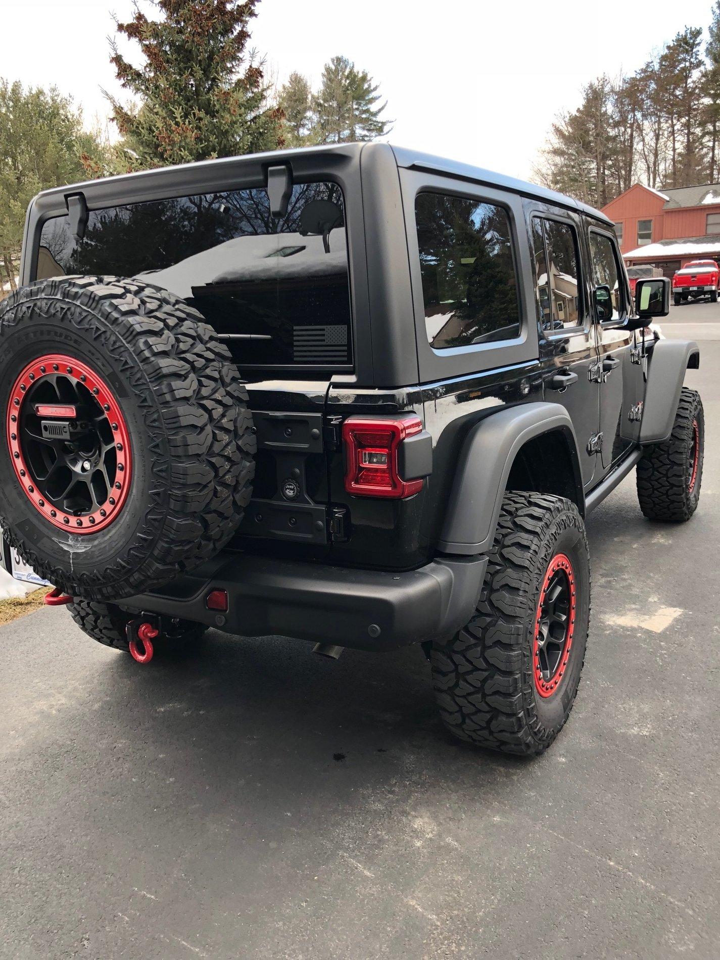

My understanding is that you need both, the stronger hinges and the tire carrier update. I just got my Mopar hinges and I am waiting for the tire carrier.
Is this a correct setup?

What's the point exactly if there is no reinforcement of the hinge?

I believe the hinges have no issues taking the weight. The reinforcement is to prevent the weight from buckling or damaging the tailgate skin. My understanding of it anyway.
