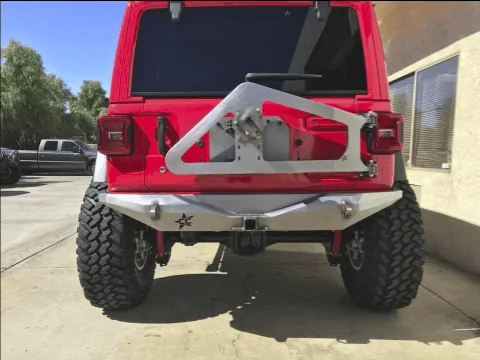

FYI it looks like CrawlerConceptz is releasing their version. I will be going with this one since it can use the factory hinge locations. Just got my Rubicon and had upgraded wheels & tires to 35s (will post pictures at some point), and had upgraded the bumpers so was hoping to not have to resort to replacing the rear bumper and it looks like this should work. Just wanted to inform everyone. They said on Facebook they are releasing parts on the 22nd, I assume this will be one of them:

Besides a bumper carrier, the best solution I have seen so far is the EVO hinge carrier. Not only is it a new standalone unit that replaces the factory brackets, it actually moves the tires TOWARDS the tailgate eliminating extra leverage. Having said that, I will still be running a bumper carrier for my 37.
Ah, thanks for posting that. Have been looking around for awhile for a solution outside of Mopar and hadn't seen anything from EVO until now. I'll definitely check that out as well as the Crawler.

The crawler, while looking impressive, seems to add to the leverage problem as well. If that's the style you want, I'd just consider running a bumper carrier at that point.
Regarding leverage, you're referring to EVO's solution being tighter up against the tailgate correct?
Grabbed this picture of the EVO from another thread, even though the crawler only has the one image available, definitely won't be as close:
Jeep Wrangler JL Tailgate reinforcement do we really need it? upload_2018-10-17_20-27-43

Correct, EVO's brings the tire closer to the tailgate almost 2.5".

Sold. At least this will allow me to keep the steel bumper upgrade from the factory. If I anticipated the tailgate dilemma, I would have passed on it and replaced the bumper instead. This is a good compromise. Thanks.
