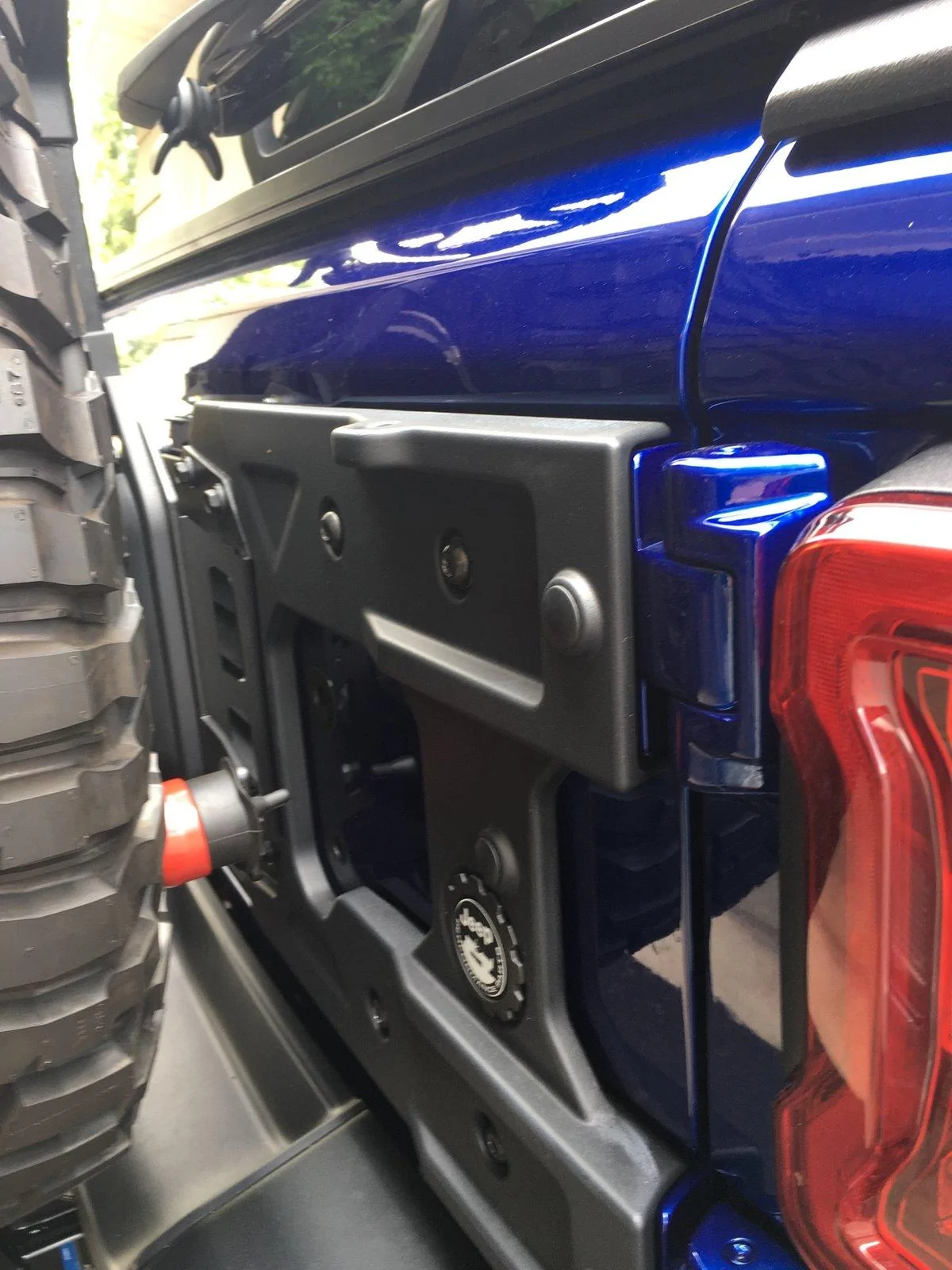

LOD makes a great product without a doubt, I had my hands on one unfortunately it was on someone else’s JL and they were not available. There is a difference between how the rubber snubbers mount and make contact.With the Smittybilt the rubber snubbers attach to the actual bracket and not the Jeep where as the LOD snubbers mount to the tailgate if I remember correctly. If you look at my tire carrier you can see the snubbers mounted and red caps are up against the tire. I will take a picture or two tomorrow so people can see what the stock JK hinge looks like compared to the JL. totally different set up

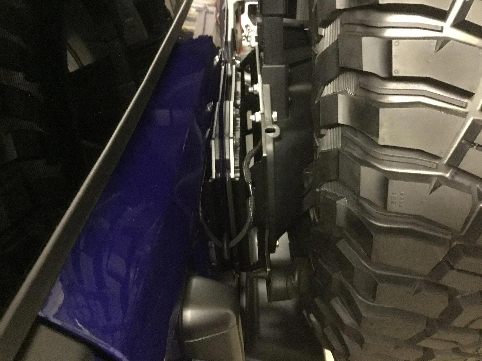

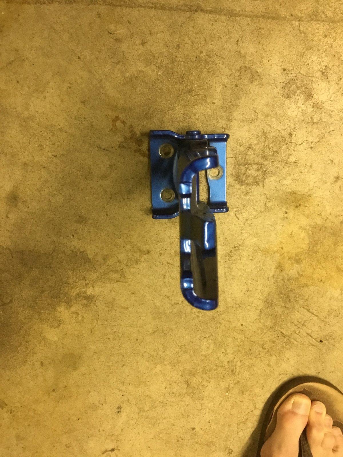

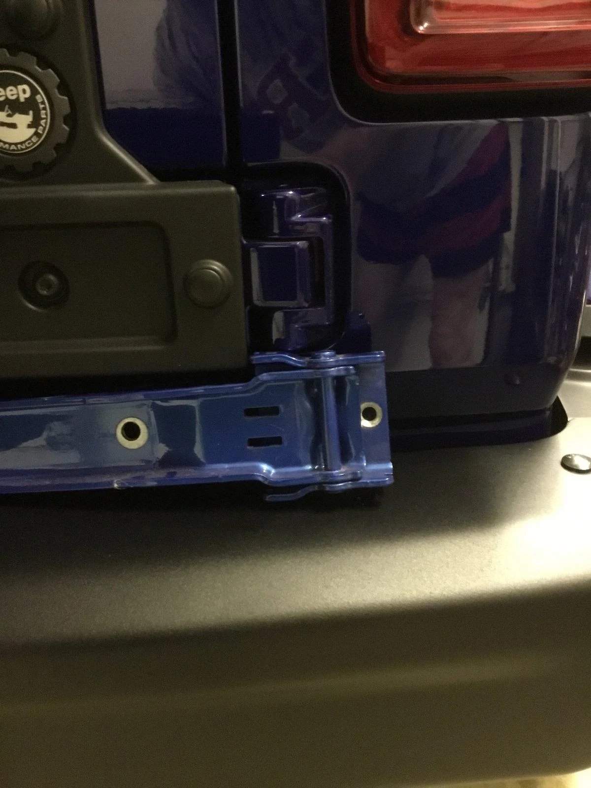

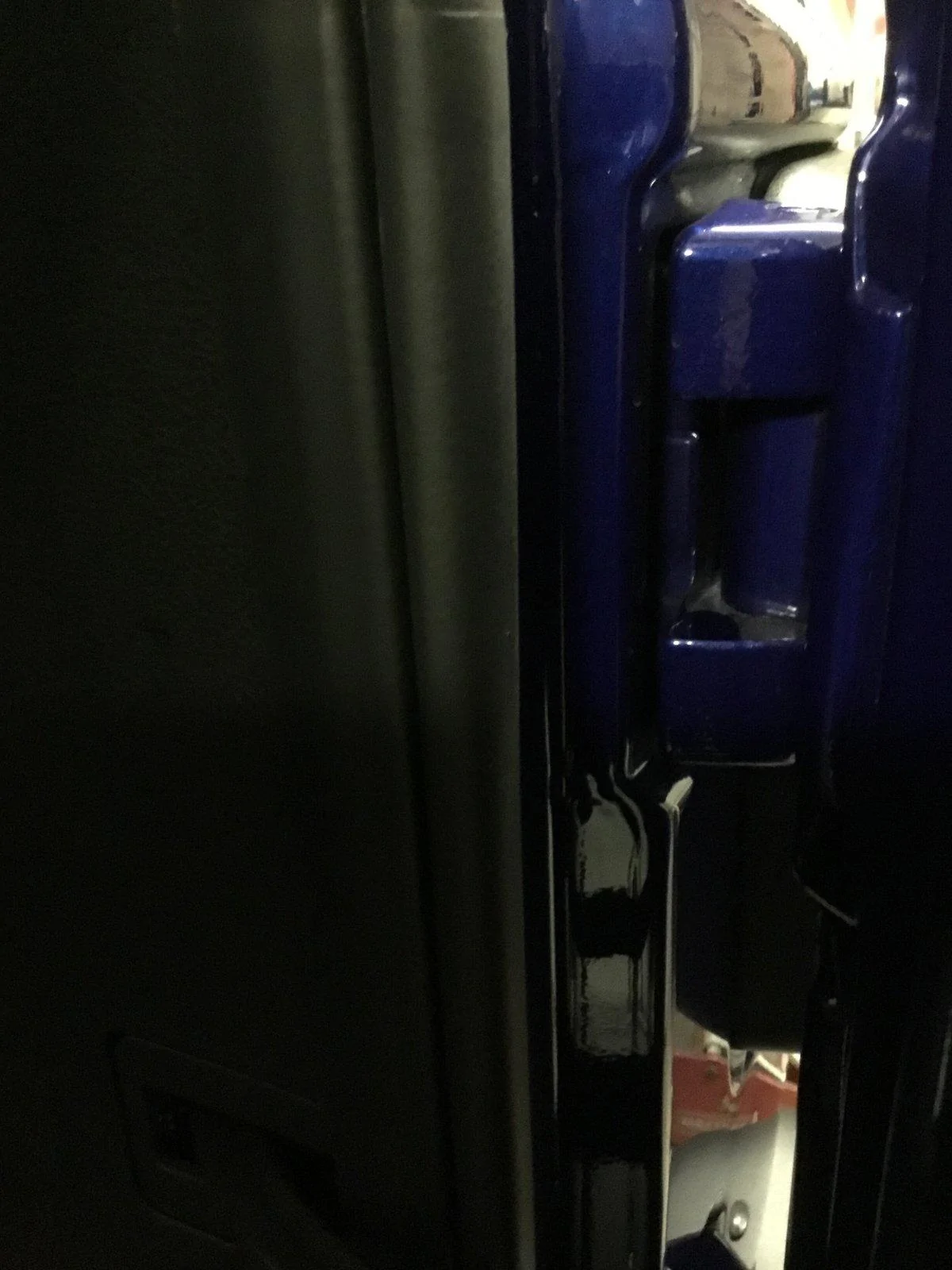

Ok, here are a picture of the factory JK 3 bolt hinge, along with the backside of the Smittybilt carrier with the rubber snubbers

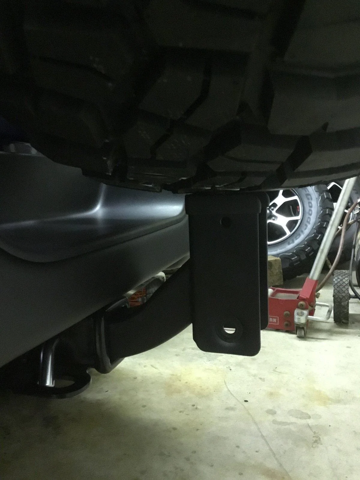

Lastly this is my quick fix for now, the spare just makes contact with it and uses the factory hitch. Shake it pull it kick it and the tailgate does not flex at all.
Skyjackers bracket will definitely leave you with a bruise and some colorful language. I know it kills the use of your hitch but I don’t trailer often but it is a DD.
I plan on making a flat bracket with a ‘L’ shape and the shorter section on the L up and facing in towords the tailgate so no cuts and bruises. If you put a slight incline on the L that is facing the tail gate that makes contact with the tire it would put a slight amount of pressure under the tire. So far mine is working like a dream, we even put a 37’ swamper on a bead lock rim on it and just adjusted the height of the bracket. Tight and Right
Next up is to figure how to make it without using the hitch as the base. Any thoughts???

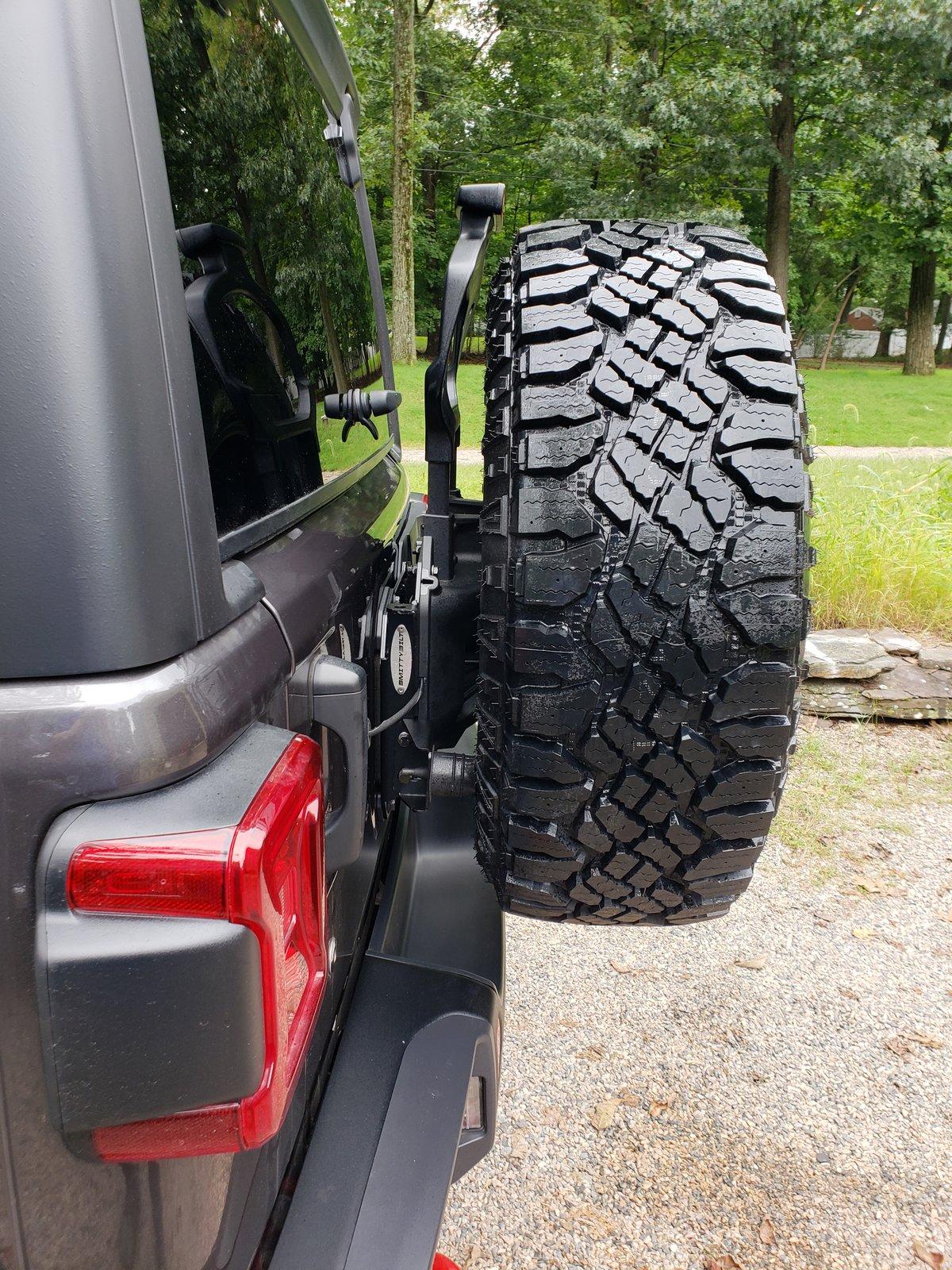

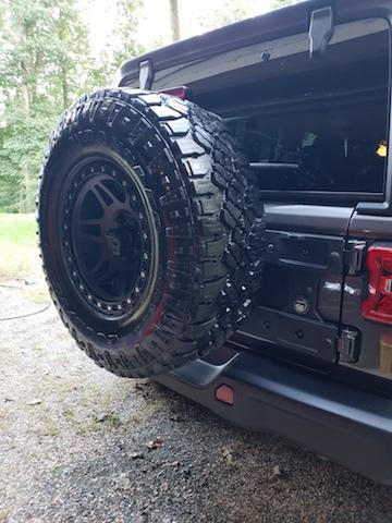

I'v been lucky I guess, carrier and tailgate is solid, hung on it and yank just from the top of the tire and the entire jeep moves.No rattling no vibrations, I loctited every bolt pretty heavy.
