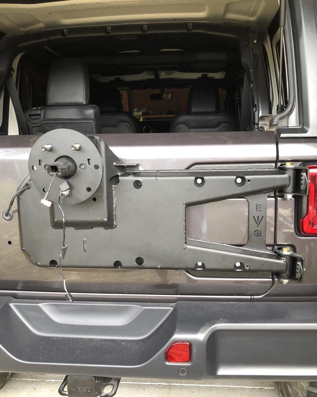

Negative, the Evo, Motobilt, Ace, DV8 are exactly like Rustys only they don’t have that end piece that needs to be drilled into the tailgate. This one isn't mine but it’s an Evo
Do you mean that it's not as strong because the carrier and the reinforcement are 2 pieces that bolt on and this are on piece?
Jeep Wrangler JL Tailgate reinforcement do we really need it? upload_2020-1-3_16-35-32
on the pic above you can see what I mean.
I like the looks best but if the general recommendation is it's not great, I'll go for the Motobilt or maybe wait for the Maximus 3 to be released.
thanks!
It’s not as strong because it uses the tailgate to reinforce half the tire weight versus these other options. In my opinion either wait and see what TeraFlex comes out with because they’re working on one right now and their quality is usually top-notch. The Motobilt is my favorite carrier but it wasn’t in stock and leadtime was 10 days out. I needed a carrier ASAP for a trail ride the following weekend which is why I ended up with the Evo. Now don’t get me wrong, once installed the evo is rocksolid and supports the weight really good, I just don’t like the fit and finish or the way it goes together. Keep in mind that the Motobilt is shipped raw and needs to be powder coated.
