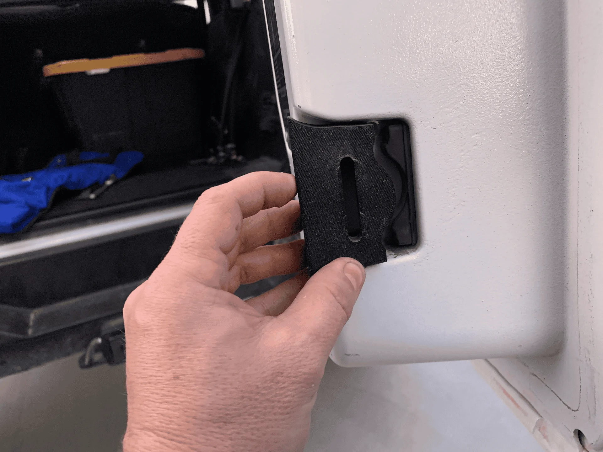

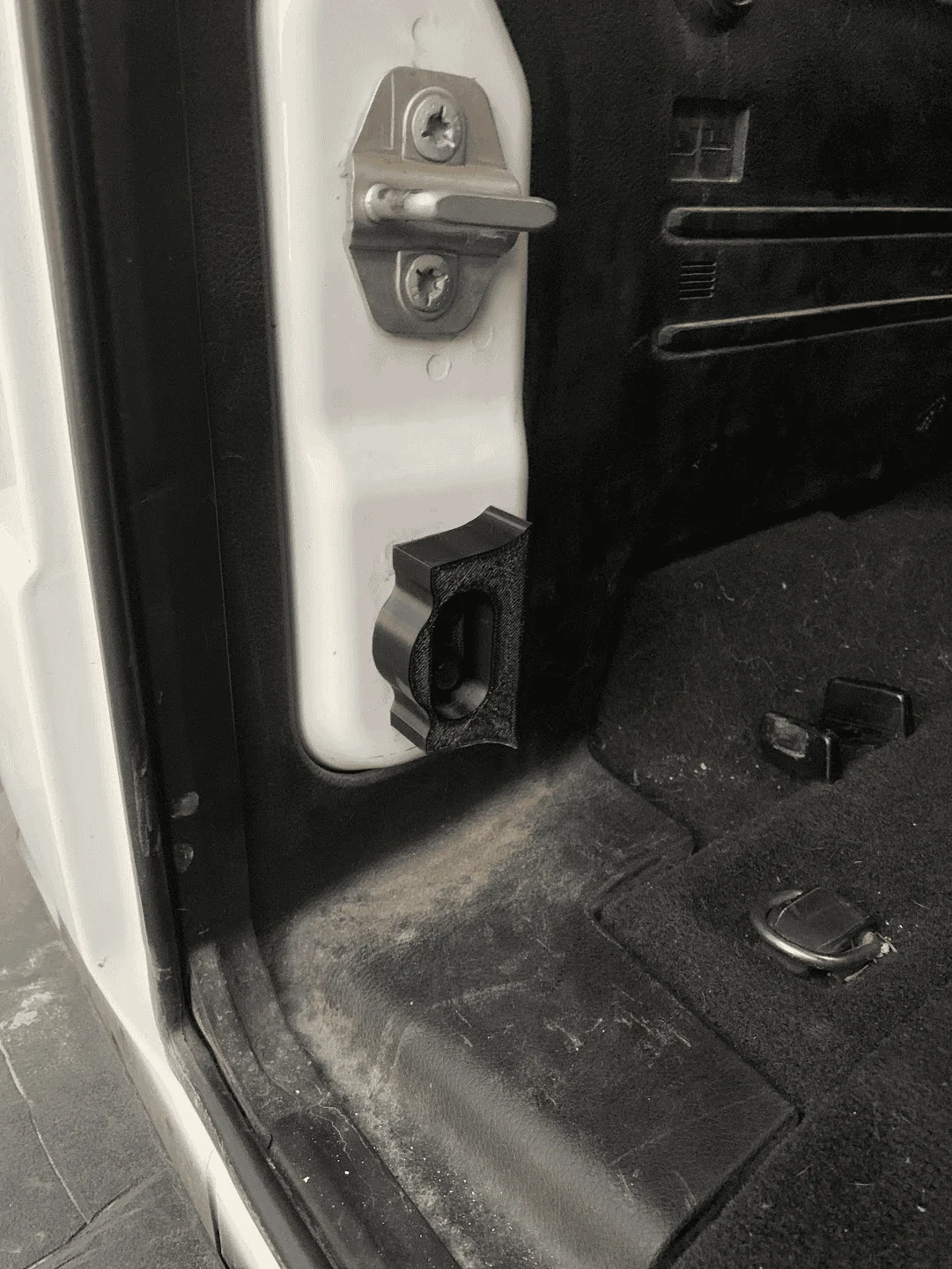

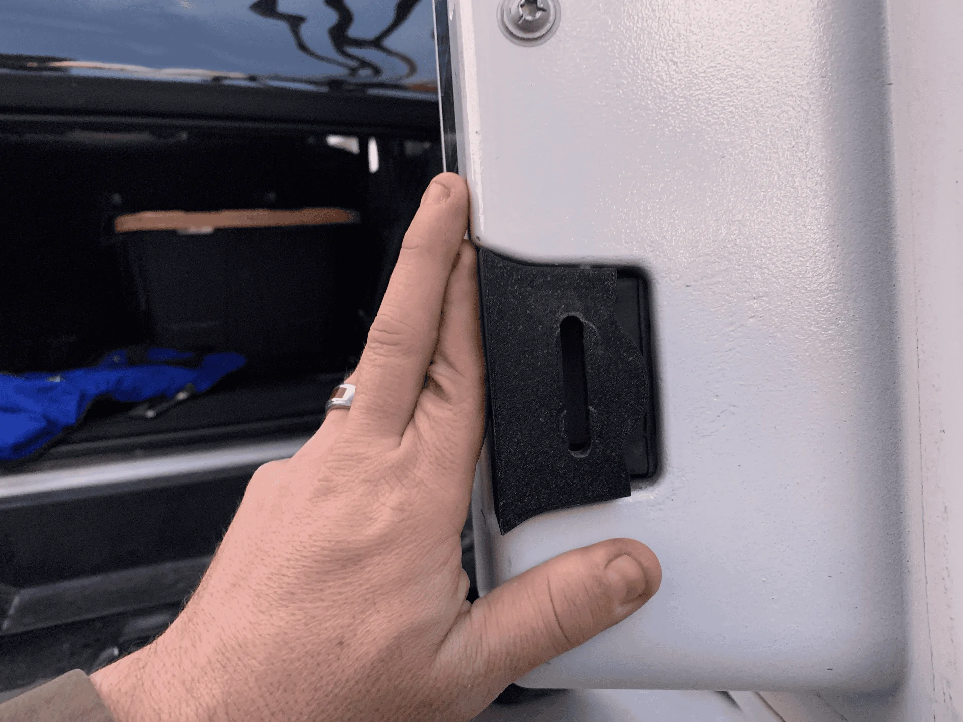

Thanks for the kind words, y'all... Here's a few pics. This is the first/rough draft, but after a day of driving around on it... OH. MY. GAWD!!! The rattling is GONE!!!!
The fist pic is of it installed. Second is where it initially makes contact. Third pic is pressed in, making contact with the rubber bumper and sitting flush to the face of the tailgate.

I just tried this and it was worse than my factory latch. The problem is there is no front-to-back adjustment. I ended up putting the factory latch back and adjusting it properly.

Hi @Rhinebeck01, I think it just didn't work for my JL. Setup is pretty easy, I just tightened it enough so that it could be moved by the tailgate closing around it and then tighten it up. I'm thinking, for my JL, it needs to come forward a bit.
With the stock piece, I did the same adjustment. I started with the piece a little high, a little forward, and loose enough to be moved by the tailgate closing. I then opened the tailgate up and moved the stock piece 1mm more forward and tightened it down. Thus ensuring a tight fit against the rubber stopper.
