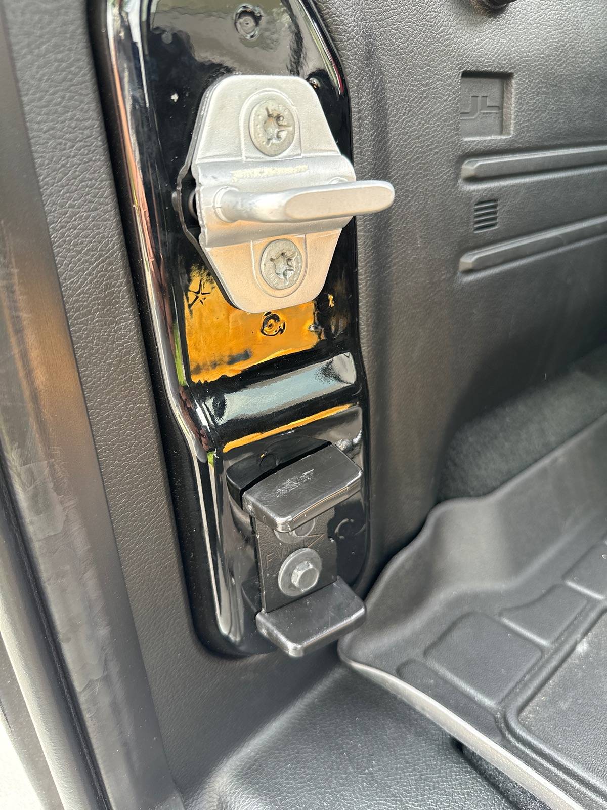

Question, on the pic above the black piece that slips over the tailgate latch, would this help prevent any of the rattle? I ask because mine does not appear to have that cover.
@ABF4775
No that black plastic that slips over the latch does nothing positive or negative in regard to the clunk/rattle thing.
It took lots of latch adjust and re-adjusts for me to zero in on the issue so to speak.
DO, if you have not... buy better bolts as mentioned earlier in this thread.
The crapola bolts that come with the latch stop bumper will not hold position .... the crappy bolts allow the latch bumper to change position/move..

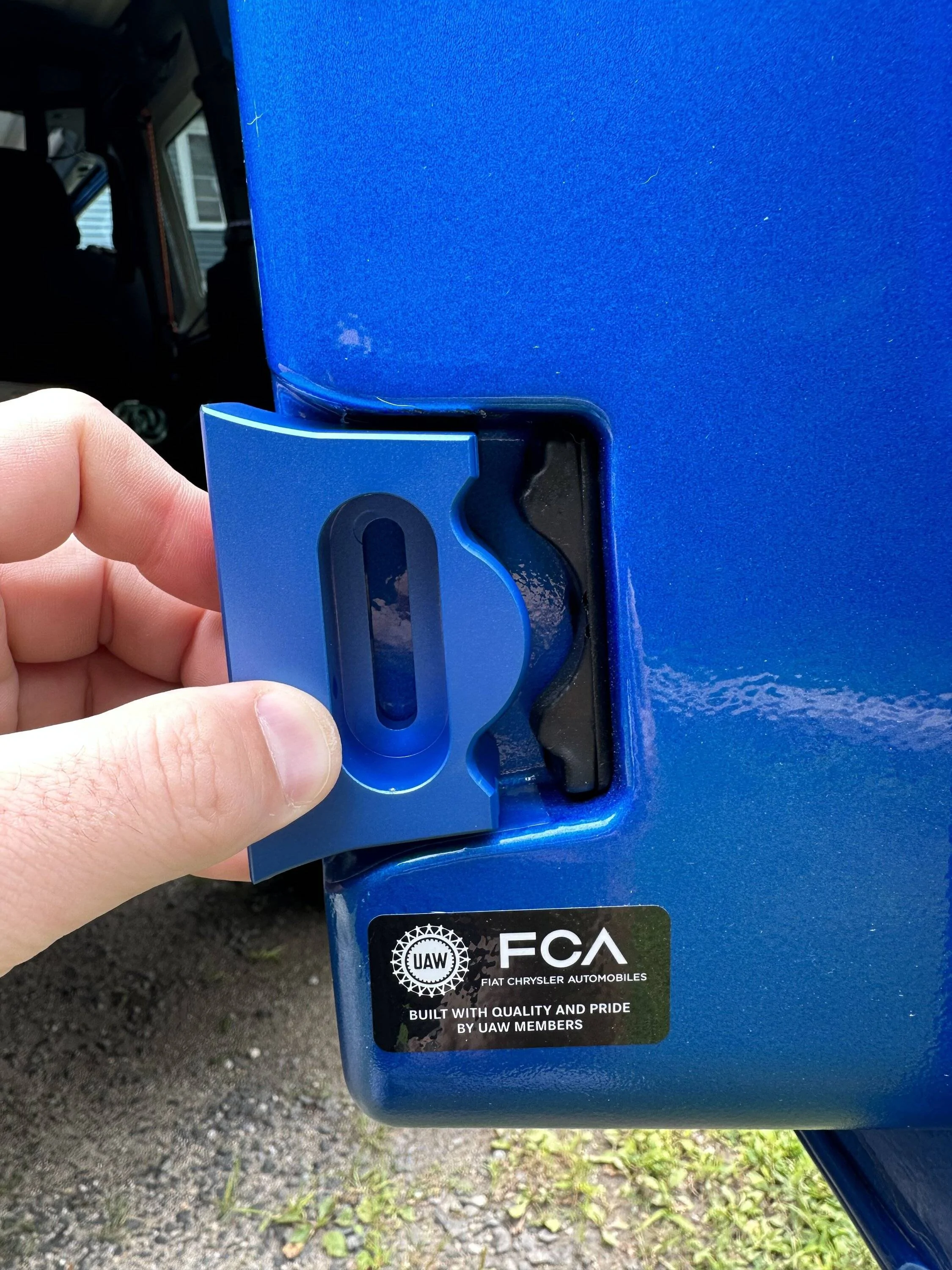

Bought my 14.80$ gate block and the rattle since new is gone.
Even with reinforcement and relocation it still rattled. My 35 out back just made it worse. Picked up some real hardware as well.
Just drove off some curbs and gtg.
Also I know it’s backwards in the photo. Was amazed with the color match lol.
