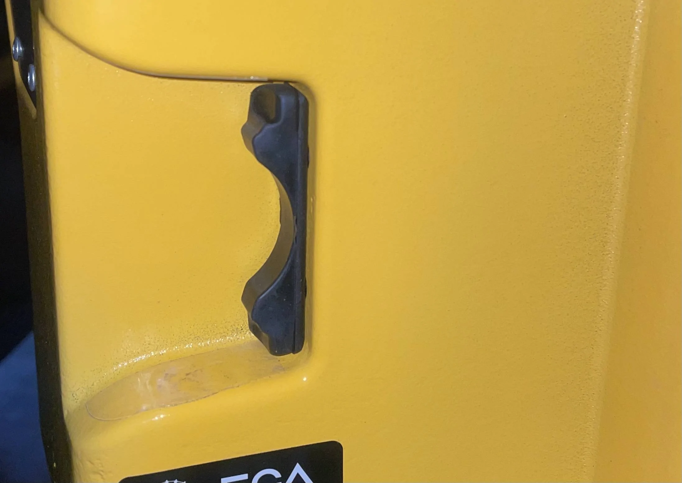

Would someone be willing to take a pic of the rubber on the tailgate itself? I’m curious if they added a piece of rubber to the 2021s. I noticed in the picture on Amazon that it doesn’t have that extra piece of rubber.
If you notice on the pic below, there is a flat piece of rubber under the curved part. Is this the same for the rest of the years?

Here is my 2019 and it looks the same:

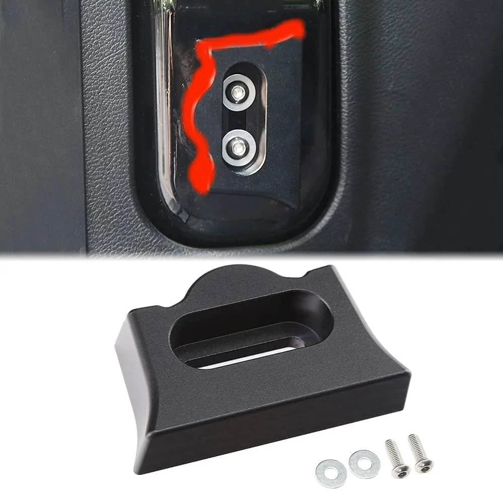

Well,it's been 26 days and almost 900 miles, since I installed this add on ..... It has worked out really well, but I was having a rare/slight/minimal, metal to metal sound when on wash board roads.
I adjusted and adjusted and could not get that very slight, occasional, rare noise silenced....
SO, about about a week ago / 200 miles ago or so, I took a neatly cut to fit, stripe of 3M Heavy Duty, black Velcro... the furry side and placed it around the bump stop.
You hardly see the Velcro unless you look for it... Anyway, that totally stopped any metal to metal noise.. In closing this add on works with a tad bit of help lets say.... BUT, yes it works!
How is this setup still working for you and can you post a pic of where you added the velcro. Thx
@RDender
Working great for me... won't be around my JL for a couple of days, so no can do pic today. DO see the pic below where I colored red exactly where I placed the heavy duty, extreme hold, black Velcro (furry side) to.

@KNN
Well, the aftermarket latch knocked out say 95% of the rattles that happened on wash boards roads, speed bumps and the like.. After the install I still had the rare, slight rattle but remedied that with some extreme hold furry Velcro placed around the latch itself..
YES, when I close the tail gate, I have to push hard/push firmly in comparison to how I did with the stock latch. And no the tail gate does not have a spring open feeling to it like it did with the stock latch... Anyway, very quiet.. no rattling like with the stock latch.
