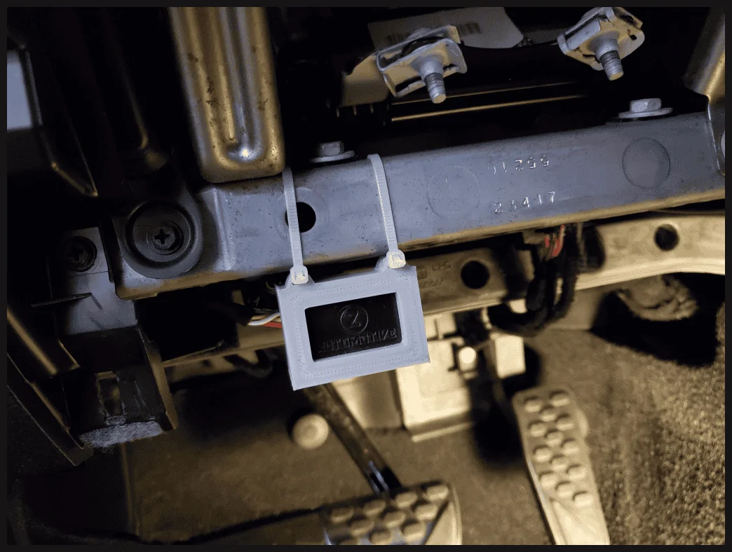

Hope this is the correct place to put this as I wasn't sure where to post it.
One of my hobbies are 3D design and 3D Printing. I designed a Tazer mount that gained some popularity here. I have other things in the works and figured I would post them here for those with 3D printers or friends with 3D printers to make these for them. I will add more links here as I design new items.
Tazer JL Mount
Link: https://www.thingiverse.com/thing:4973484
(Picture provided by @Rhinebeck01)

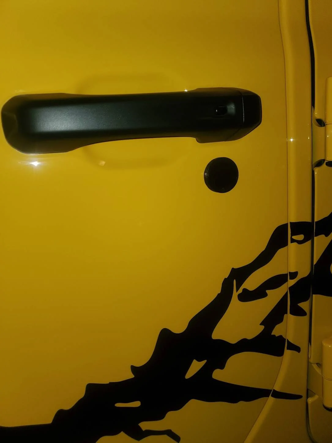

Key Lock Covers
Link:
https://www.thingiverse.com/thing:4974567
Jeep Wrangler JL 3D Designer Section for 3D Printers Key Cover

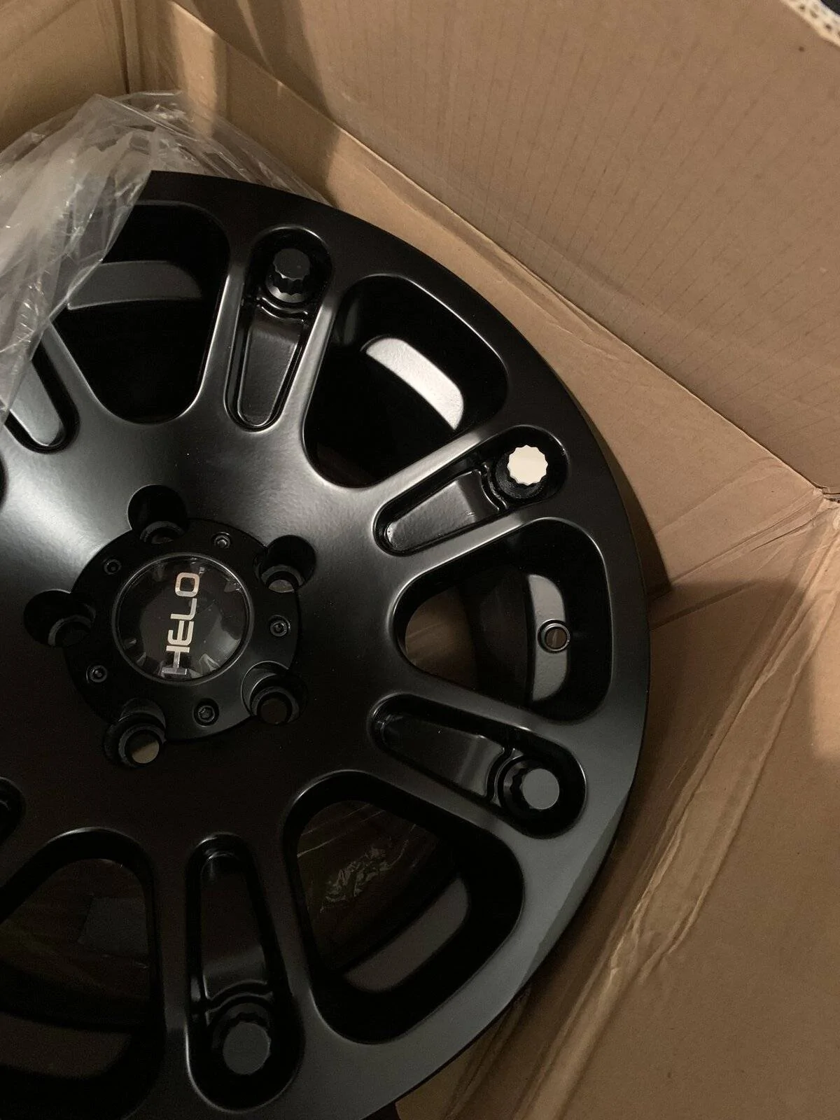

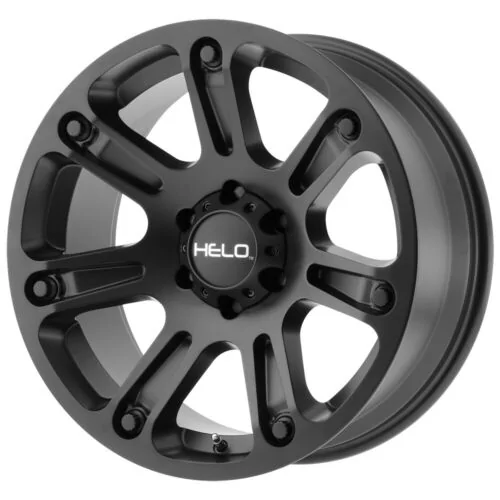

Background context: I have a 2-door *BRIGHT WHITE* JL which I've worked diligently to remove any red, amber, silver, chrome. Just black & white - which will explain the gist of this post in a bit.
I purchased some HELO 904 rims which will sit in boxes until I do my lift and settle on tires.
Jeep Wrangler JL 3D Designer Section for 3D Printers s-l500
Getting the lift and tires will not happen soon, so I have some time to tweak things in the meantime.
Having a Bright White JL, I thought having the "Rivets" at the end of each spoke white instead of black would be a bit more appealing.

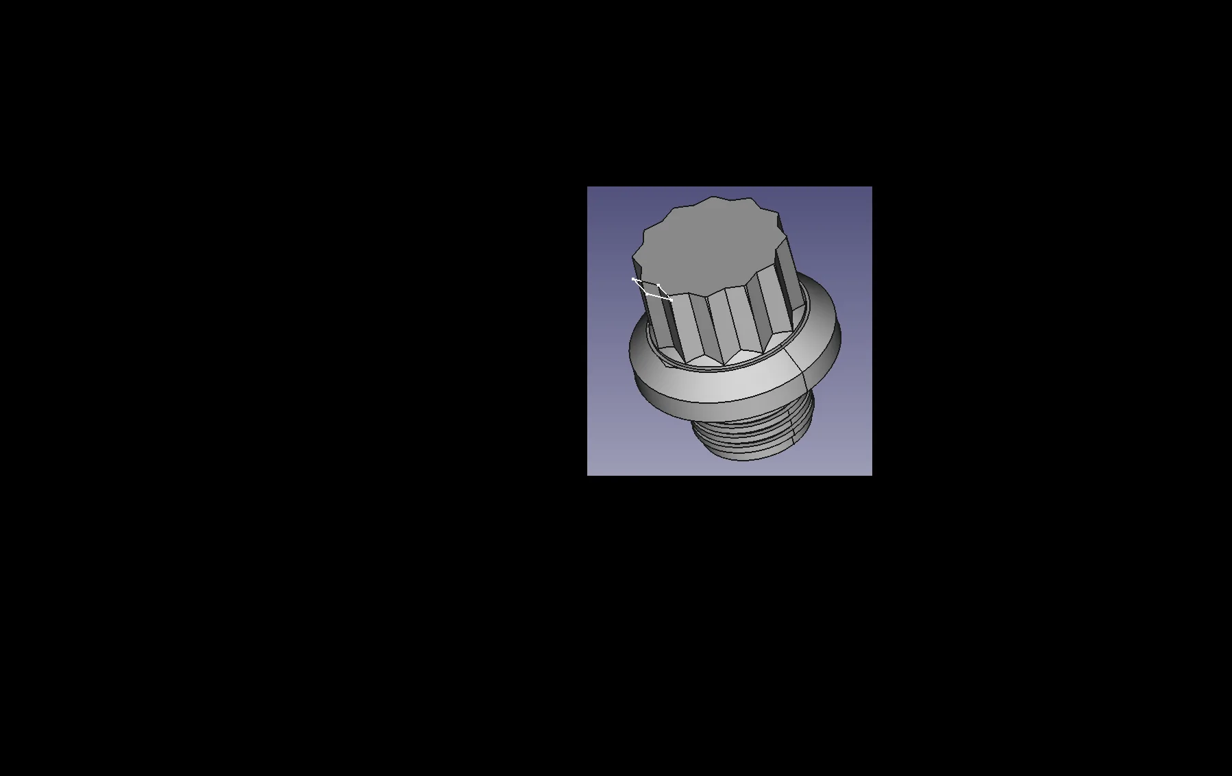

So I yanked one of them (they're plastic), put the micrometer on it, and rendered it in CAD:
Jeep Wrangler JL 3D Designer Section for 3D Printers helo-904-rivet

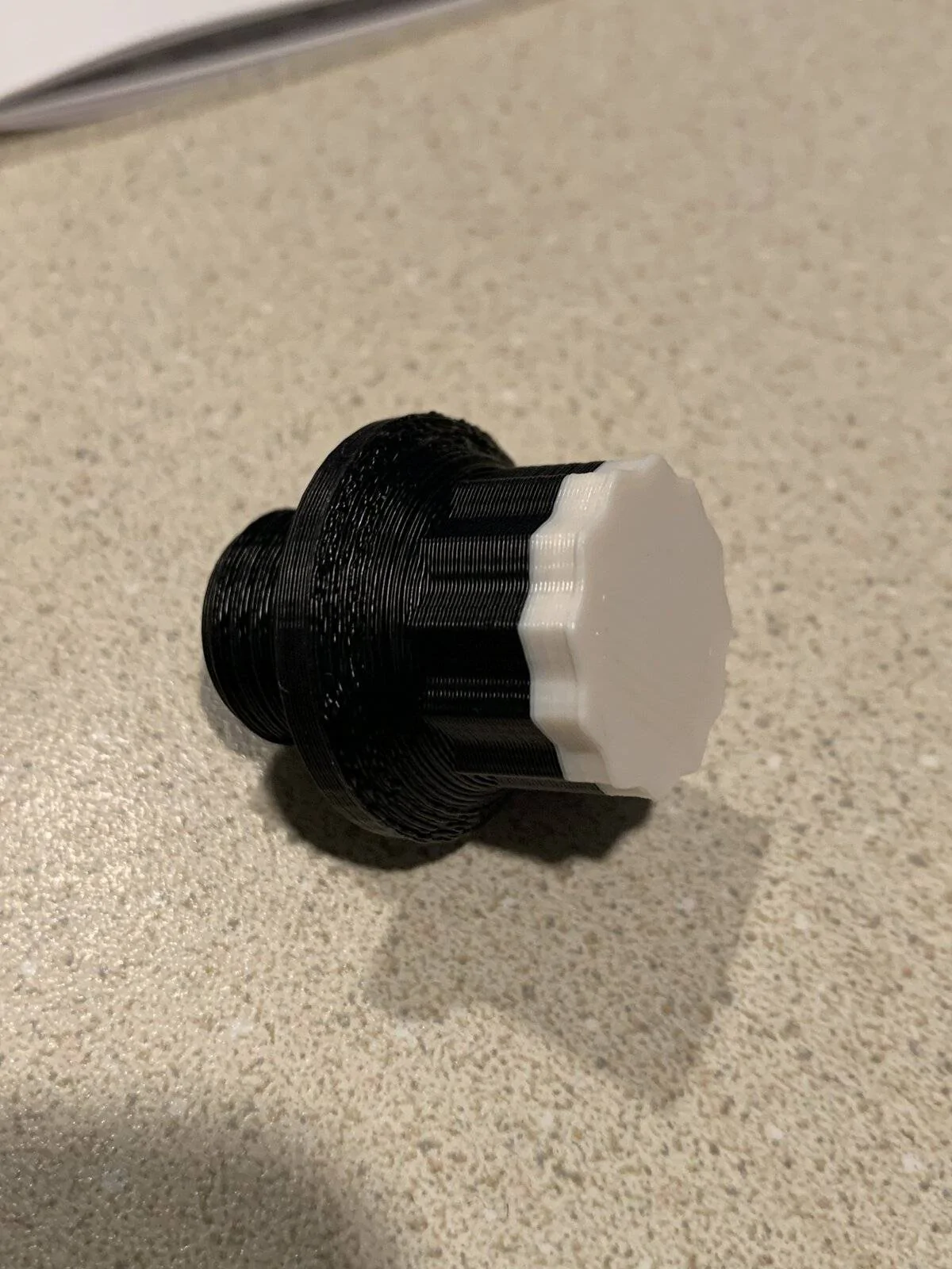

The model was spot on, but the first print -- printed all white -- was a bit too much
But printing just the tips white and the base black seems to look snazzy:
Jeep Wrangler JL 3D Designer Section for 3D Printers IMG_7751

Prusa printer, ABS filament (since it's going to be exposed to the elements).

I like the / your window in the holder, idea...
I use the holder I have (pictured a few times in this thread) for holding a ZAutomotive bypass module and not a Tazer JL Mini or Lite. I use the bypass module with JSCAN / when using a Scan Tool.
IF, I were to use it with a Tazer JL Mini or Lite, I'd like to be able to both see the LED blinking and to access the USB port.
So, if I ever use the holder I have (Thanks for that holder WilhelmSR) for a Tazer JL Mini, I will cut / drill out a small window in the holder so I can see the LED light and access the USB port...

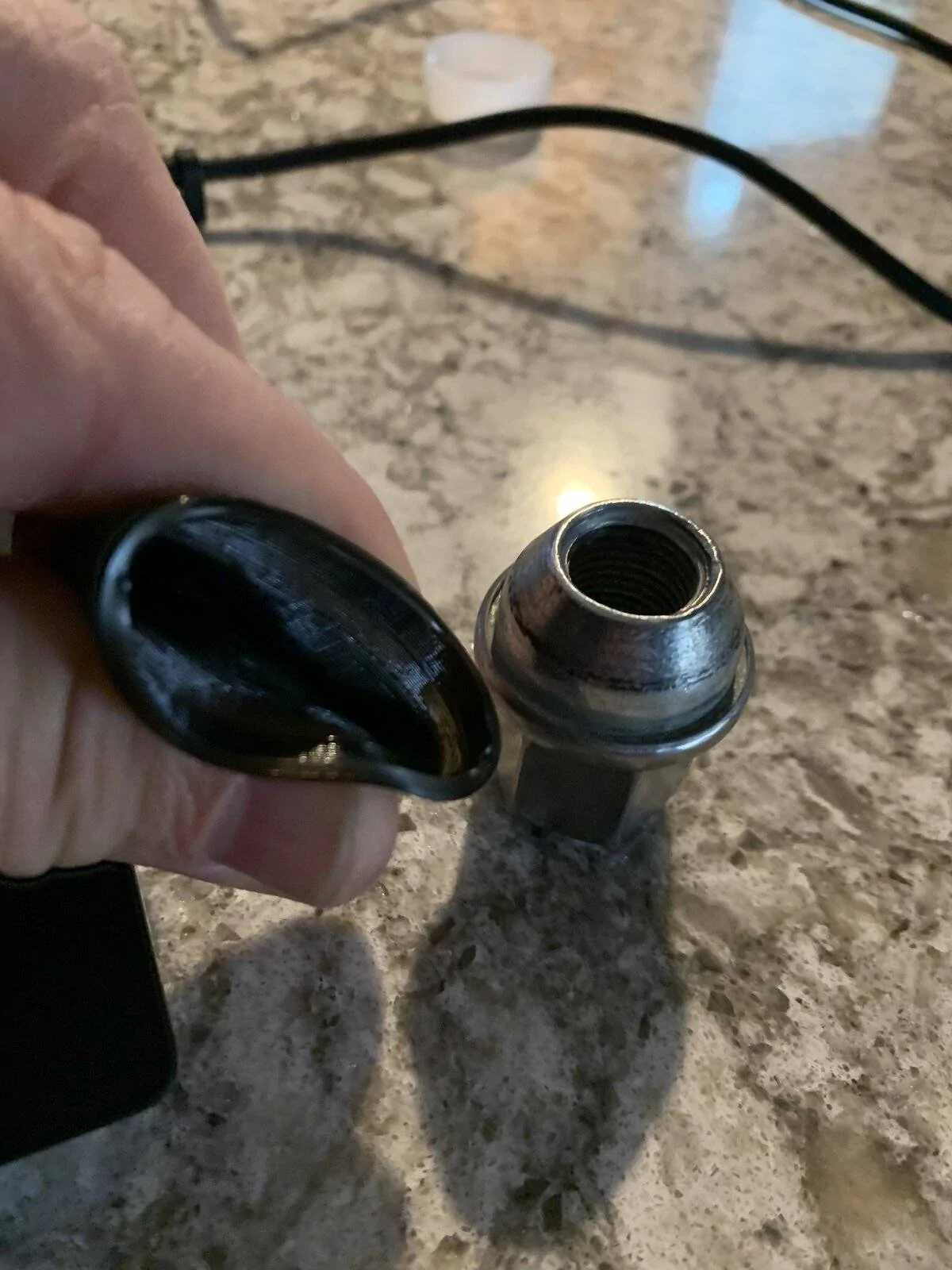

More bling for the fun of it.
Jeep Wrangler JL 3D Designer Section for 3D Printers AAA2B633-6011-4290-8BDB-ABC289F56ED6
Jeep Wrangler JL 3D Designer Section for 3D Printers 314197C1-ABCD-494C-A2BF-DC3927866AAD
Jeep Wrangler JL 3D Designer Section for 3D Printers 09CE2CBC-8579-4EC1-9F3C-CFD4A0EBB7D2
Jeep Wrangler JL 3D Designer Section for 3D Printers 3D46BDA9-8B7E-43E6-909E-F1187A1DFA71
Printed with TPU filament. Fits solid and comes off with a gentle tug. Secures over the lug’s inner brim pretty well. I designed a hex-topped version too, but like the cylinder look better.

I'd recommend putting a hole or something for pulling them off. When they get wet they could swell and clamp hard onto the nuts. Just a tweak to thick about.

They're ultimately pretty thin, and if needed, you can shove a lug wrench right through them to get purchase on the nut. I also have a good sharp knife in the glove compartment.
I've printed extras :)
Being TPU filament, they're pretty manipulateable.
