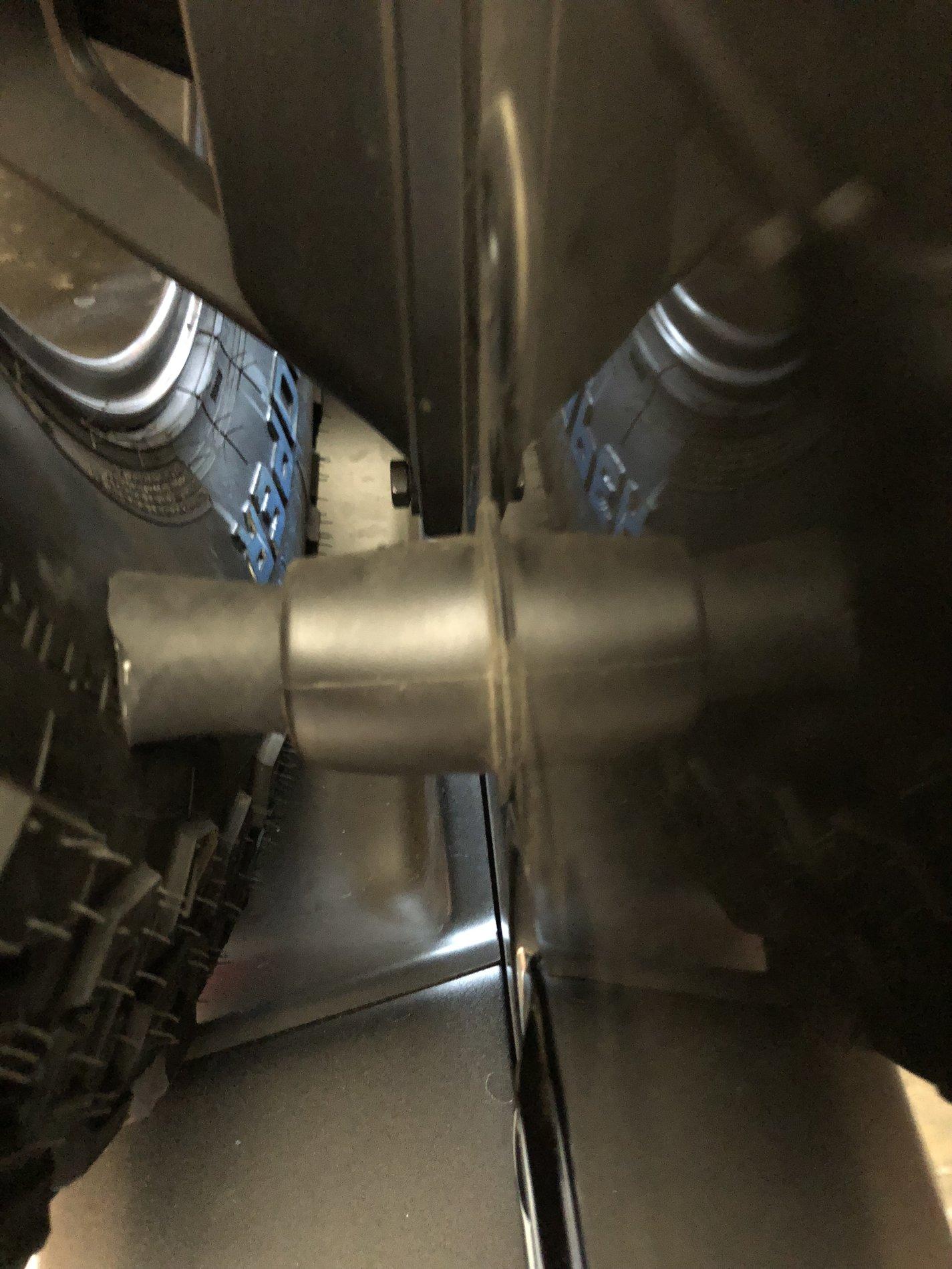

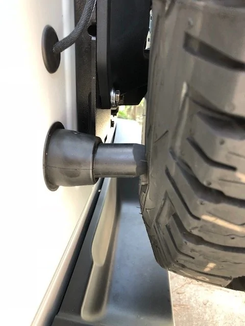

I didn't see this thread before needing to come up with a quick solution. Here is another option and what I did. It fit perfectly and also customizable to cut to desired length. All that is lacking is the need to paint black. The tubing fits around the bump stop cone and on top of the rubber lip. It does not come in contact with the paint.

I didn't want this to be shiny so I just used leftover black plastidip
Perfect, just what I was looking to know. My tailgate reinforcement arrives tomorrow and want to have everything ready to put on.

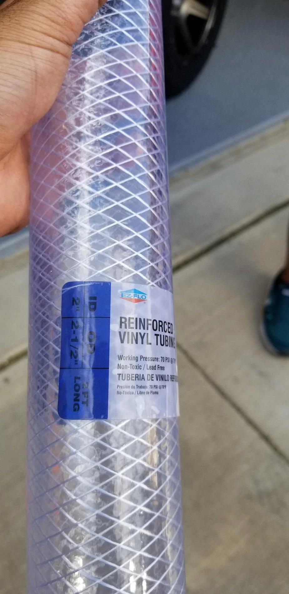

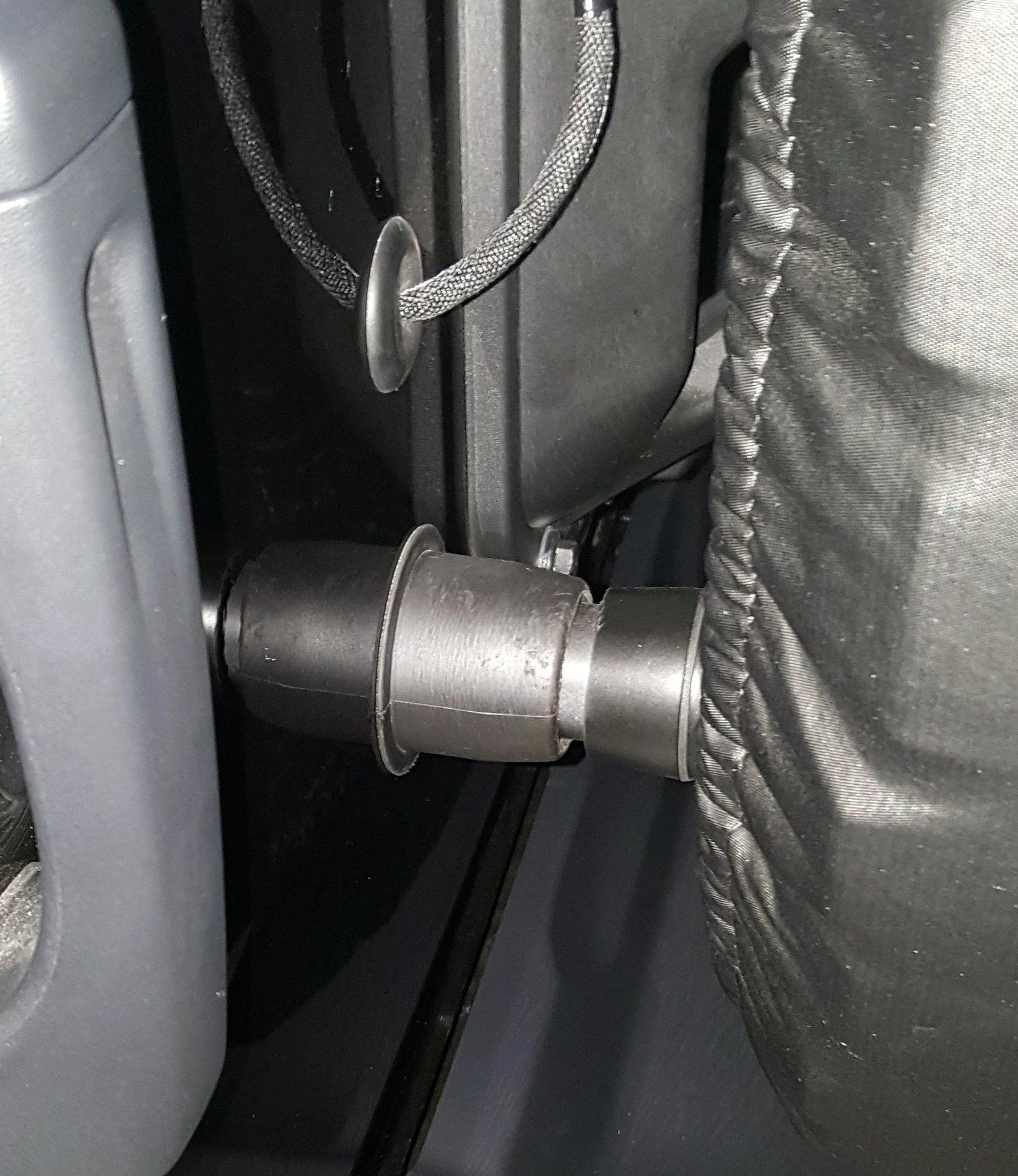

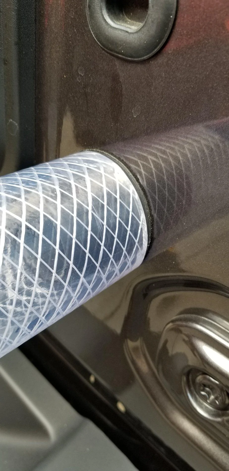

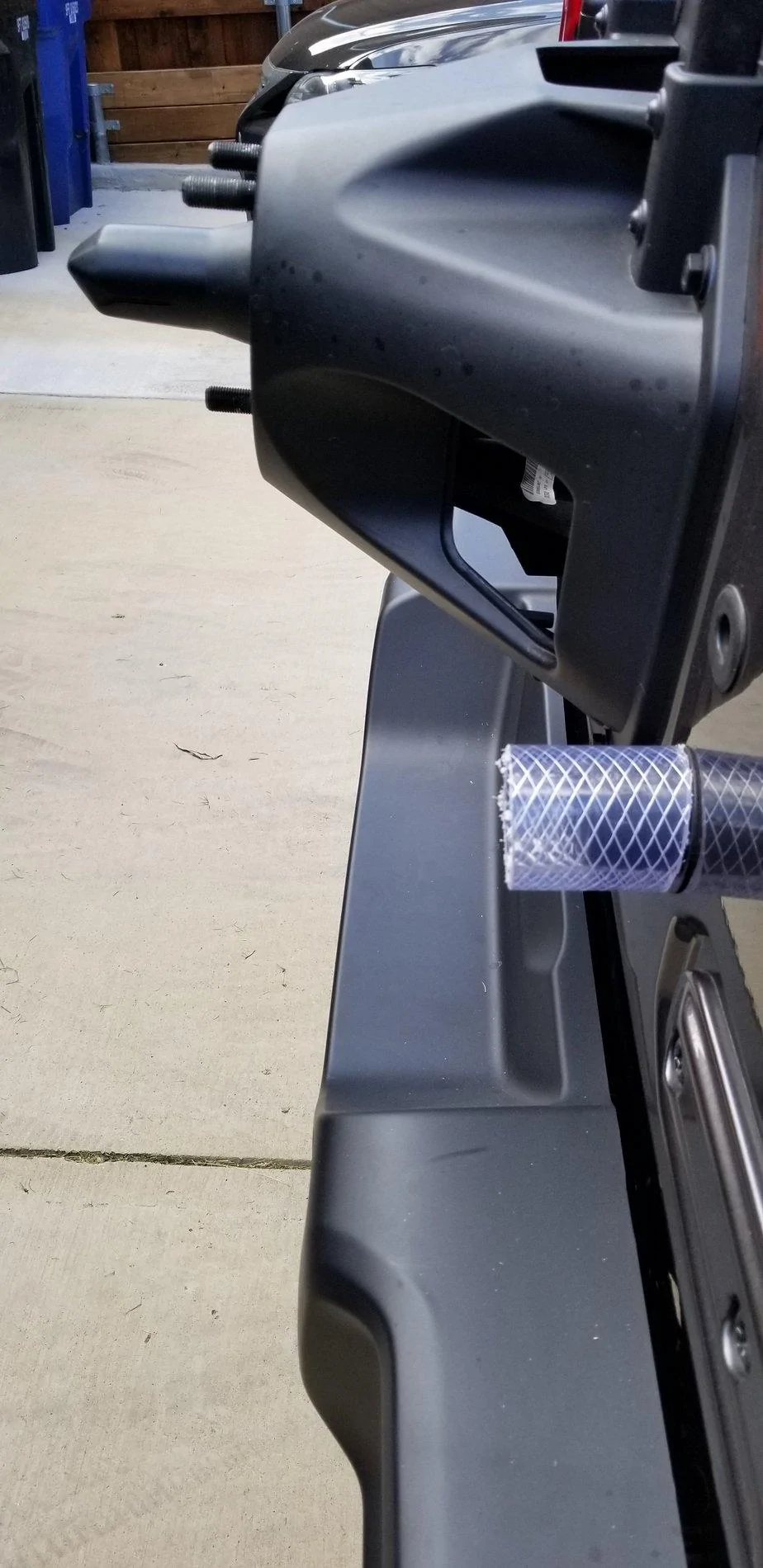

Mopar is now selling the bumpstops which look nice without the whole riser kit for the spare but they want 160 each:cwl::cwl: . I got the dishwasher hose and a stinger for added protection. I will get a bumper/spare option down the road when more options are available.

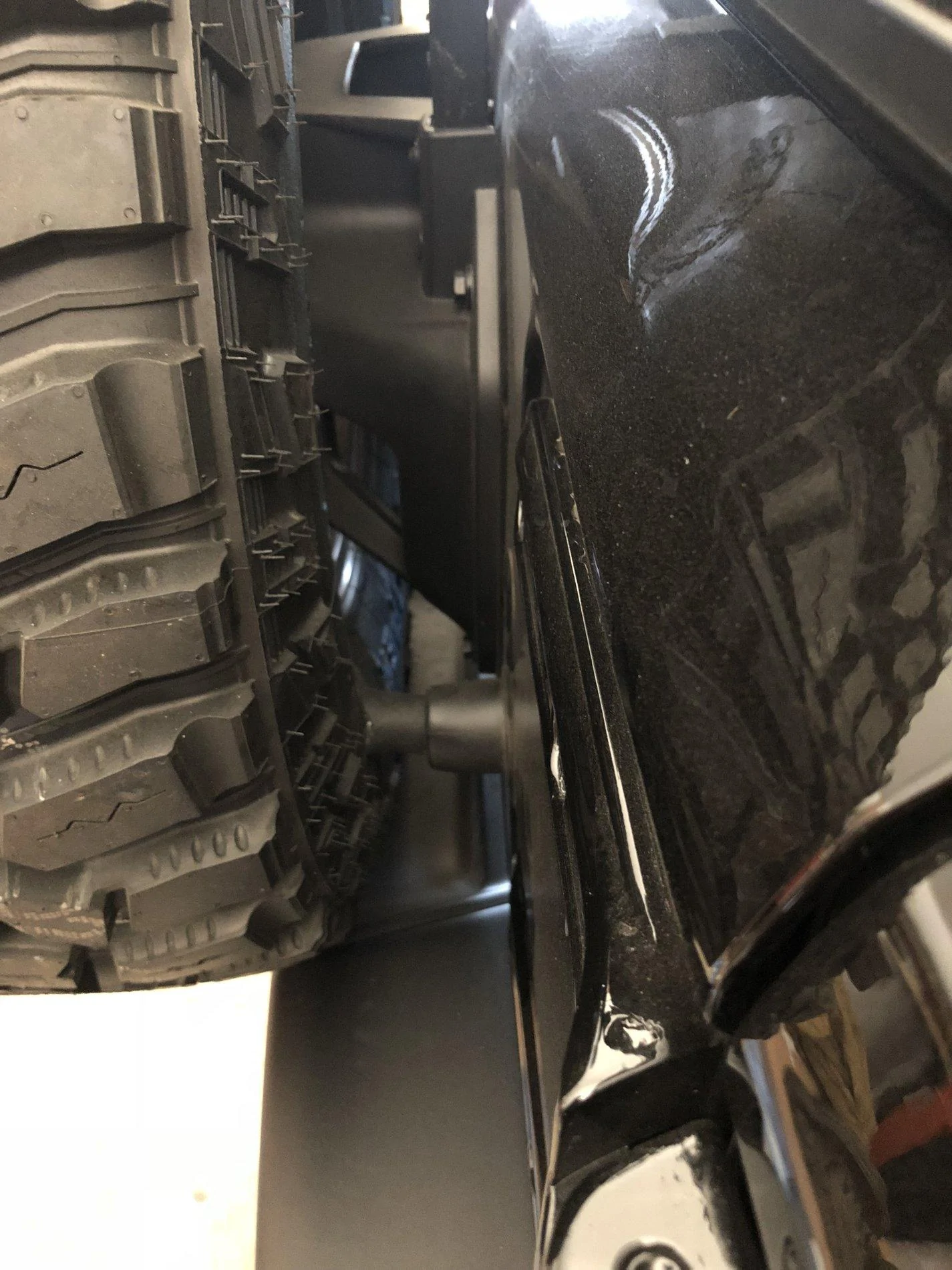

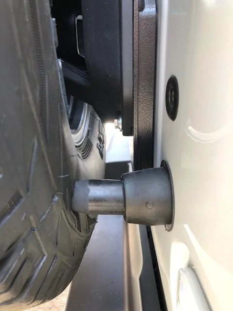

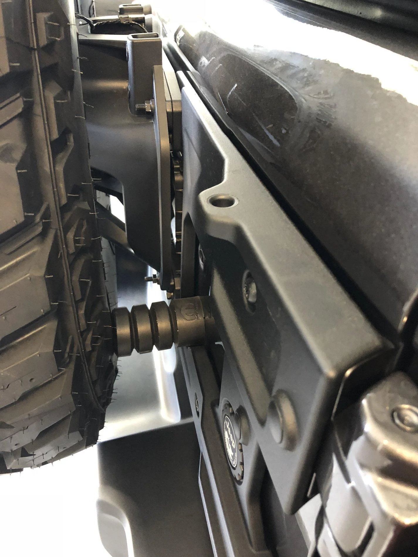

Here is my Macgyver attempt. Worked out pretty well. Bought the extensions off ebay, measured, cut them, glued them into the OEM bump stops, and put the spare back on tightly. $26 bucks in total. I have the Rough Country relocation kit and 35's.

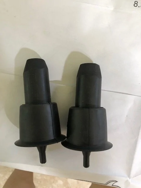

I copied FatBoy01 and picked up a couple of the rubber feet. Then used a few inches of scrap PVC I had laying around (which I painted black). Turned out nice and it's solid enough to do the job. Thanks to all for sharing your ideas and solutions.

@McBeevee
Look very good. And it cost you under $4.00 probably. No need at all to spend $20+.
