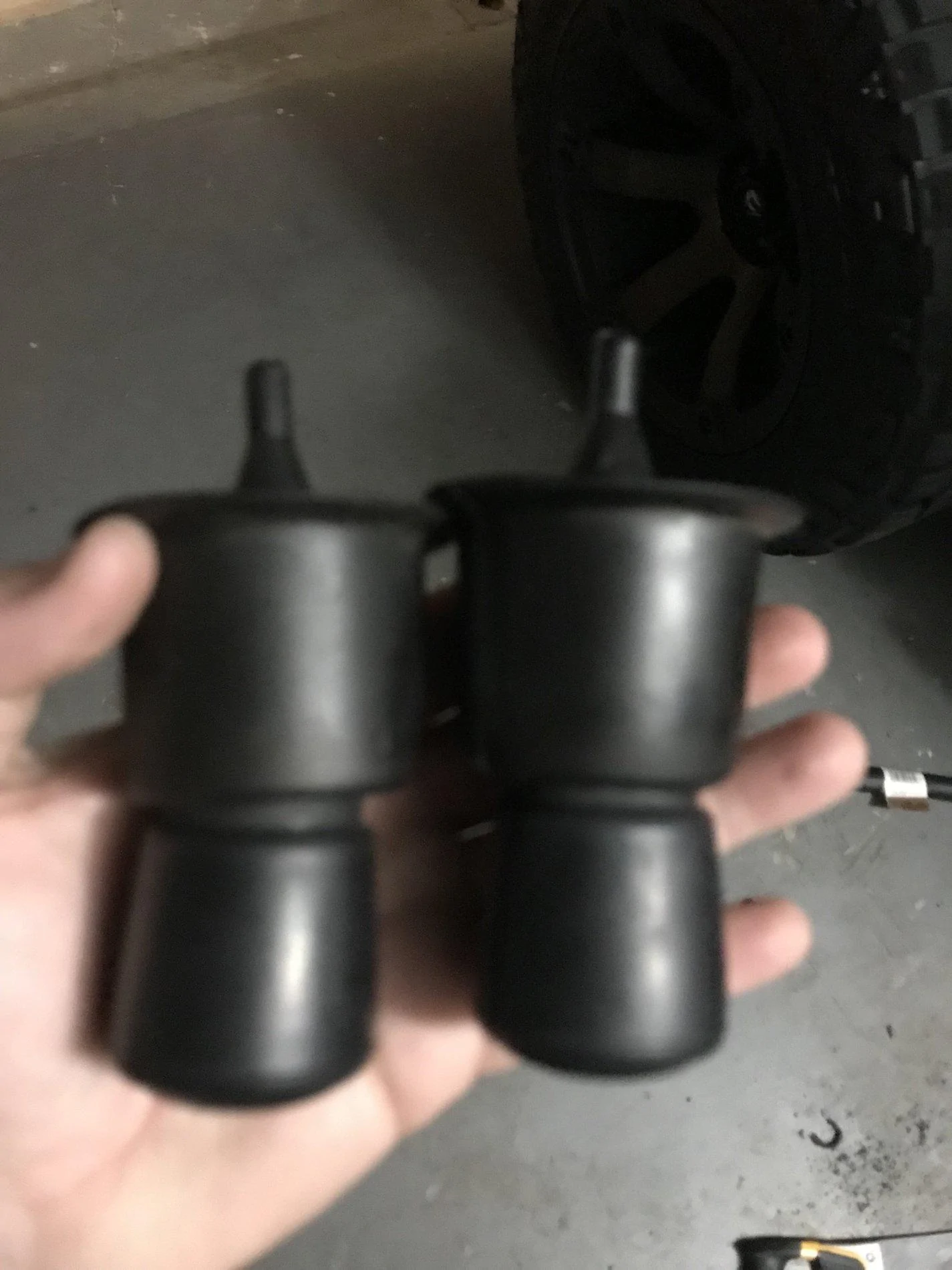

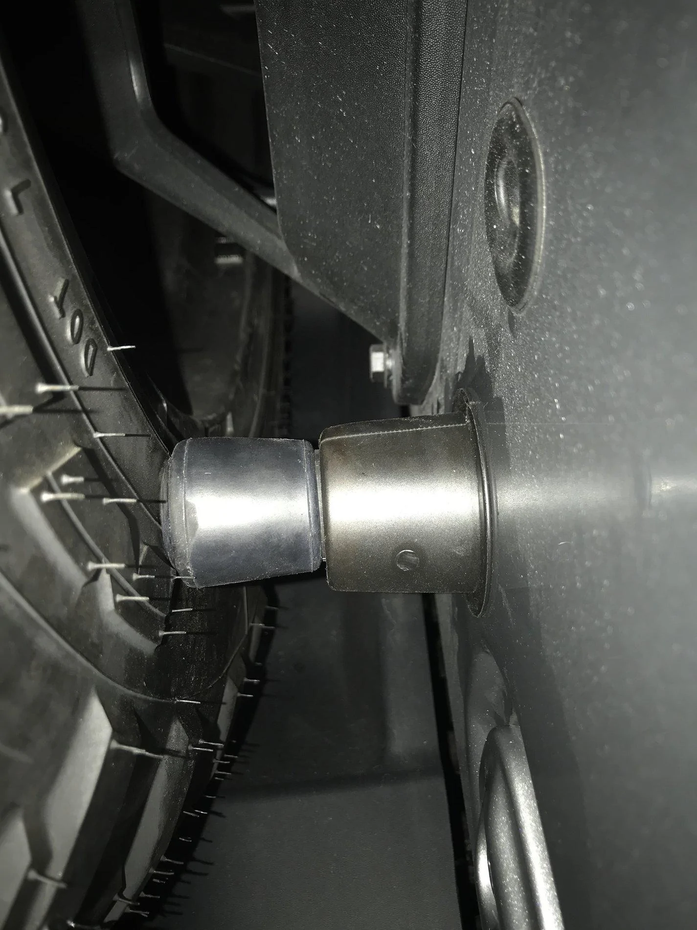

$8 at Lowe’s, now to the next problem LoL

This has worked so far but looking for a more permanent fix. Glad I found this thread.
This, is awesome. Nice job. Best one yet. Lol
