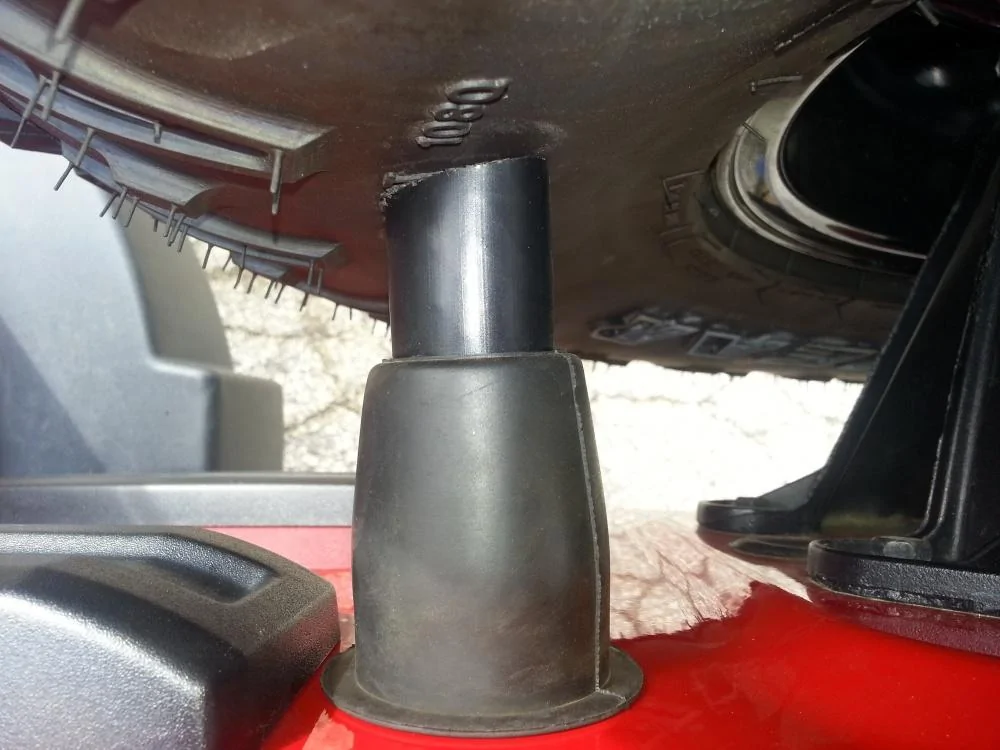

    @dajuicejml ... Yup. I have your solution. I have dealt with this issue a few times. Most recently with my youngest Son's, JK.
    You will do damage to your JLU if you don't get this issue taken care of!
    Anyway, go to The Home Depot, Lowes, hardware store and buy one black rubber tip or some people call them stool feet. See pic below.
    Also, buy yourself a length of 1 1/4" PVC pipe. Or a 6" in length+-, PVC pipe fitting The PVC pipe diameter has to be close to the same diameter as the hole in the stool foot.
    Anyway, you cut the PVC pipe to the desired length and that piece (it will probably be say 3-4" in length) will plug right into / forcefully push right into, the factory JL tailgate bumperette (the bumperette has a hole in it) that was for the original spare.. Now, on the other end of the piece of PVC pipe you push on your black rubber stool foot. Don't glue things together.... there is no need to.
    You'll have to play around with the length of the PVC piece until til you get it just right. You want the PVC piece to be long enough so that when you tighten down on the spare that the the spacer you just made up is nice and tight between bumper and tire. You want no movement. You want that spare to forcefully push against your spacer setup as you tighten the spares lugs.
    That's it! Solution will cost you say $3.00+-. By the way, if you have an old cannister vacuum cleaner you can cut a few inches off the rigid tubing that hooks to the flexible hose. It works well..
    By the way, you will be surprised how decent the thing ends up looking and it does do the job.

    Below is a pic of what I was talking about. The pic is the stock/factory bumperette with a piece of PVC stuck into it. You then take a stool foot and put it over the end of the PVC so the PVC pipe end does not marr the tire. What's nice about this approach is that it is so adjustable. Just alter the length of the 1 1/4" diameter PVC pipe/plastic pipe you used. My suggested way costs about $2-3 and again very adjustable.

    Looks like this, but the pvc piece,(cut to desired length) in the picture does not have the have the black rubber tip on it. Without rubber tip you risk marring of spare.. plus the black rubber tip hides the pvc.
    Again, length of stop completely adjustable. Costs $3.00....

    I went and bought the supplies and did this tonight. Seems to work well. I went with plastic plugs rather than the stool style cap, but same approach. Thanks fat boy.
