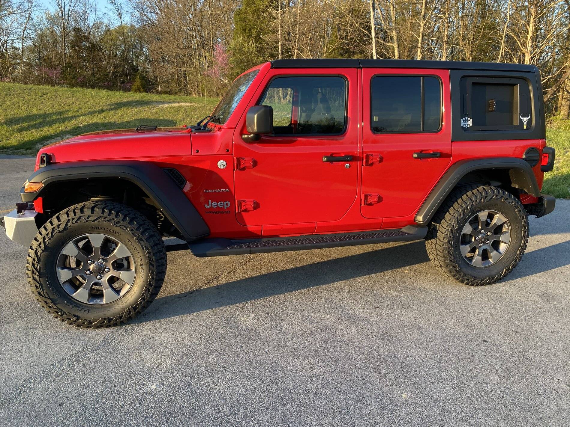

Here is where mine is now in the pic. I put a level in a few spots like the bottom window channels and the side steps and they all show the rear BARELY higher than the front and it appears that way at best. Well, we’re going to be loading it up this Summer and I need that factory rake back. I have 3/4” spacers all around right now. You can see the weight on the front. The only other non-factory weight is a pair of recovery boards, the couple pounds heavier aluminum blackout kit to replace the rear glass, a FAK, 98 lbs of spare(26lb gain from the tire), and about 8 lbs of Mopar tailgate reinforcement.
If I’m level now and these Synergy springs I ordered say they are 1” taller than the stiffest Rubicon springs, I should at least be good for that I’d think.
Suspension now: I have 61/62’s up front and the 90/91 numbers in the rear from a HT, tow, steel bumper Rubicon… so middle of the road out back.

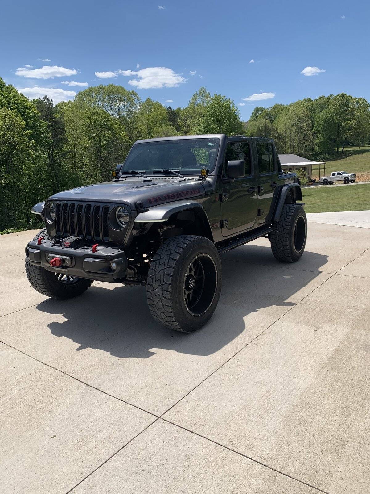

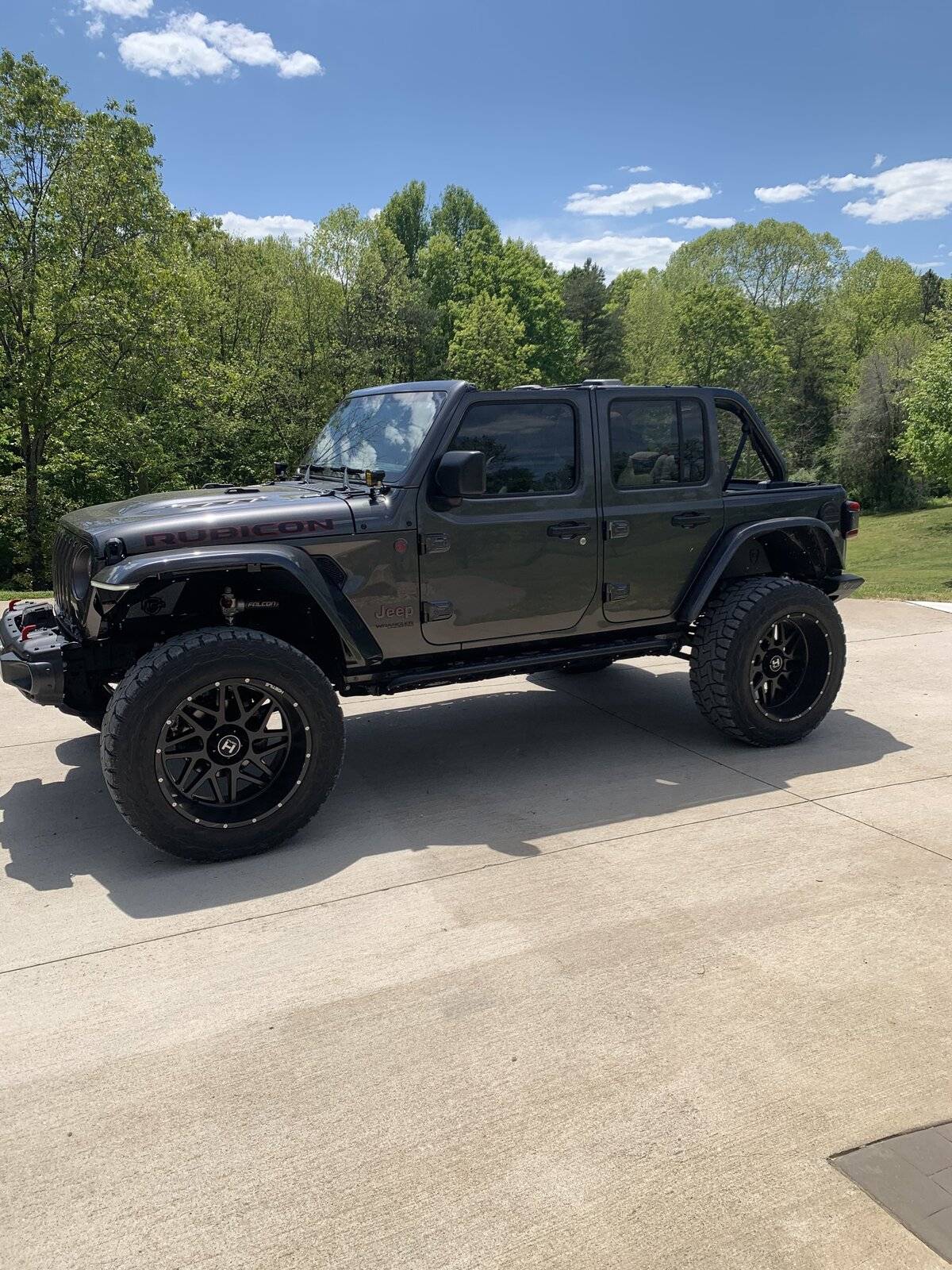

Synergy 3” springs w/37s. Thinking of adding a .5” spacer on the front? There’s some slight rake after settling.
