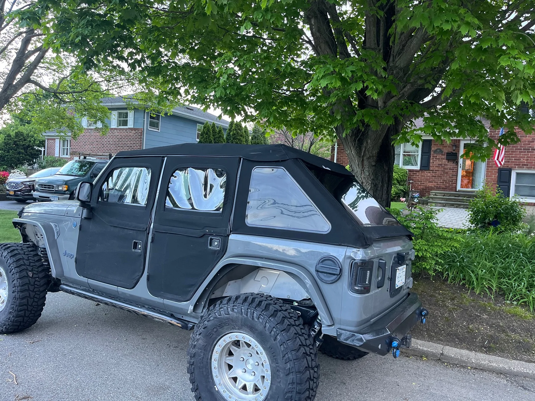

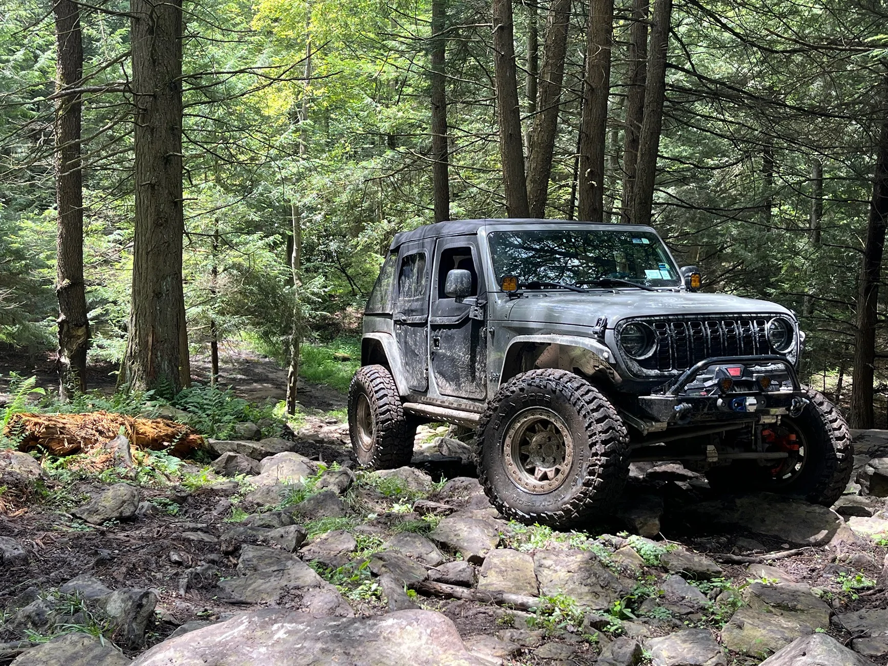

I have been using the 3 inch springs for 4 years on my 4 door with 37s. Great combo very pleased

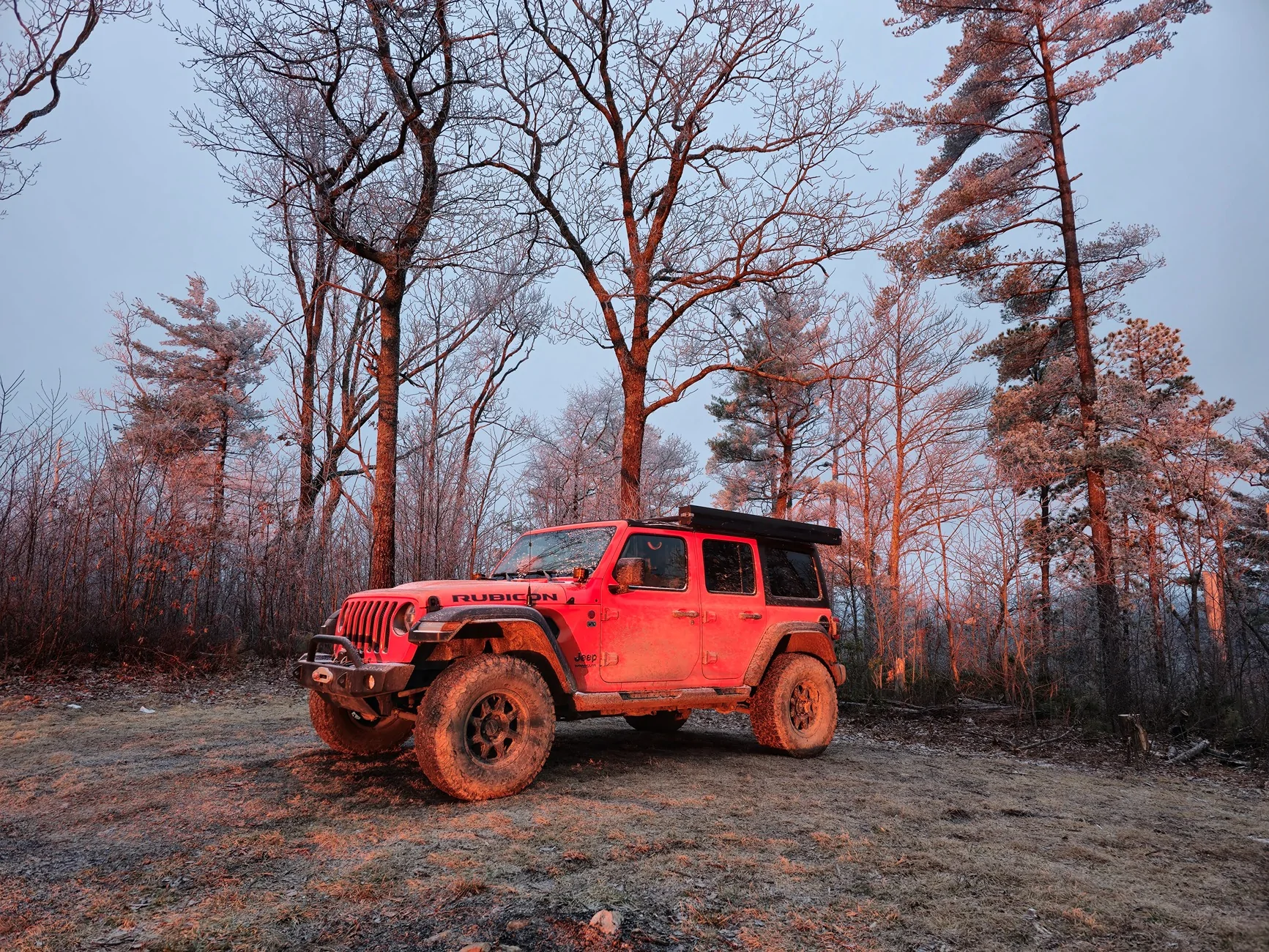

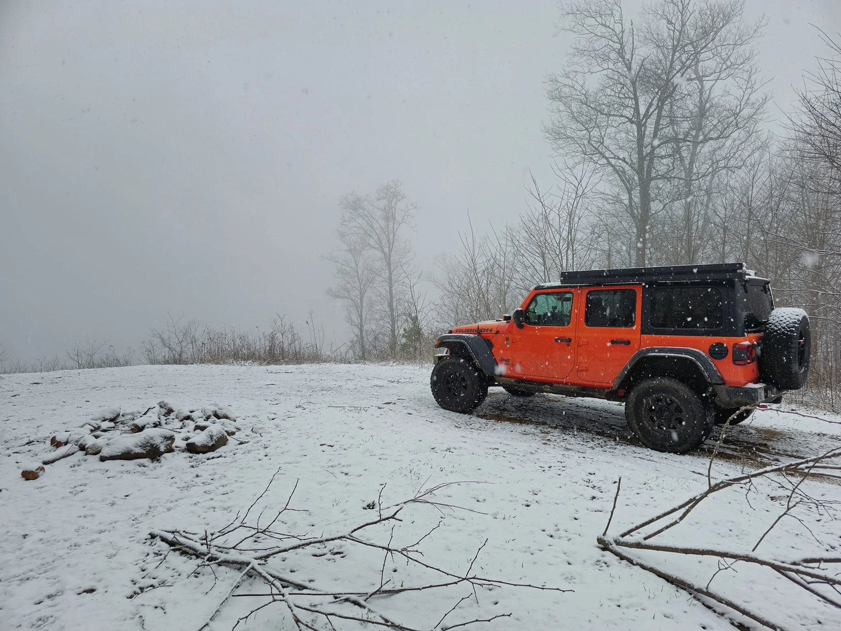

I have been running Synergy springs since day one on my 2018
I started with 2in springs and have recently replaced them, after 6ish years, with Synergy 3in springs (ex. https://www.northridge4x4.com/part/...front-coil-springs-jl-2dr-4in-jl-4dr-3in-lift) with leveling pucks in the rear to have a level ride when it's loaded down with gear.
I live the ride and it leaves plenty of room for my 35s. I could easily run 37s as well, but I like a smaller/lower build.
I have always gotten complements on the ride, and I've found no issues with it even after multiple 18+ hrs drives out west (from FL).
I find they give almost the exact amount of lift as advertised and don't settle as much over time as other springs I've had on other vehicles in the past.
