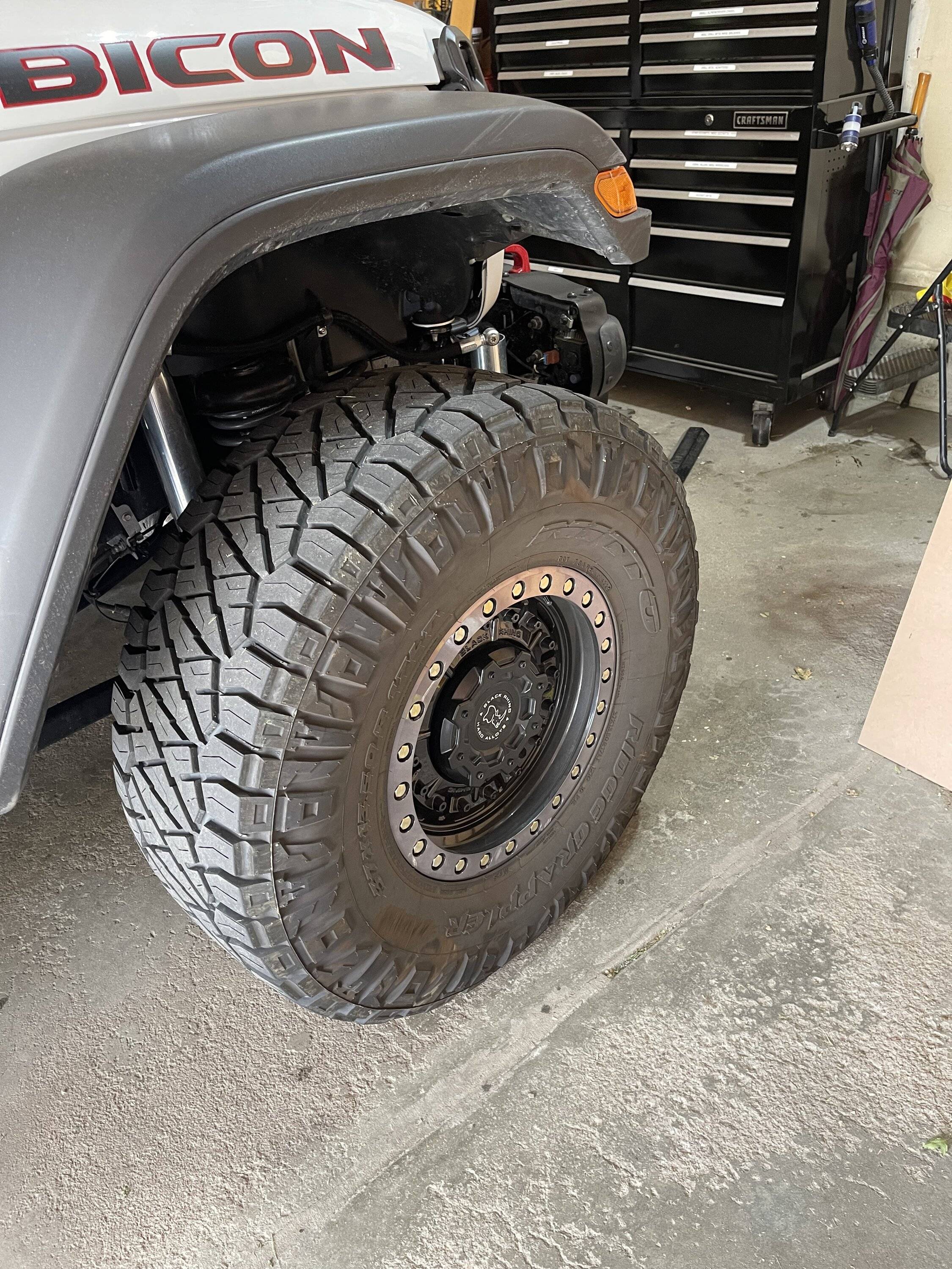

Interesting. I have 37x13.5 Nitto Ridge Grapplers with Black Rhino 22lb rims for a total weight of 118 lbs per wheel/tire. I also have steel, bumpers, a heavy duty spare tire carrier, door hinge steps, and a 12K lb winch, so my JLU is pretty heavy. I get into 7 & 8th gear easily and get 21+ MPG at 65 on the highway, about 17 mpg at 75-80 mpg, and 15-16 around town. And I have a lead foot. I did adjust the tire size with my Taser, but I still have 4.11 gears. 2L turbo using premium gas
