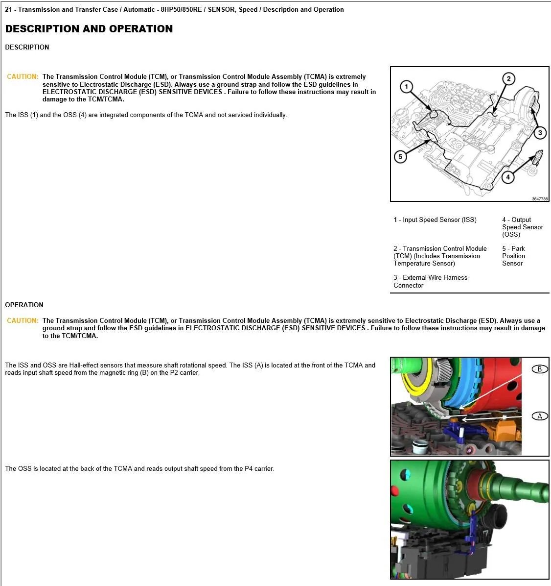

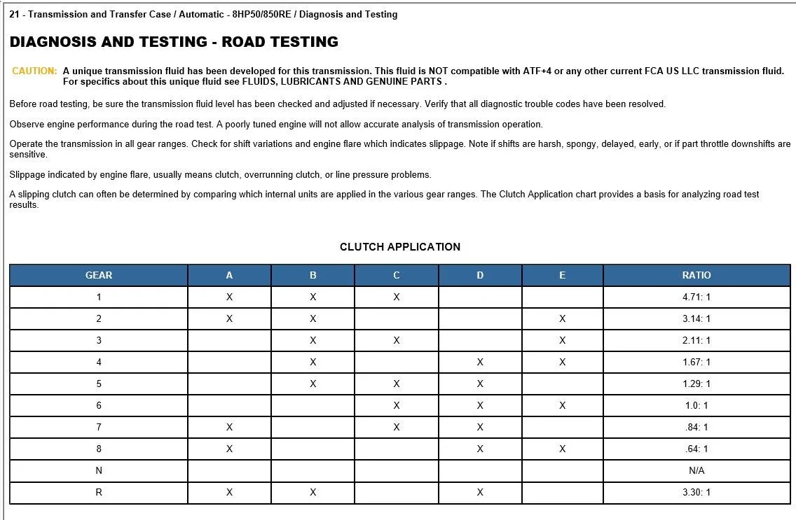

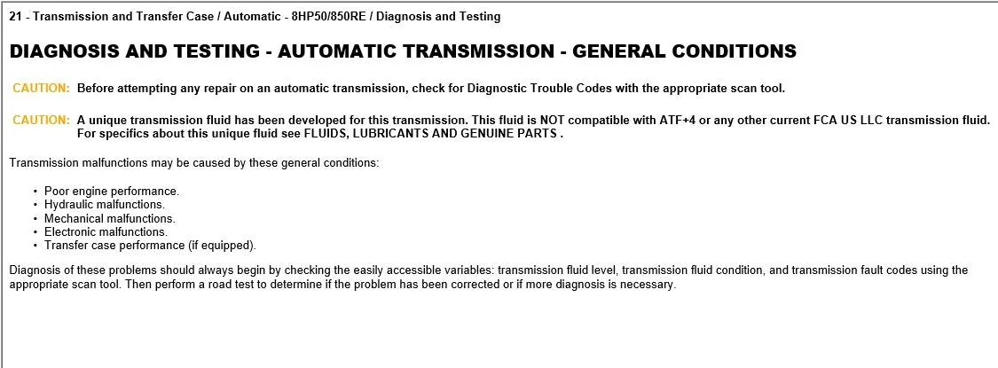

Don,
Here's the first page out of the manual and a couple more for transmission diagnosis. This is about all I could find in the mopar manual that is external diagnostics.
Jeep Wrangler JL Suffer poor MPG??? trans diag
Jeep Wrangler JL Suffer poor MPG??? trans diag 1
Jeep Wrangler JL Suffer poor MPG??? Trans speed sens

Don,
