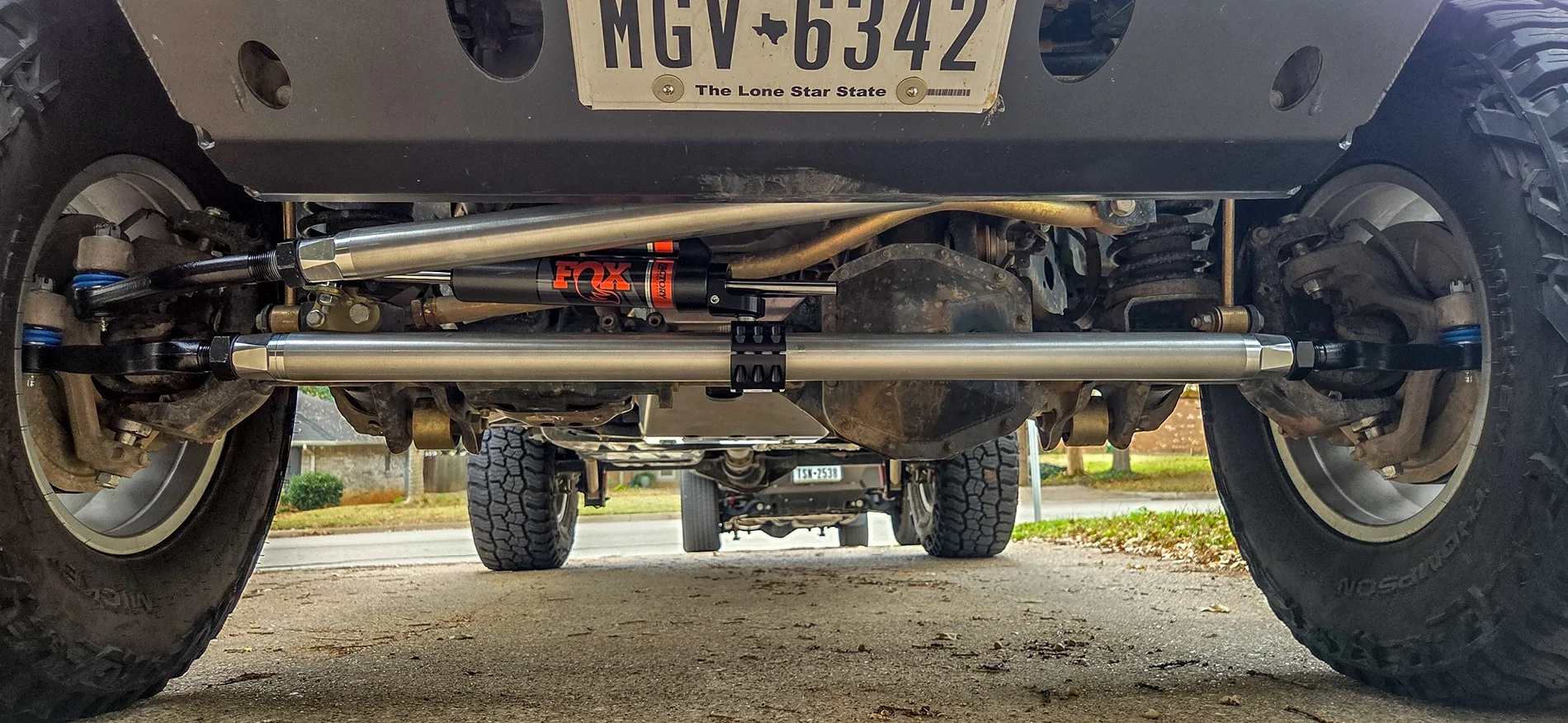

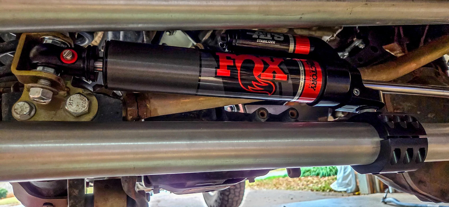

I put the Metalcloak Rock Sport Red SS with the relocation bracket on the Jeep about 10 months ago. Seemed to always push to the driver side. Didn't love it.
When I upgraded to the CavFab 2.5 ton steering this year, I went with the JK version of the Fox ATS 2.0 stabilizer. Installed it using the Metalcloak relocation bracket. Running it three clicks clockwise from stock and love it.
Jeep Wrangler JL Steering stabilizer struggles 20251213_102953
(yes, I know the nut is loose in this picture. this was during install.)
