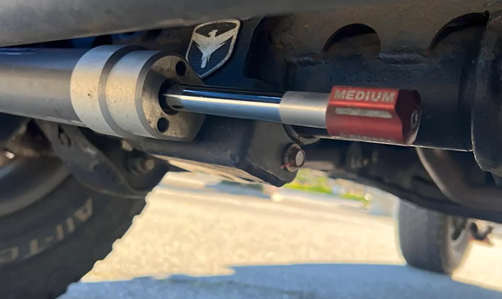

Metalcloak Rocksport red steering stabilizer relocation kit. Bought for under $200 on sale 2 years ago. I have other Jeep things I’d rather spend my money on than bougee steering stabilizers. No mall cred but it works just fine.
I was looking at Metalcloaks HD steering system and it said the stabilizer relocation required at least 2” of bump stop to clear the frame. I take it that the relocation works just fine on an XR Rubi with the factory lift?
It worked for me with the stock XR suspension.

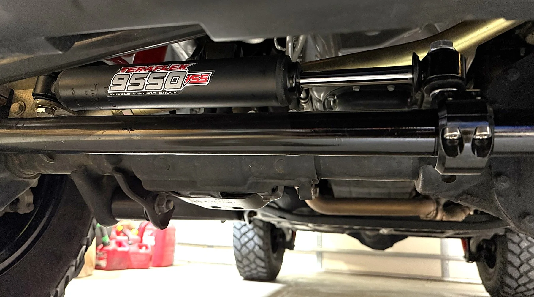

I installed the AEV/Bilstein SS with a relocation bracket and drove it for a couple of years. I didn't like the way it pushed in one direction because of it's gas charge. I swapped it out with the TeraFlex 9550 SS which isn't charged and I like the results. Much firmer than the OEM Mopar SS and a lot cheaper over the Fox and other through shaft SSs. So far I like the control and function of the TeraFlex.
Jeep Wrangler JL Steering stabilizer struggles 9550 vss
