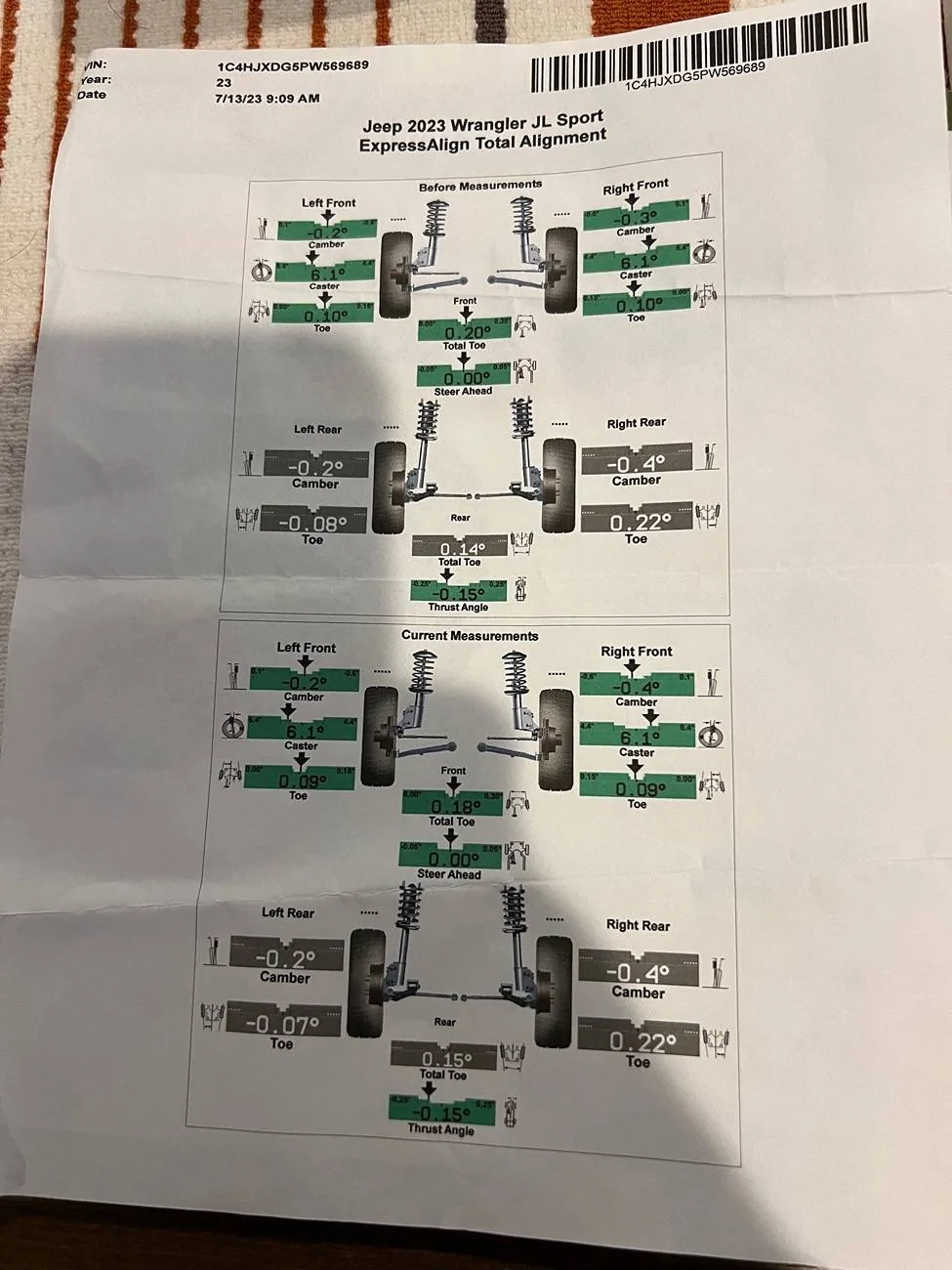

Here’s that printout. I hope someone sees room for improvement.
Those number are fine. That's not your issue.
What trackbar do you have? How old are the trackbar bushings? What balljoints? How many miles on those balljoints? These two components are very high on the list of culprits that can cause loose steering. A JLU is a long enough wheelbase that the factory spec caster works pretty well when the steering components are tight. When it's right, your steering can allow you can cruise down the hwy at 75-80 mph with 2 fingers and barely moving the wheel.
Stock everything; track bar, ball joints etc.
