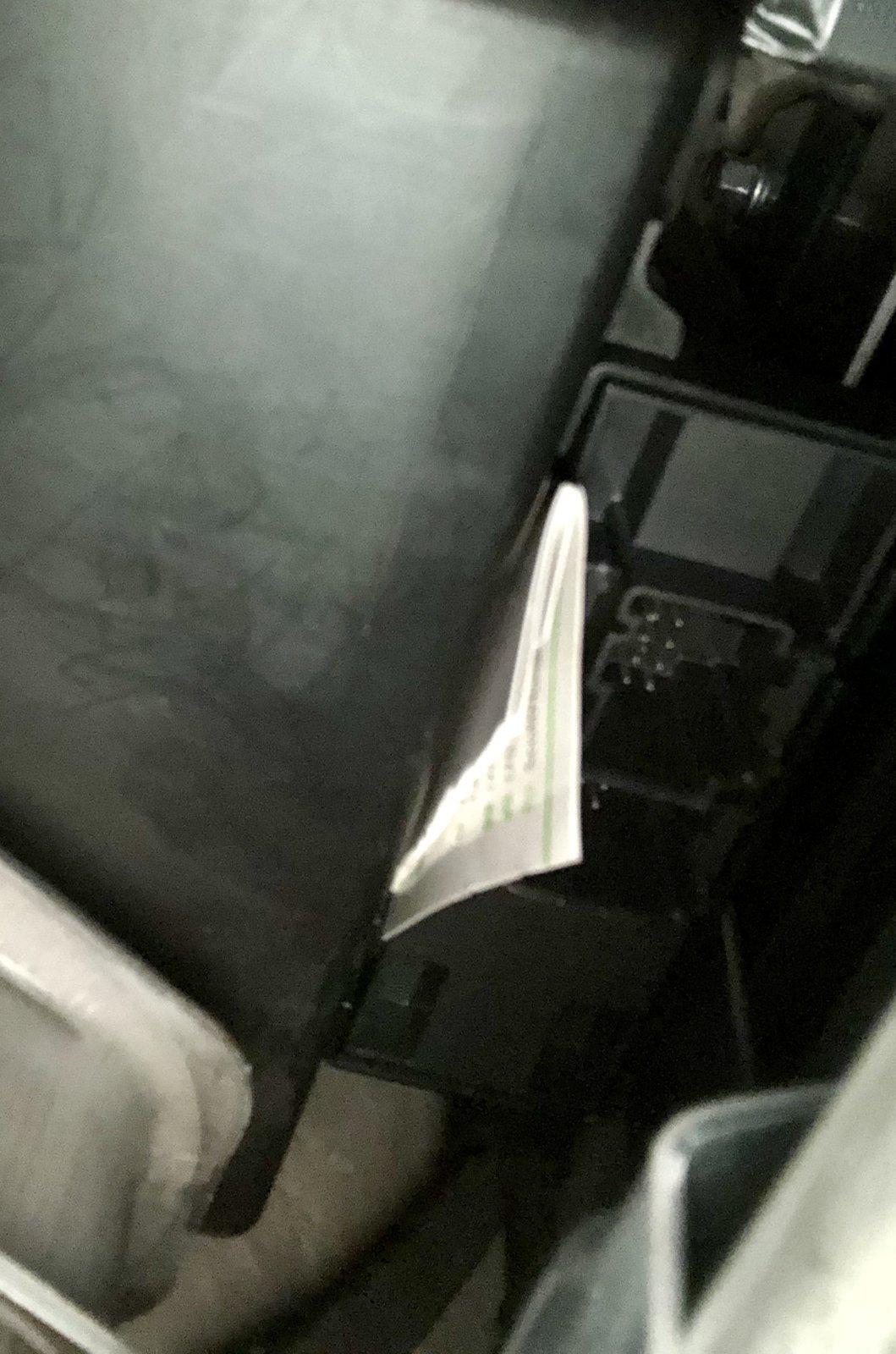

I fixed mine by wedging a folded business card into the SGW module between the female connector and housing... no more Charlie Brown.
Thanks, I tried exactly this and it worked for me!!!:like:
