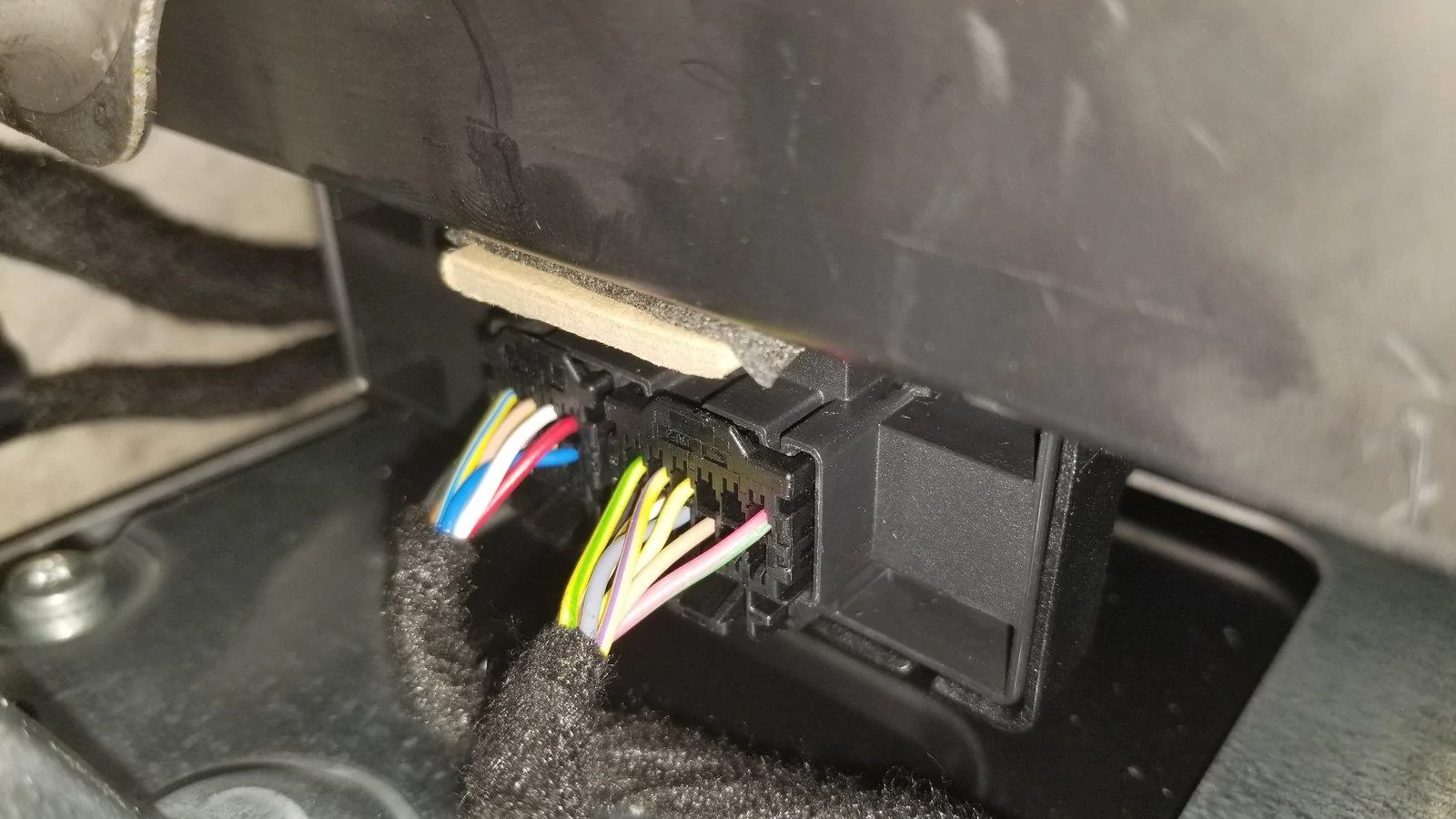

Jeep Wrangler JL Speaker issue? 103514
I just used a cardboard wedge wrapped with foam sound barrier. While I had the dash off I took the speaker out and checked the wires. They are all cloth wrapped so it's not from inside. I added a bit of fiber fill for good measure.
The business card may not provide enough "padding." Try something like this instead and see if it works better for you. You can use window sealing tape and it's cheap at the local hardware store. Plus the foam tape can be used in other places to keep things from rattling.
:beer:
