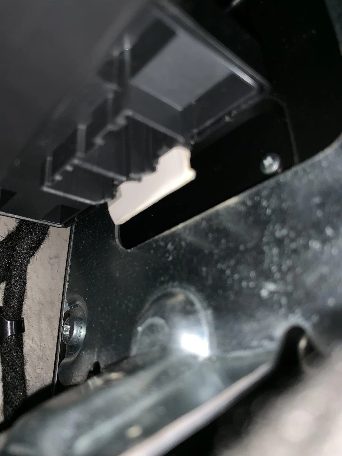

Some pictures to help you guys understand the business card fix (way easier than rubber washers - can’t see how you’d do that without taking the dash apart).
I used a long, very skinny flathead to make enough room to slide in a little square of cardboard. Rather than a business card, I used some cardboard from Harbor Freight glove packaging - thicker and harder (that’s what she said!)
I never had the speaker issue, but I do have a very annoying (to me) vibration sound that I swear is coming from behind the vent or from inside the a-pillar. You guys got me wondering if it is the SG module rattling, so I figured a bit of contortion and some cardboard was worth trying. I haven’t gone out to test, yet. Fingers crossed!
