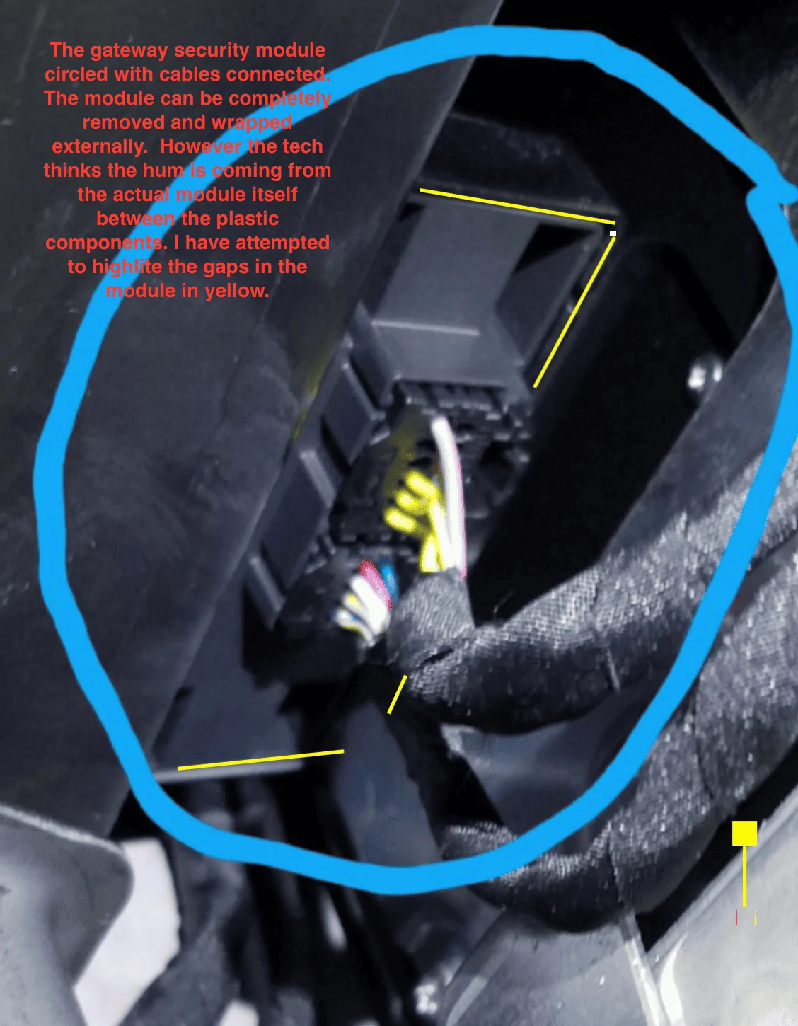

I am at the dealership at this very moment - working with a young tech who hates to lose. He had an app on his phone that just plays tones at different frequencies (don't ask me why he has that app) and he used it to isolate the "hum" to the gateway module and has removed it completely... my interior is in a million parts now. The tech is applying padding around the outside of the module, but he thinks the hum is internal to the module between the plastic components (I will try to post a pic). So far, it looks and sounds encouraging... but not sure if it's something an owner will want to risk.

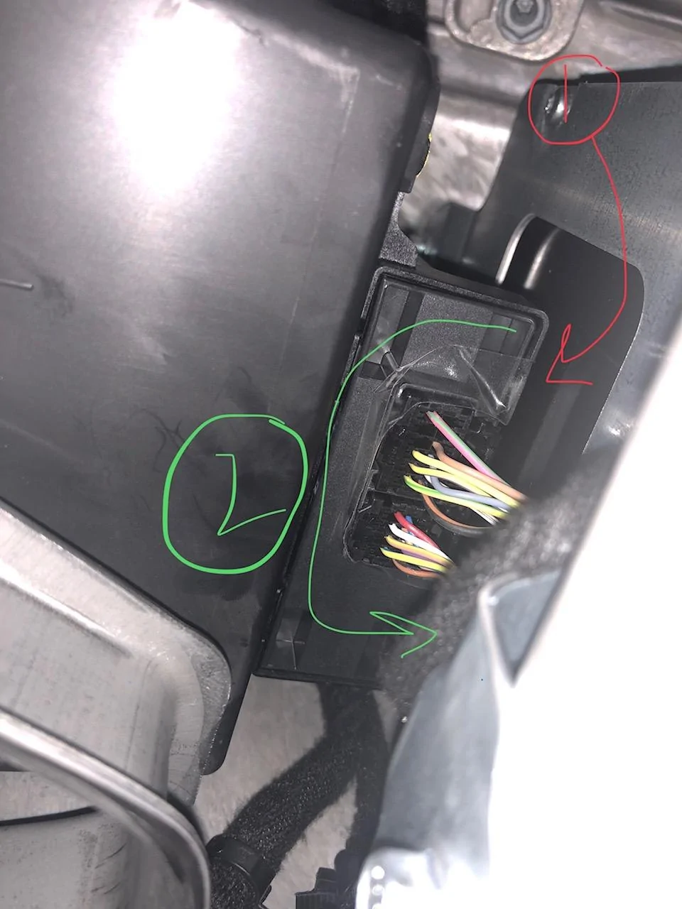

I didn't remove anything. I have attached a markup to hopefully help. Basically, I started by sticking the tape to the outside of the gateway module housing (1) by sliding my finger between module housing and that silver metal cutout. Once I stuck the tape to the outside, then I pulled it taut as I made that 'U' shape over the connectors (2). Finally, I taped it down to the outside of the module housing on the other side of the connectors just like I did in step 1 (can't see it in this photo because of the fabric wires). Takes ~4-5'' strip of tape.
Edit: electrical tape may be better than scotch tape by providing more pressure if you stretch it as you go (like a bungee strap).
Great thanks for the tips. I just went outside and removed the kick panel so I could actually see a little better. I used my phone flashlight (my headlamp would definitely make it easier so maybe later) and I essentially taped from end to end going across the wires with electrical tape. I'll see if that works/holds.
*Removing the kick panel isn't too hard it's just nerve racking pulling on the tabs to slowly release them but it pops right back into place for all those people wondering how to do it. I started at the bottom left of the panel and just worked my up and across until all tabs were released

Awesome! Let me know if it works for you too. Did you make the 'U' shape? I think this traction with pull to one side (which is why you need to make sure the tape is pulled taut as you go) is what the trick is. Also, I taped the base near the connectors, not the wires directly.
