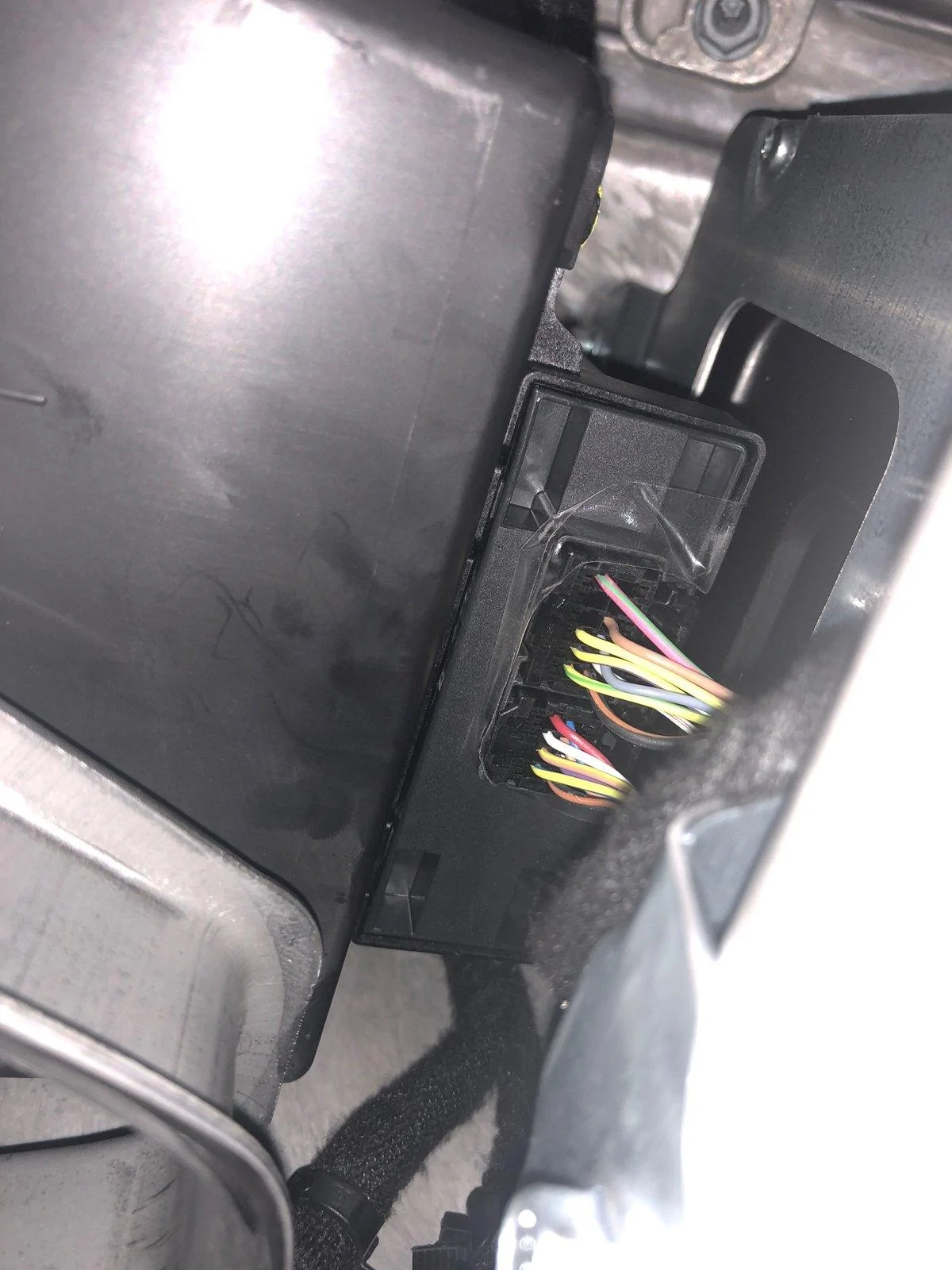

I have the same sounds coming from my Gateway. And like many of you I took my Jeep in and they had it for a Week and they said they ordered a new bottom driver speaker. I have to bring the Jeep back in for them to put the speaker. 6 days go by and I get a text my Jeep is ready to be picked up. As I’m driving away the Charlie brown teacher noise is still there. This is crazy and from this form it looks like this should be a recall or something. My new $56k Jeep should not drive me crazy when I turn on the radio. I have asked Brandon from Jeepinformant to look into this.

I'm not super handy but I was able to fix this in about 5 minutes including panel off/on. Yank the panel under the wheel, took a folded piece of double sided tape, wedged it right between the rattling connector on the gateway module and no more buzz. Pretty sure Rhinebeck was the original fix finder.
ETA
I was wrong, Bearcat and White Butte, page 5. It really takes less time to fix than just checking your car in at the dealer.

Do you have any photos of your fix?

No but look at the White Butte picture with the blue circle on page 5. That’s the target. Took a small folded into a wad piece of thick double sided tape and wedged it in between the connector, wires, and box. Did it just by feel. Probably doesn’t look all too good but dead quiet and buzz free.
I located the problem area, but could not find any areas to wedge double sided tape. This issue is so irritating.

Ok I think I figured out an alternative fix. I took double-sided tape (thanks @Chubrocker ) and started the tape by taping it to the outside of the box, wrapping around the wire connectors with tension, and taping the end to the outside of the box on the other side of the wires (shaped like a 'U' ultimately).
On preliminary results, no more rattle--even on "Magic" by The Cars (which someone here said made the rattle during the whole song). Time will tell--I couldn't listen to Sirius talk radio in my apartment's garage.
Off topic but I think double-sided tape is going to be a good investment given the number of rattles that have popped up recently.

I have had the same issue starting at delivery. I just had a chance to reach under and put some pressure on the gateway module.
Just like that problem is solved, not sure how long it will last. I guess time will tell then I will for a more permanent fix!
