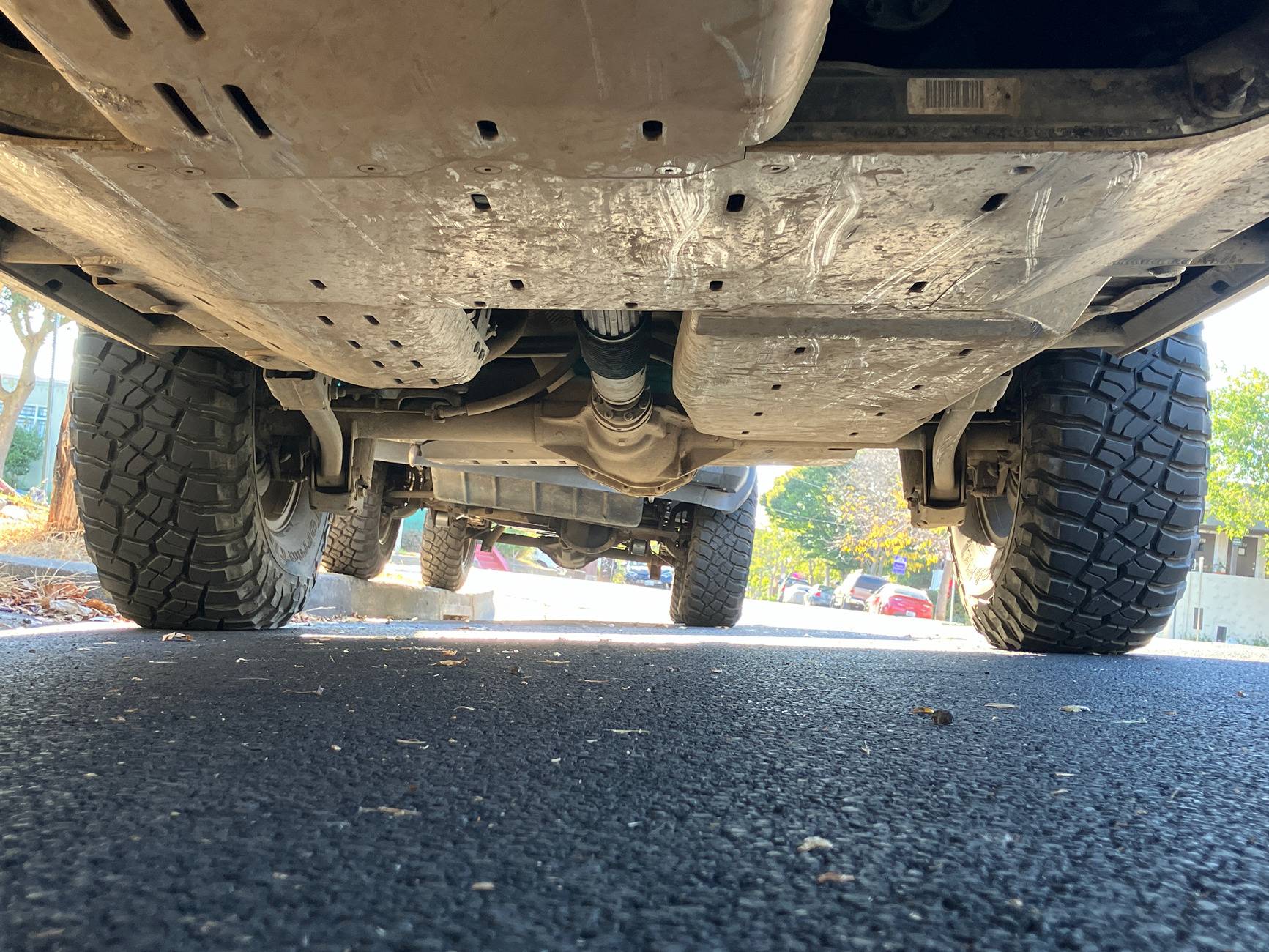

Jeep Wrangler JL Skid plate question IMG_3659
zouch
Sep 17, 2020
39
3,751
3,841
Berkeley, CA
XJ, JLUWD
i’d suggest starting with what’s most vulnerable and/or hangs lowest.
if you haven’t already, relocate the Steering Stabilizer up out of harms way; in stock configuration, it’s a Rock Magnet.
looking underneath, i was shocked at how low the rear Shock/Control Arm Mounts are. there're banged up pretty quickly.
Difs are next; beefier Dif Covers are nice for strengthening the pumpkin and preventing Bad Gear Things, but most of them don’t dissipate heat as well as stock.
figure out what’s important to you and where you want to compromise; you might want a Dif guard that eats a little clearance instead of a heavier/thicker cover.

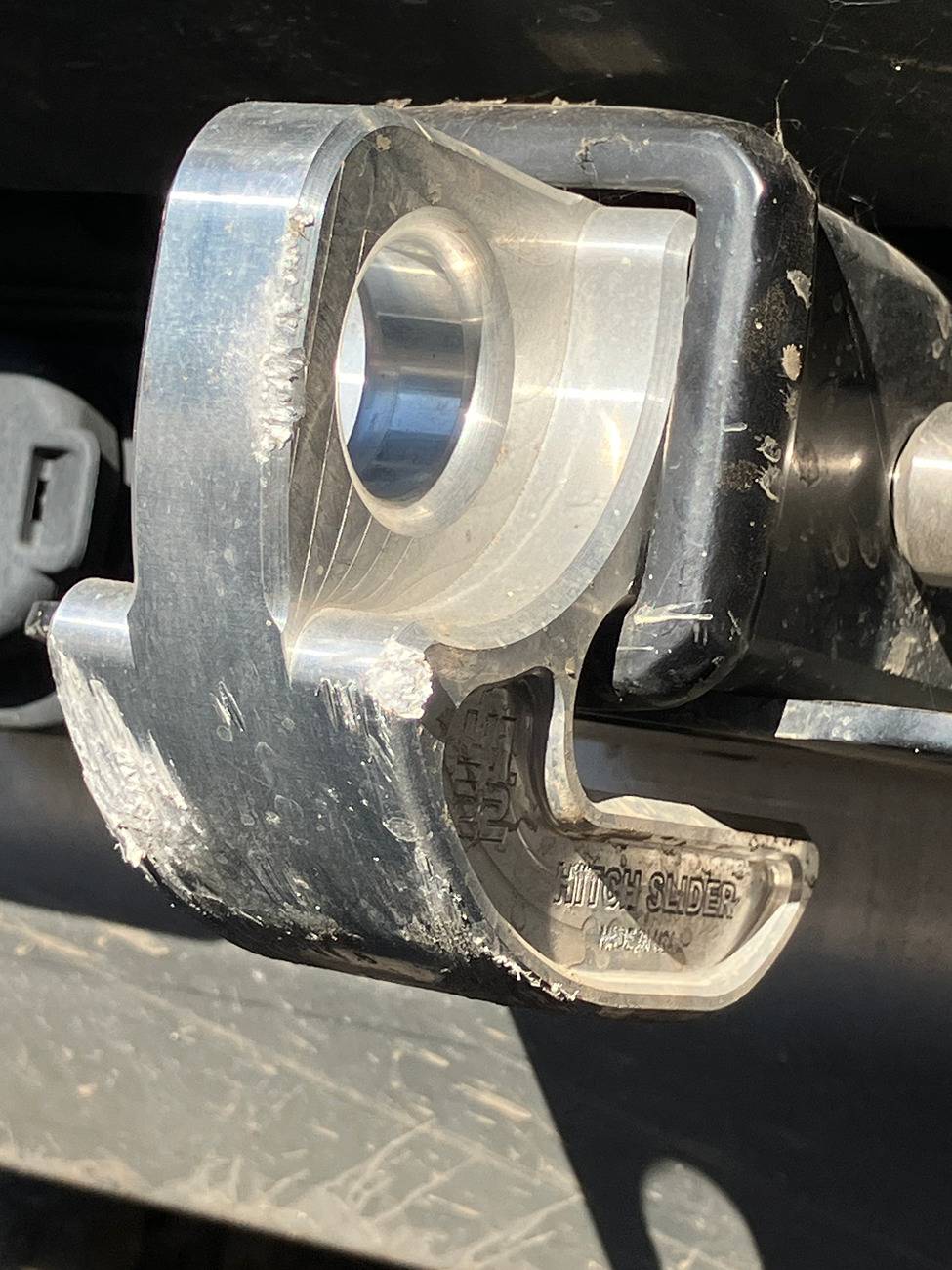

a Hitch Slider might be a good idea too. relatively inexpensive, and provides a good Recovery Point for your Soft Shackles.
@3D duck

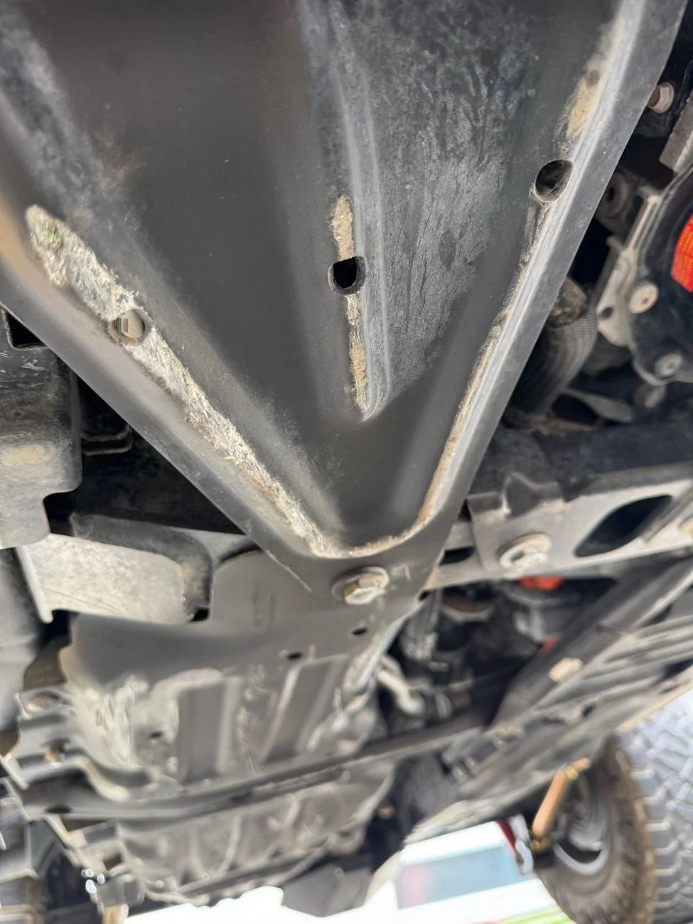

Jeep Wrangler JL Skid plate question IMG_4071
Jeep Wrangler JL Skid plate question IMG_4074
