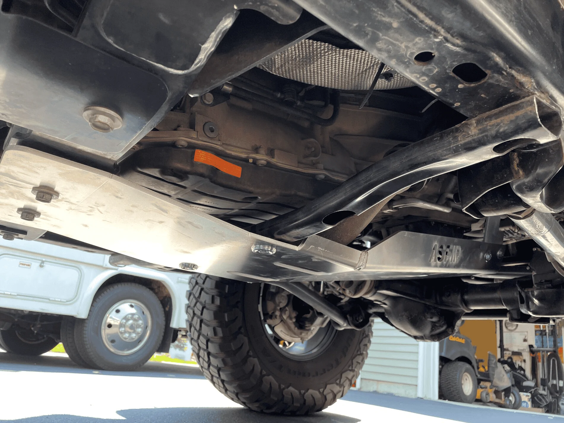

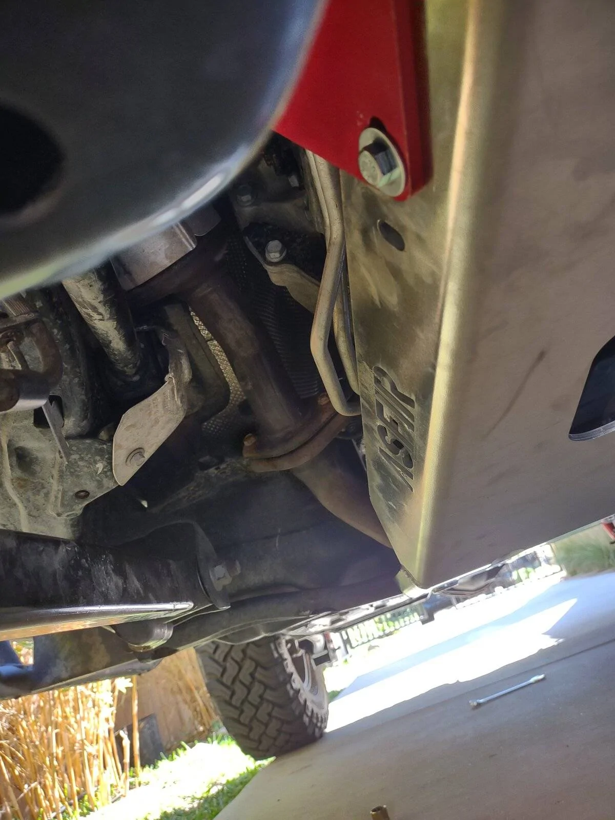

Jeep Wrangler JL Help me decide trans skid plate IMG_20211112_164343073

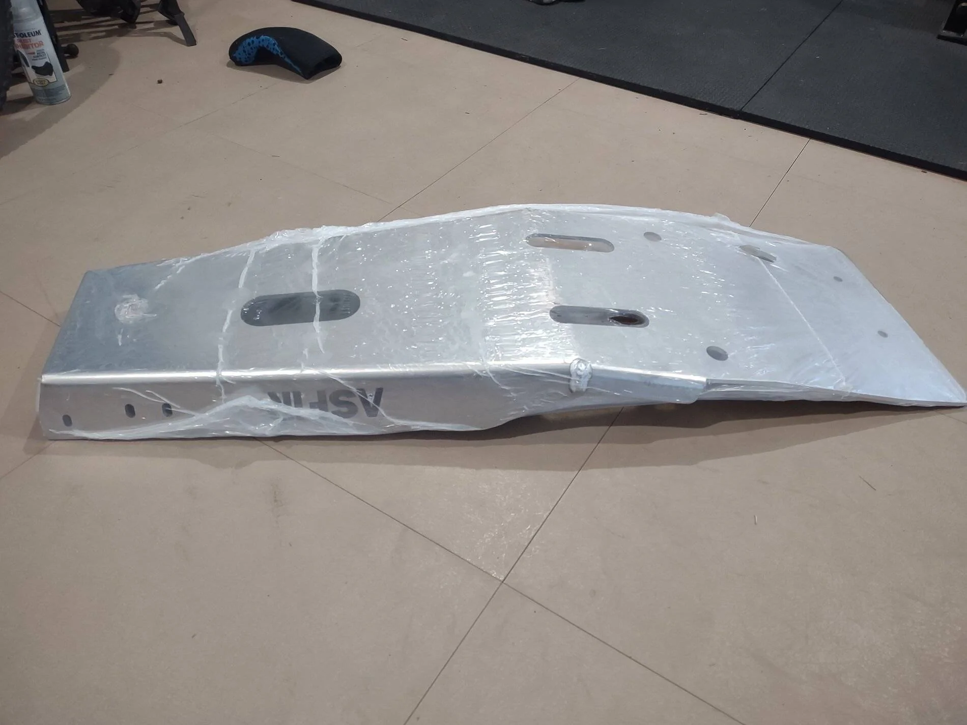

Got here fast!. It is very light. Ill be installing this weekend hopefully. Ill get the front on jackstands maybe itll make it quicker.
blnewt
Brad
Oct 8, 2018
99
9,956
24,091
New Mexico
Just ask @cosine he knows!
Wow, that was fast, crossed an ocean faster than most stuff crosses a state lol.
entropy
entropy
Sep 19, 2018
90
4,747
8,257
Foothills of the San Gabriels
OF top 1% content creator

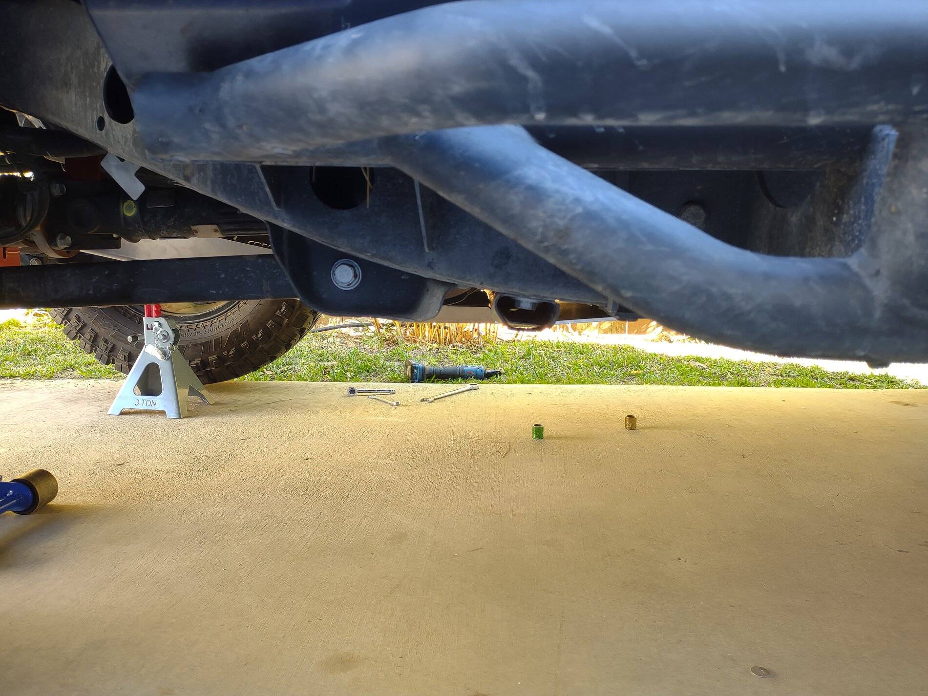

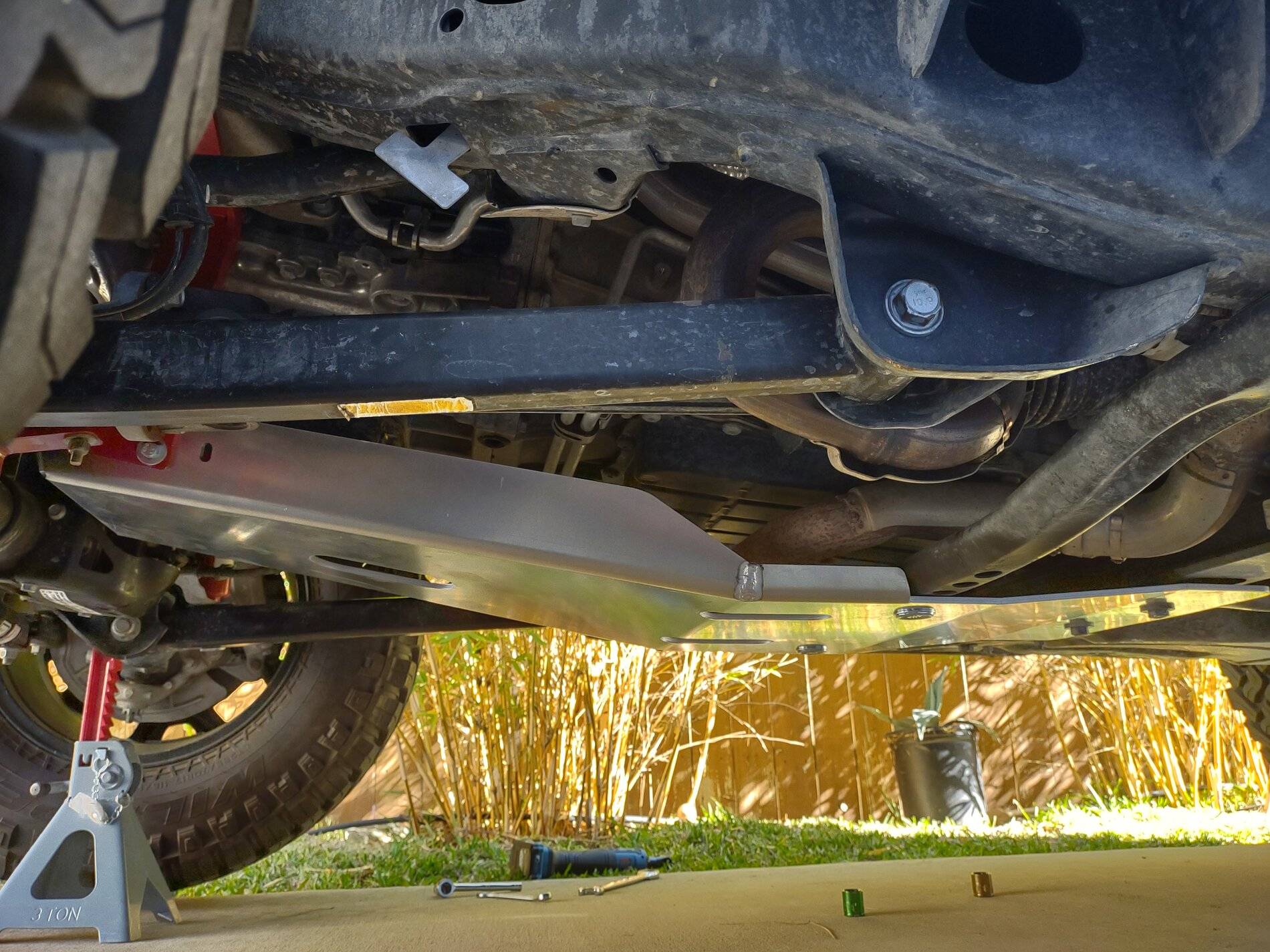

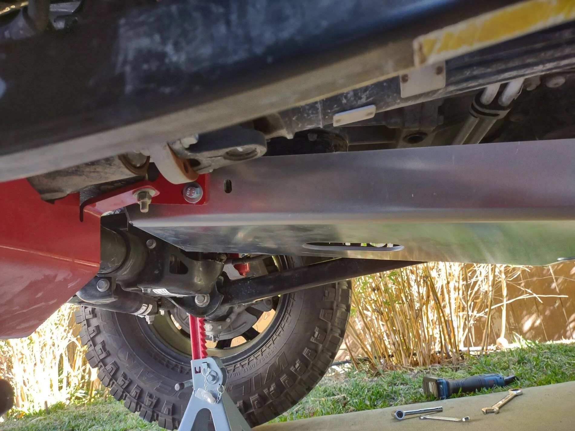

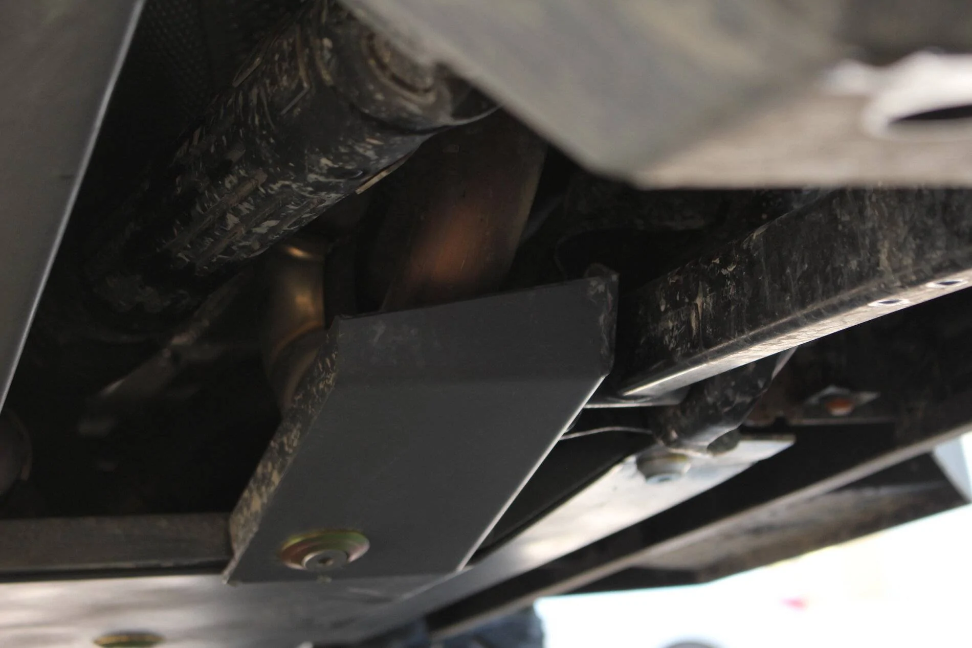

Install was pretty easy. There are no instructions but the exploded BOM was enough for me to figure it out. A few tips. Start by installing the 2 brackets that go up on the engine (?) Mount, but leave the bolts lose. Then attach the very end on the large cross member, itll help when lifting the front up, I didnt do this but i think itd make it easier. Then install the front little bolts that go on the brackets, leave them lose. I was able to fit my electric ratchet but one of them i had to use a small 1/4 ratchet. The BOM tells you to put with the bold end facing out of the skid, and i did that but I noticed one of them was way too close to my front diff cover and I didnt like that, so I turned them around (bolt head out) i suggest you do that. Then the c-clips that connect the skid to the trans cross member make sure you take a look at the holes of the oem skid and the trans skid and place the c-clips accordingly so everything lines up.
Oh and one last thing. I put the front axle on small 3ton jackstands, just to have a little morr space, i think this made things pretty easy. If you have a lift over rubi height then you should be good to go.
All in all it was a bit more than an hr. If you go the way i did and get everything tight at the end it should be straighforward. Skid seems very sturdy and great quality. And seems like minimal ground clearance is lost.

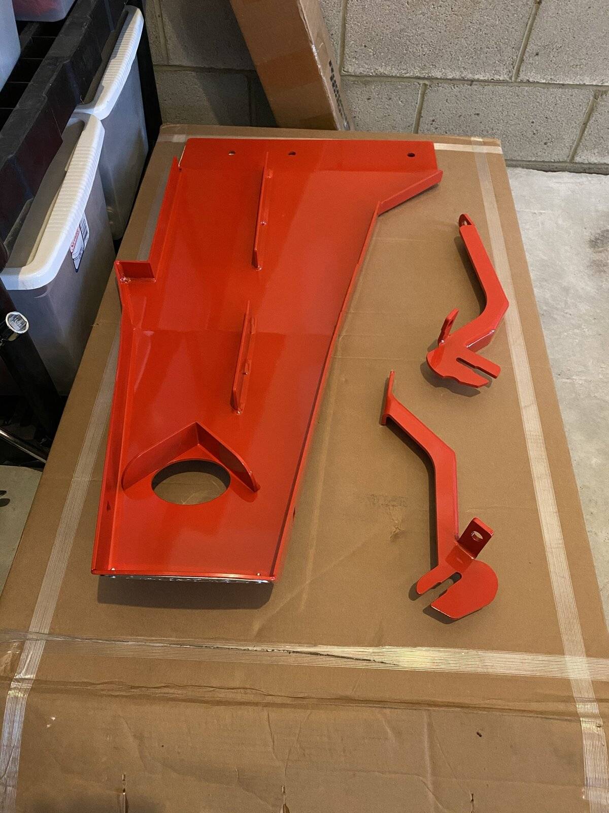

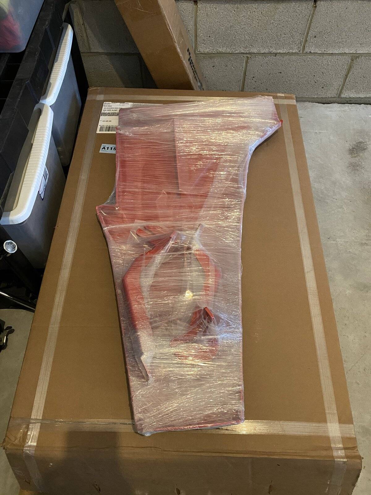

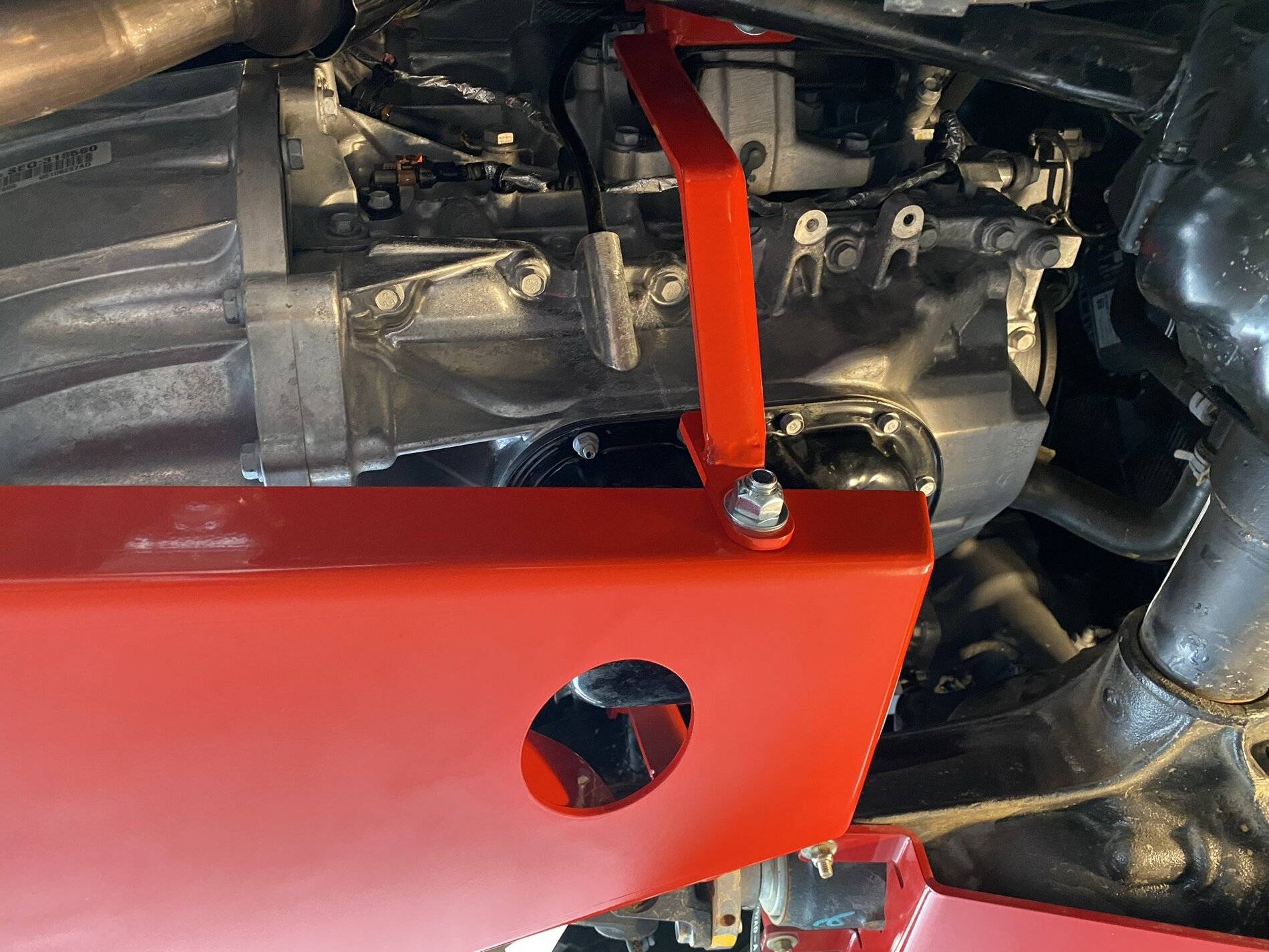

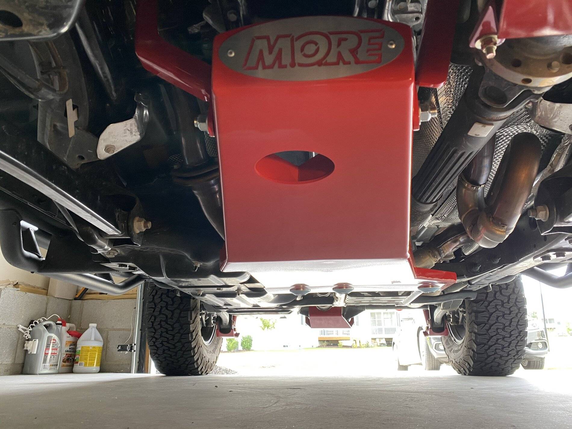

Outrider1
Dec 12, 2020
63
38
Wisconsin
None yet

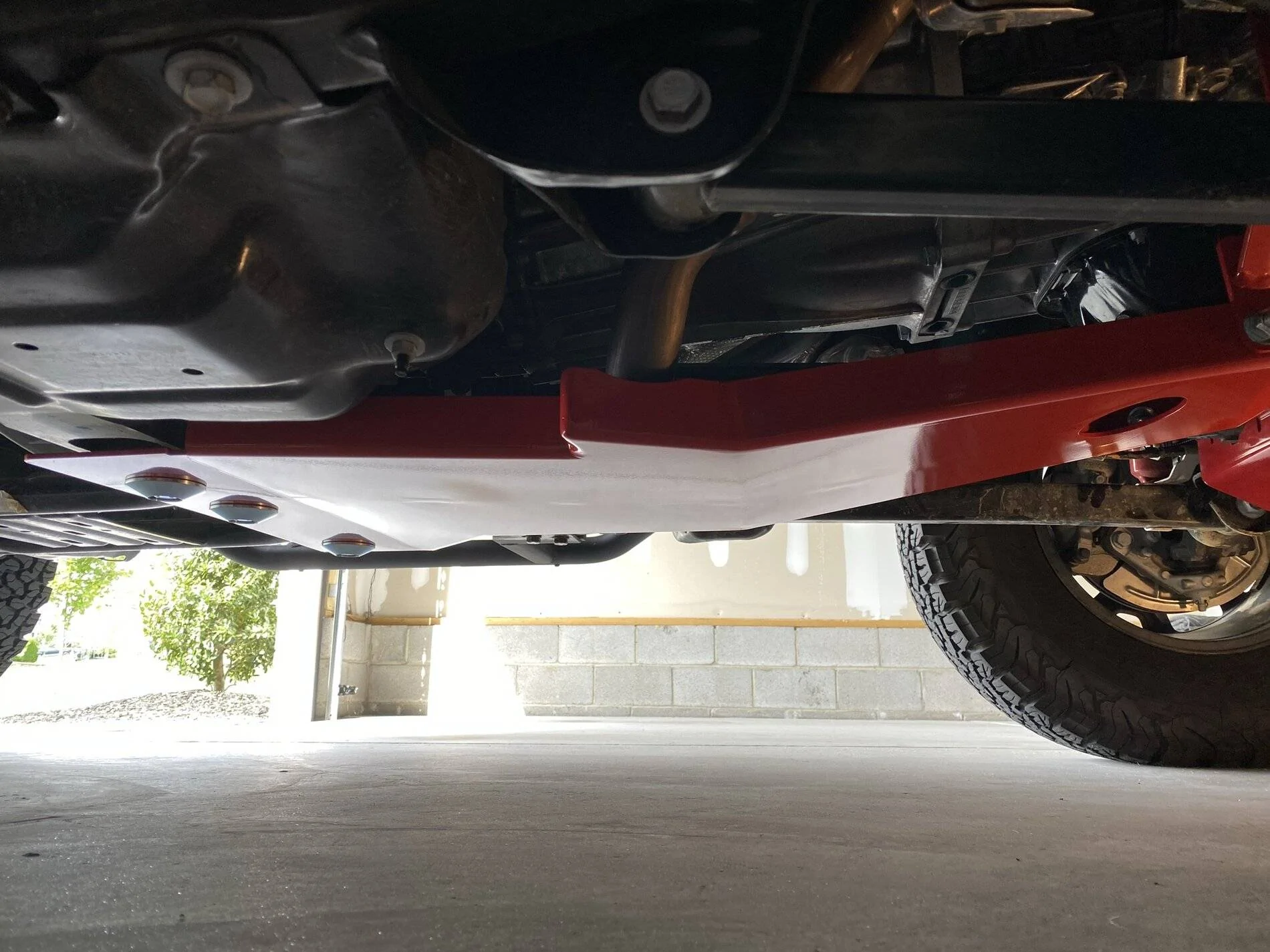

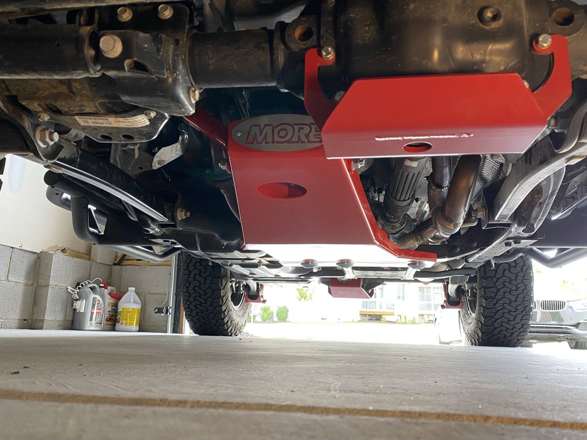

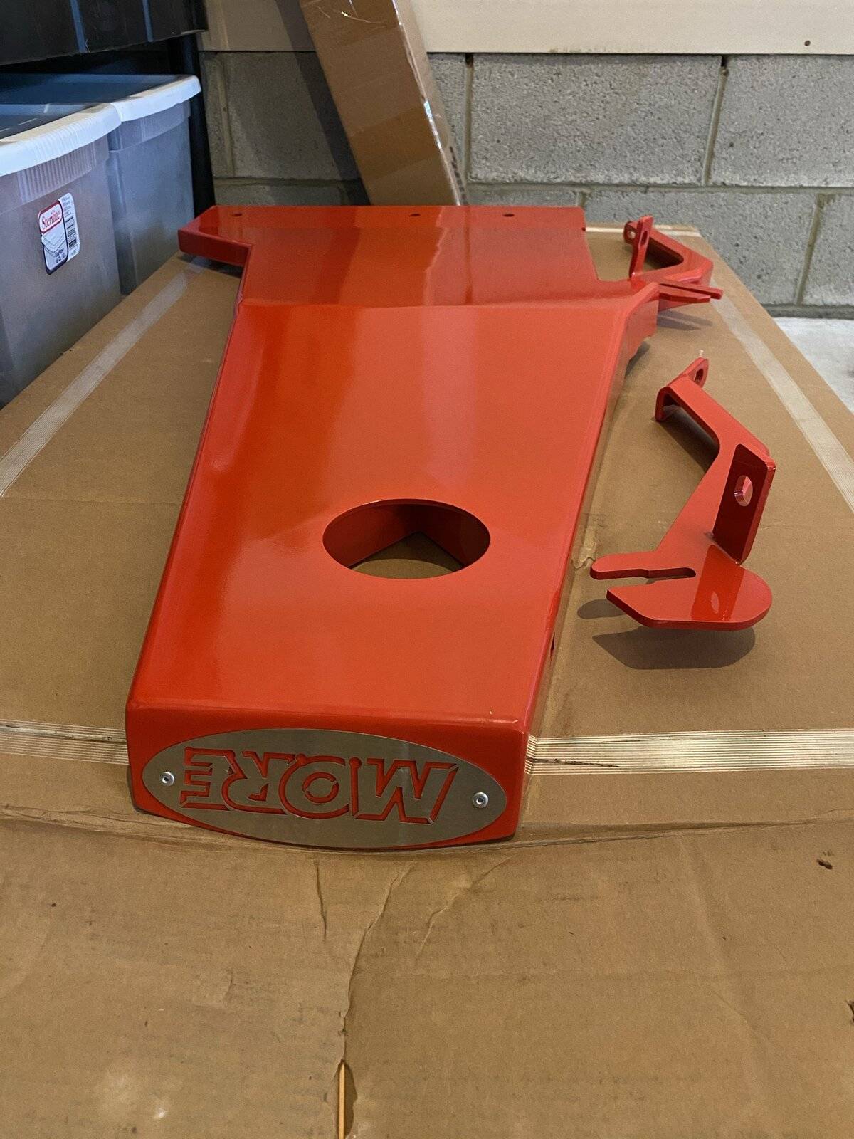

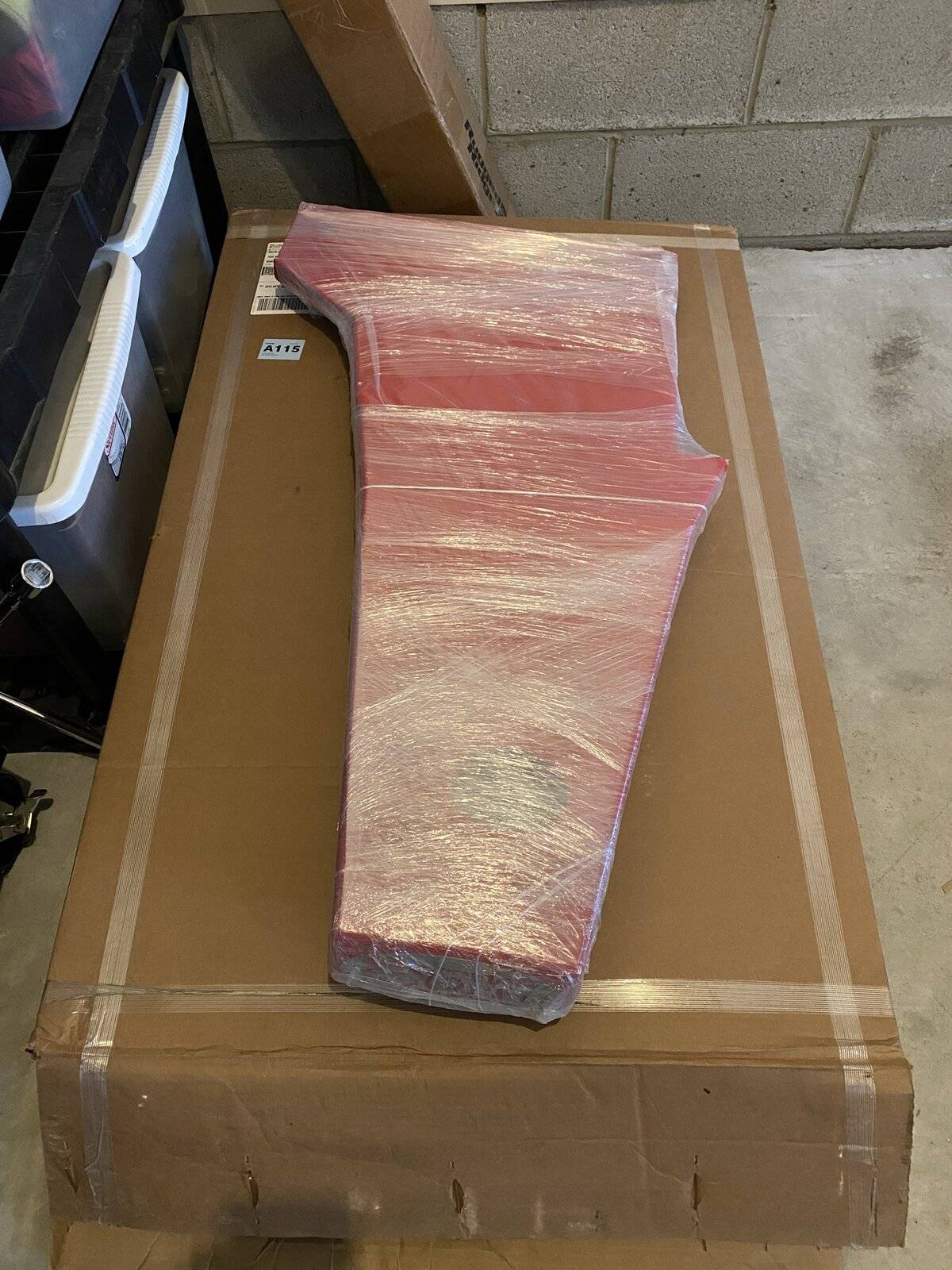

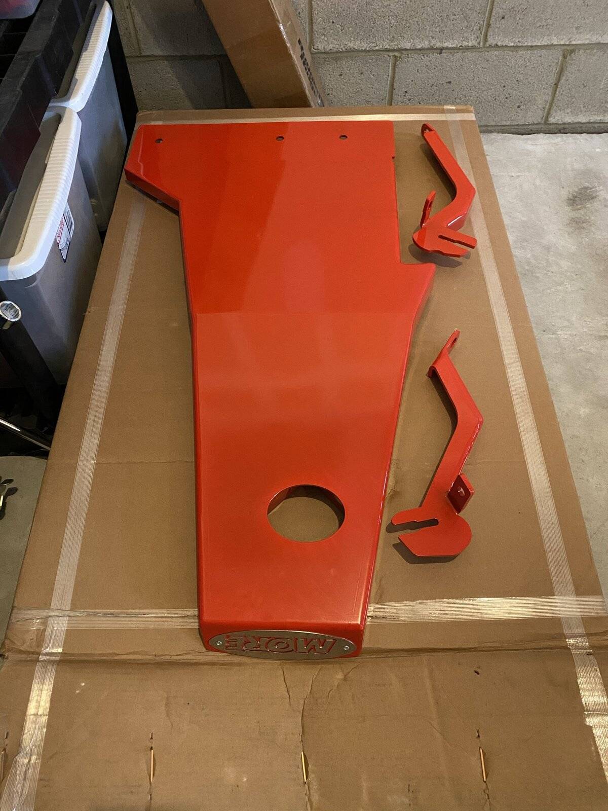

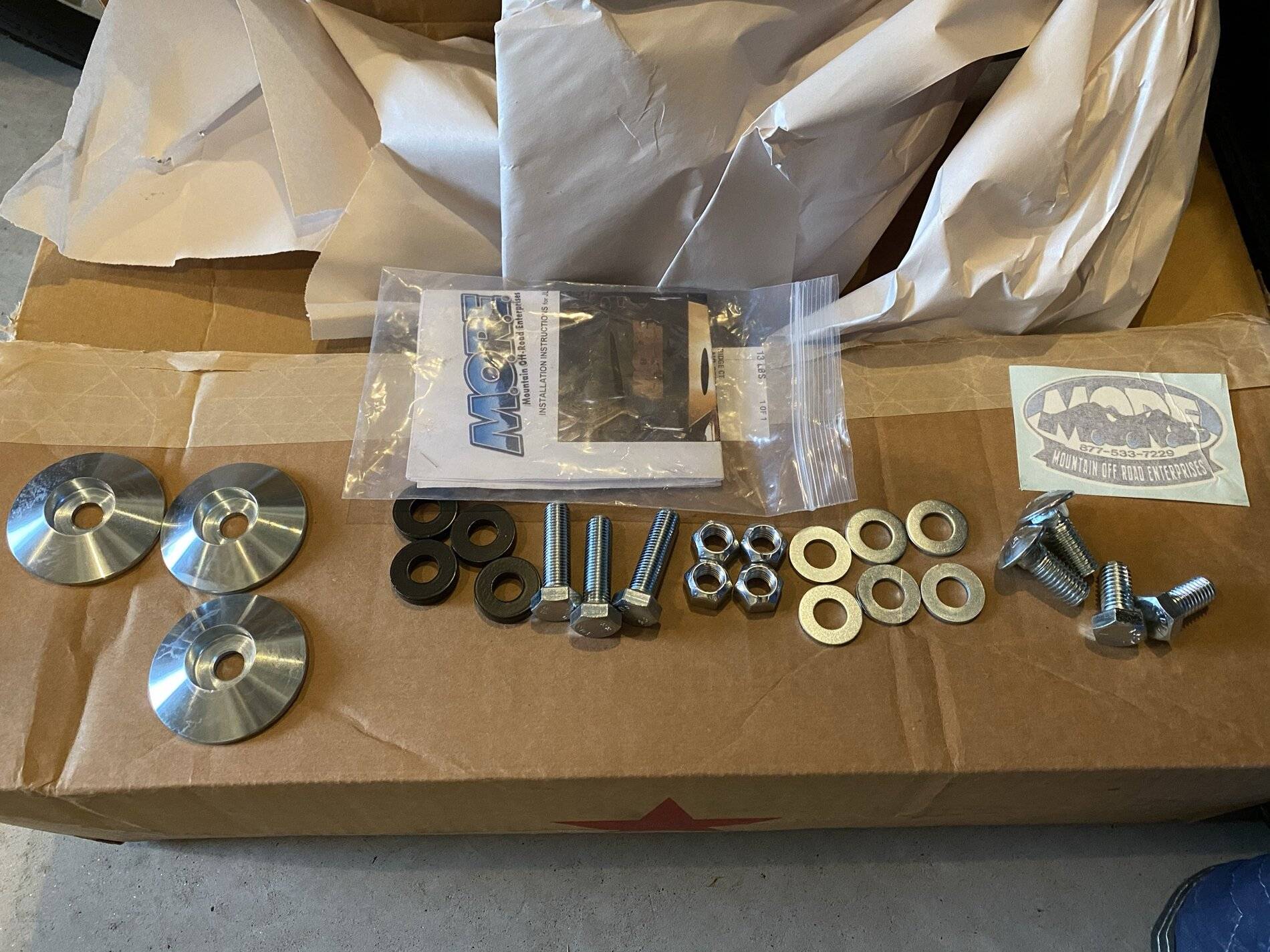

I have the steel M.O.R.E. one on my 2 Door JL Manual Transmission.
Great quality, and well packaged. Photo dump below.

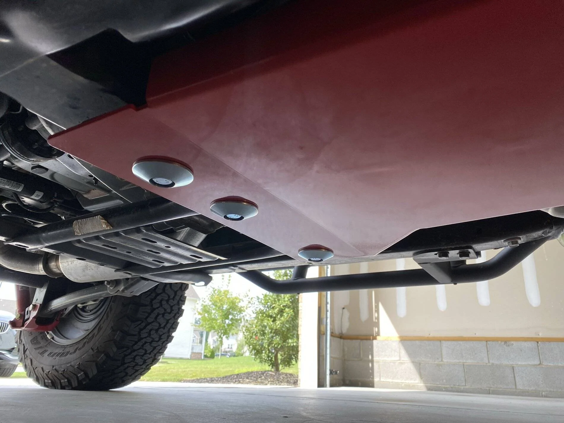

I have this as well and it is a perfect fit. Covers the things you want protected. Mine is an automatic.
I like that it's made in the USA.
