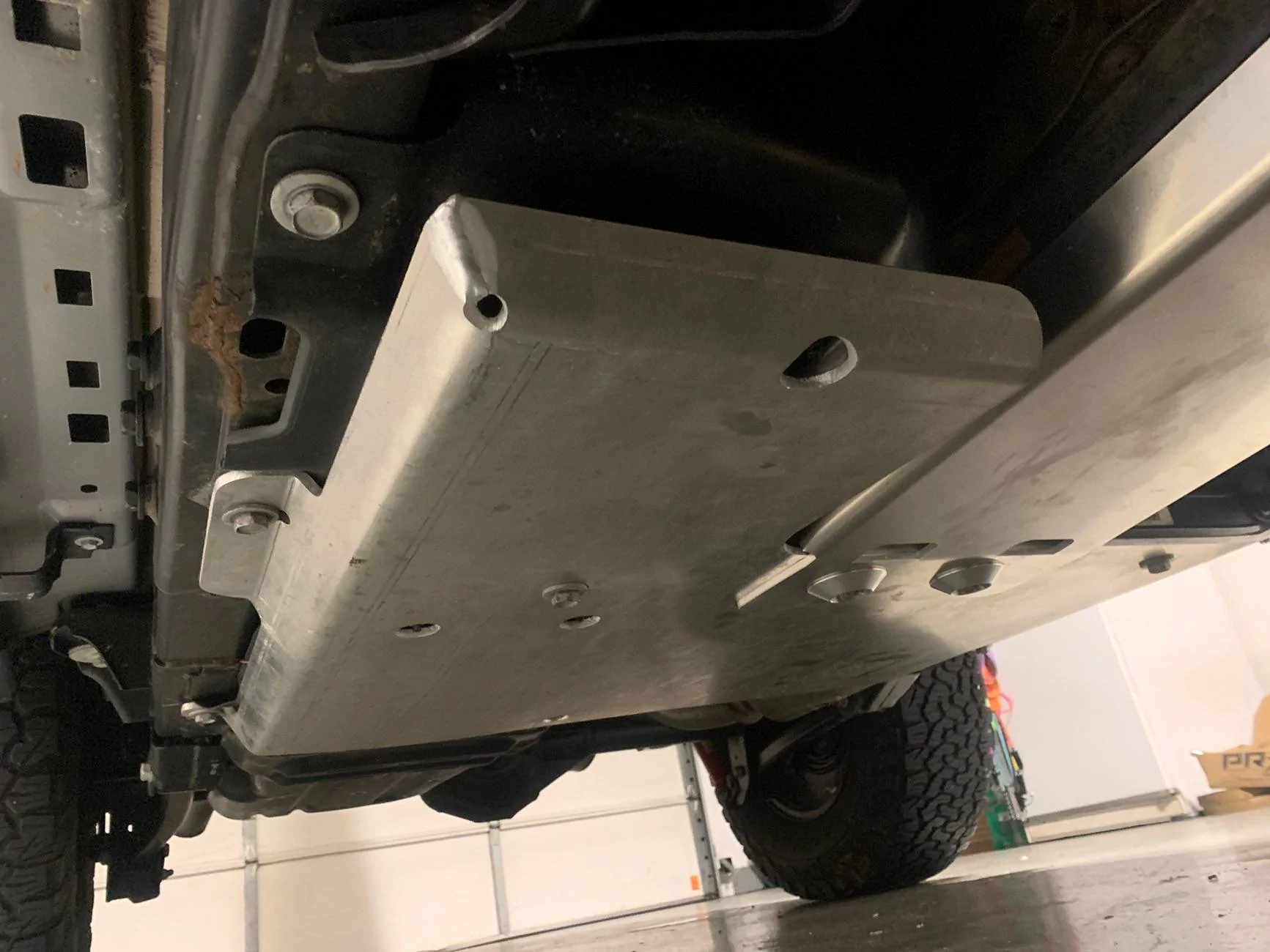

@3D duck I am not sure on the trans line routing on the 2.0 but it only comes in auto I would find a skid that at least covers the vulnerable engine and trans area. Most of the rest of the jeep could take a hit but a hole in one of those oil pans/lines is disastrous.
I adapted the Quadratec aluminum modular engine and transmission Skid Plate to use on my 3.6 2 door, it took trimming a stud off the gas tank skid.

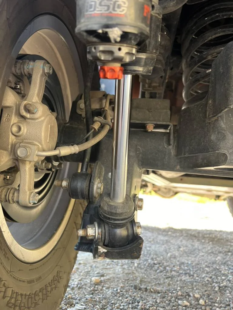

Great advice… LCA skids were my first protection add to the underbelly. Slipping off a rock happens a lot around here.
Jeep Wrangler JL Skid plate question 7528F70B-0C99-495C-A101-B850E46B7FCC_1_105_c
The LCA skids saved my shocks a bunch of times. That said, they do catch more because they are lower. Notice the shock body still got hit, so choose your lines carefully and you can avoid most damage.

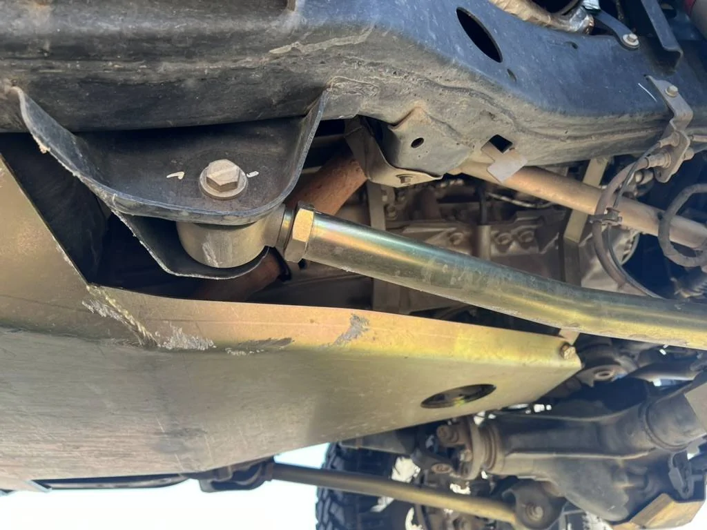

Jeep Wrangler JL Skid plate question 2A9AC354-BA2B-4395-A256-4A00E970FB6A_1_105_c
The main skids add a lot of weight, and I'm not a fan of how heavy I've gotten (and the Jeep). Also, having skids makes you feel invincible and you start choosing lines that scrape/bash when you otherwise wouldn't have.
Sounds like you are not going to be tempting fate, so save the money and continue to being careful on what line you choose. 🍻

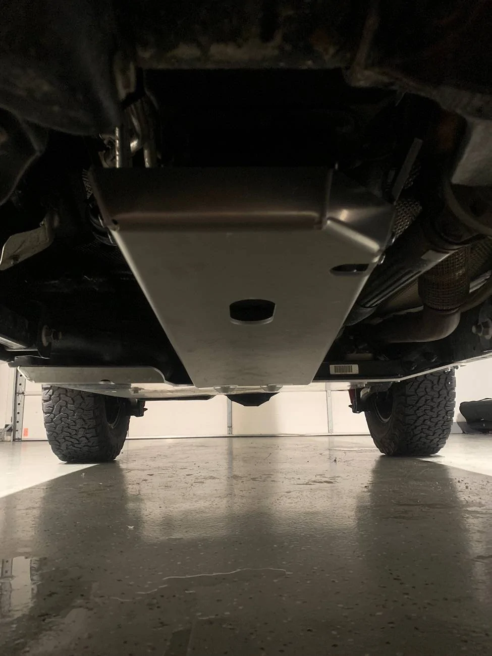

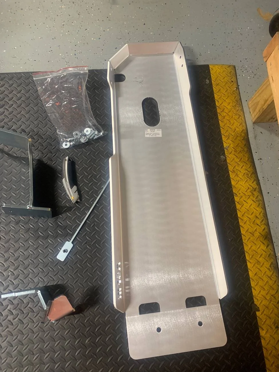

I’d start with engine/ trans skid. I went with Asfir for engine/ trans and TNT customs for their belly pan skid. Still running factory rubicon gas tank skid. After those skids I went with TNT customs sliders.
