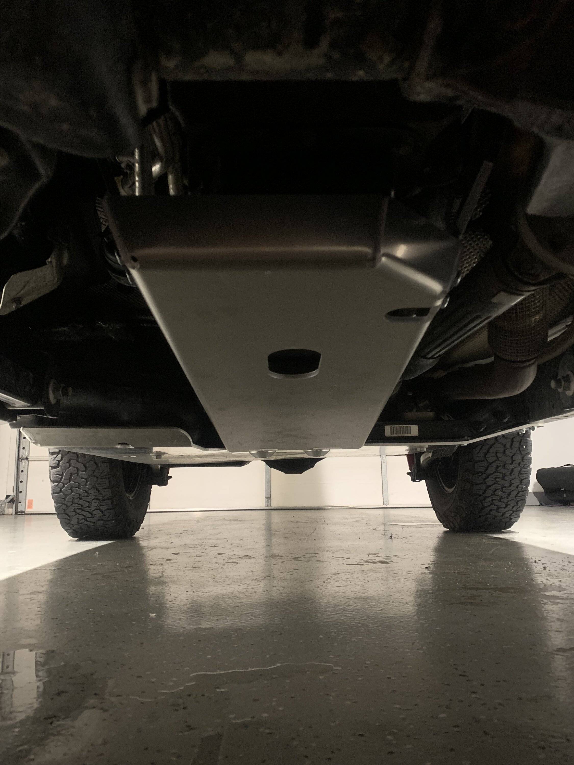

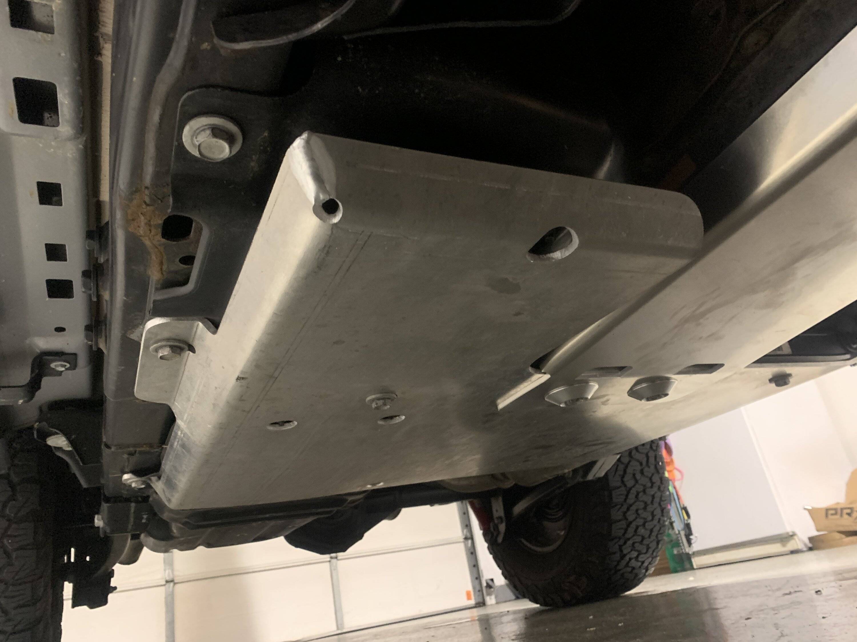

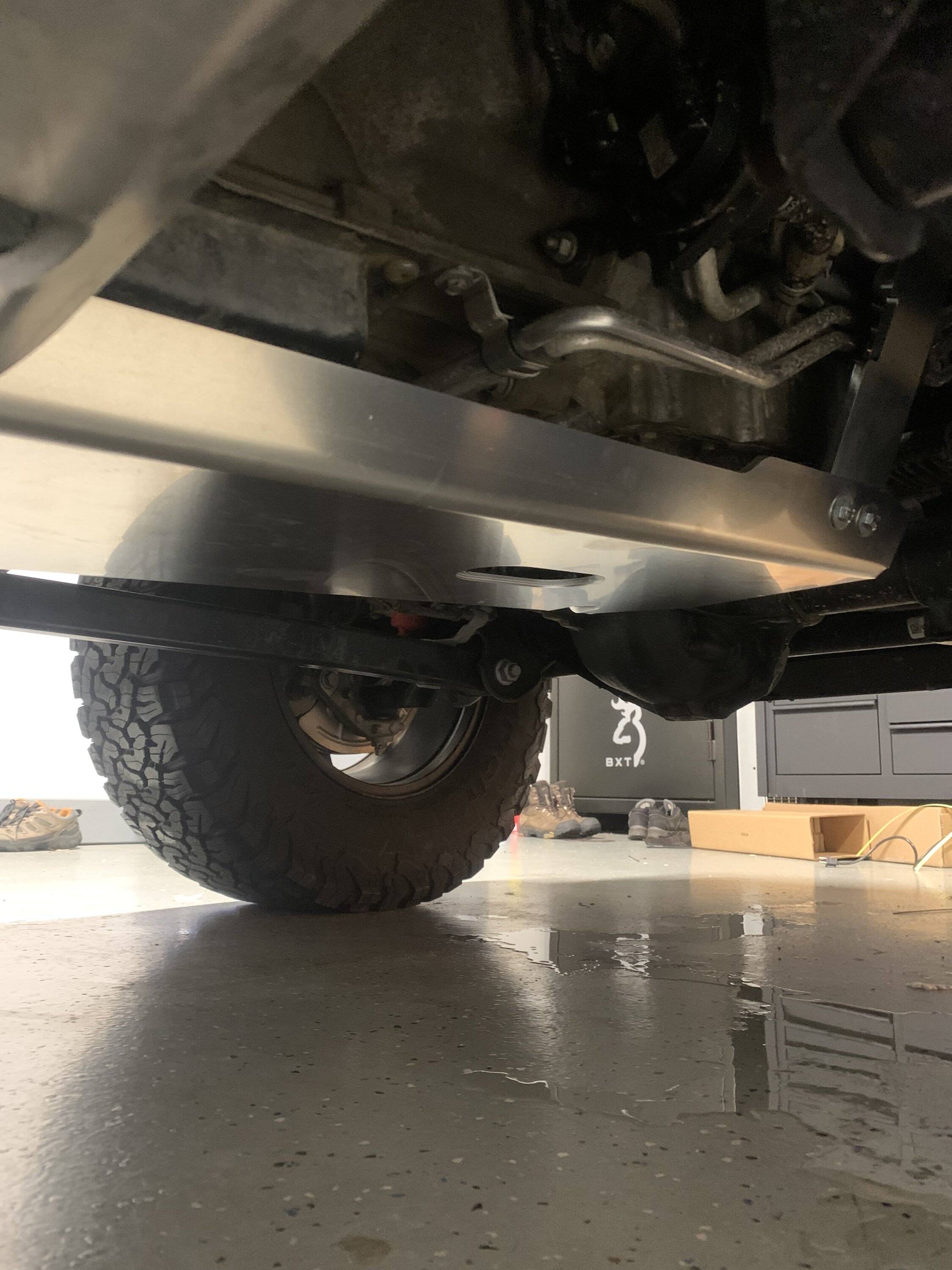

TNT Customs transfer case skid and asfir engine/ gear box skid. Asfir required zero drilling and the fitment was great with well built brackets. TNT t case skid has great coverage and fits well, required two holes to be drilled on drivers side for fasteners to secure the front corner.
