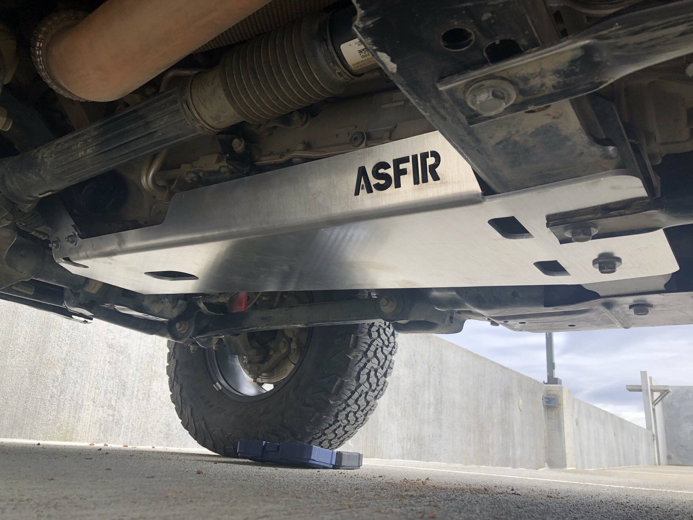

Should have weighed the deleted front crossmember to see how much net weight the ASFIR skid adds.
Crossmember felt like it weighed as much as the skid’s two steel support brackets.
Jeep Wrangler JL Skid Plates for 2-door 2.0? C1B79053-580C-452C-8D18-B3DA25E4CDC1
