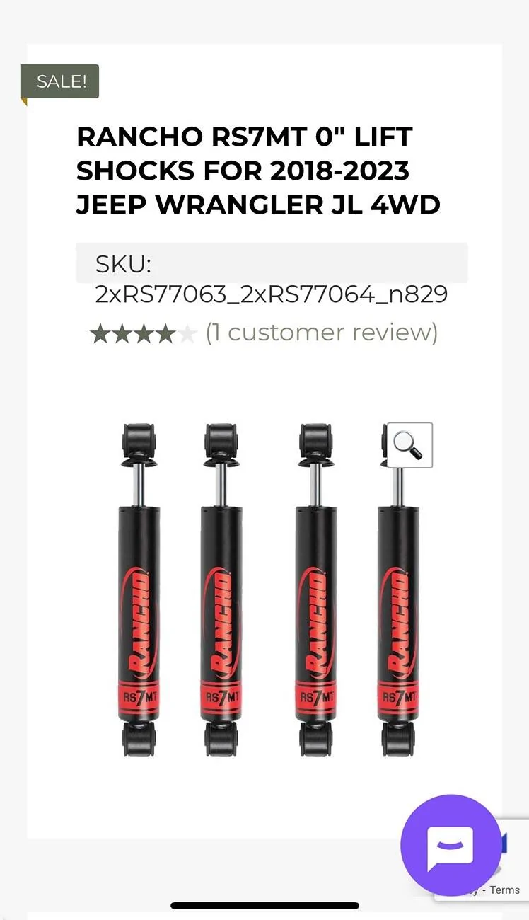

Shocks anyone running these

They are budget shocks that will be fine for a medium amount of time. Youre better off finding some Bilstein 5100s if youre just looking for a good quality factory replacement that you wont have to worry about that wont break the bank.

I installed the Rancho 9000 XL adjustable shock two years ago. I set the setting on 4 and it drives and handles excellent, way better than the stock shocks or the Bilstein's.

If Koni didn't have shocks available for my Pickup, I may try them but not on my Jeep.

Rancho makes good shocks. Rumor, is they make the stock shocks for JLURs. I wouldn't hesitate to put a set on my jeep though I've always heard that the cheapest, the 5000x, is the best. I had Billsteins on my Jeep TJ a few years back and it was awful on the small bumps. I swear, if I ran over a quarter, I could tell if it was heads of tails. Disclaimer: if you are running a tire and wheel combination that is heavier than normal, you findings might be different.

The 5000s have worse articulation/flex than the 7000s. They're barely more than a stock Sport.
Front Compressed 15.96"
Front Extended 21.96"
My impression is that the customer has a stock Jeep.
Compression is normally controlled by bump stops - .06" on the shock is meaningless
Extension/Droop might net you some articulation if you disconnect the sway bar.

Tenneco = Monroe
FWIW, I have read post where after market shocks need a rebuild around the 40K mark. Stock shocks seem to last longer.
Tenneco owns more than just Monroe: https://en.wikipedia.org/wiki/Tenneco#Operations
As for stock shocks lasting longer - they're not rebuildable, so it's kind of an apples to oranges comparison. The fluid will, with use, start to break down by around the same mark (40k-50k mi), but there's nothing you can do about it other than replace the shock. The recommendation from aftermarket shock manufacturers to rebuild is so you can get new seals put in (rubber deteriorates) and get new fluid put in (oil deteriorates). Your stock shocks, were they rebuildable, would appreciate a rebuild around the same kind of mileage/time.

This is why I will not purchase Rancho shocks. They were OEM on my 2018 Silverado. This was after three winters in MN. They leaked around 15K miles before they started to rust up. Gravel and salt were not kind to them. I had similar issues on a 2014 GMC Sierra which leaked at 15K miles. I replaced with Bilstein 5100s on both vehicles. I was very happy with the results. I understand that the vehicle manufacturers use the cheapest components, but they advertise as an upgraded "Rancho" shock on the higher equipped models. I have no experience with Ranchos on Jeep Wranglers.
