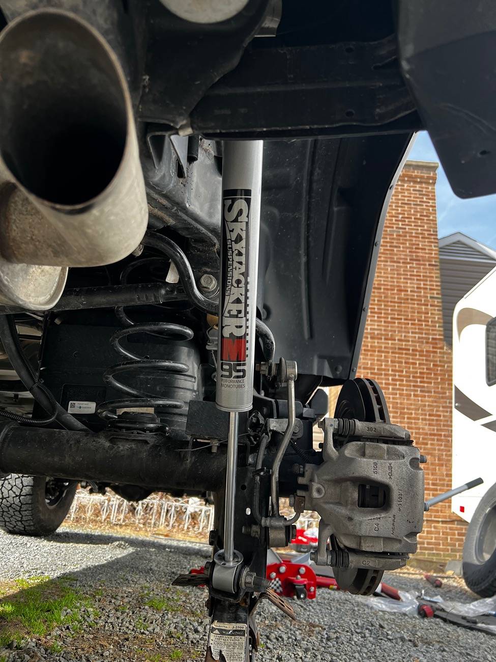

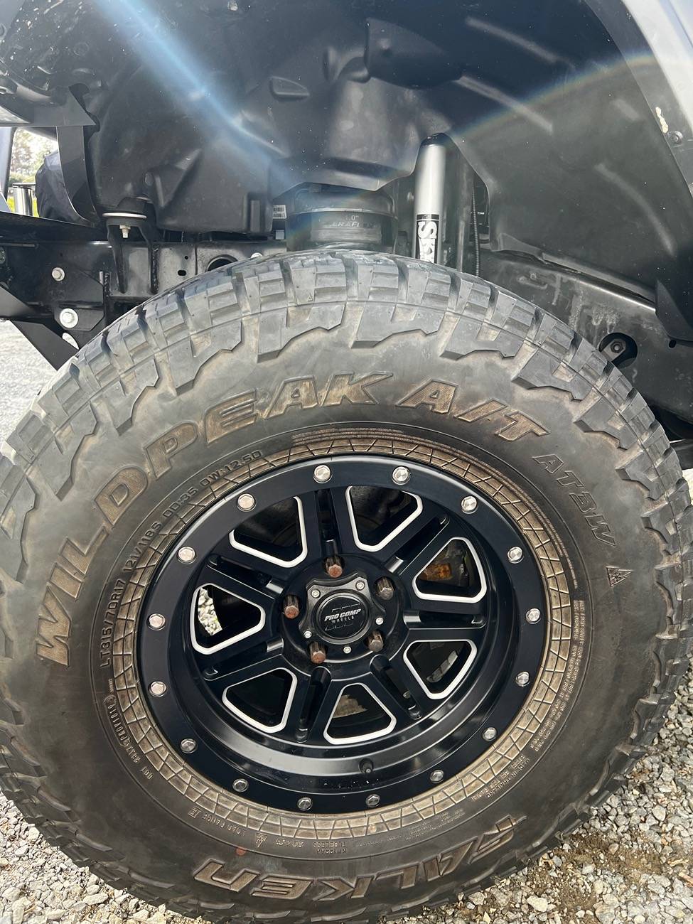

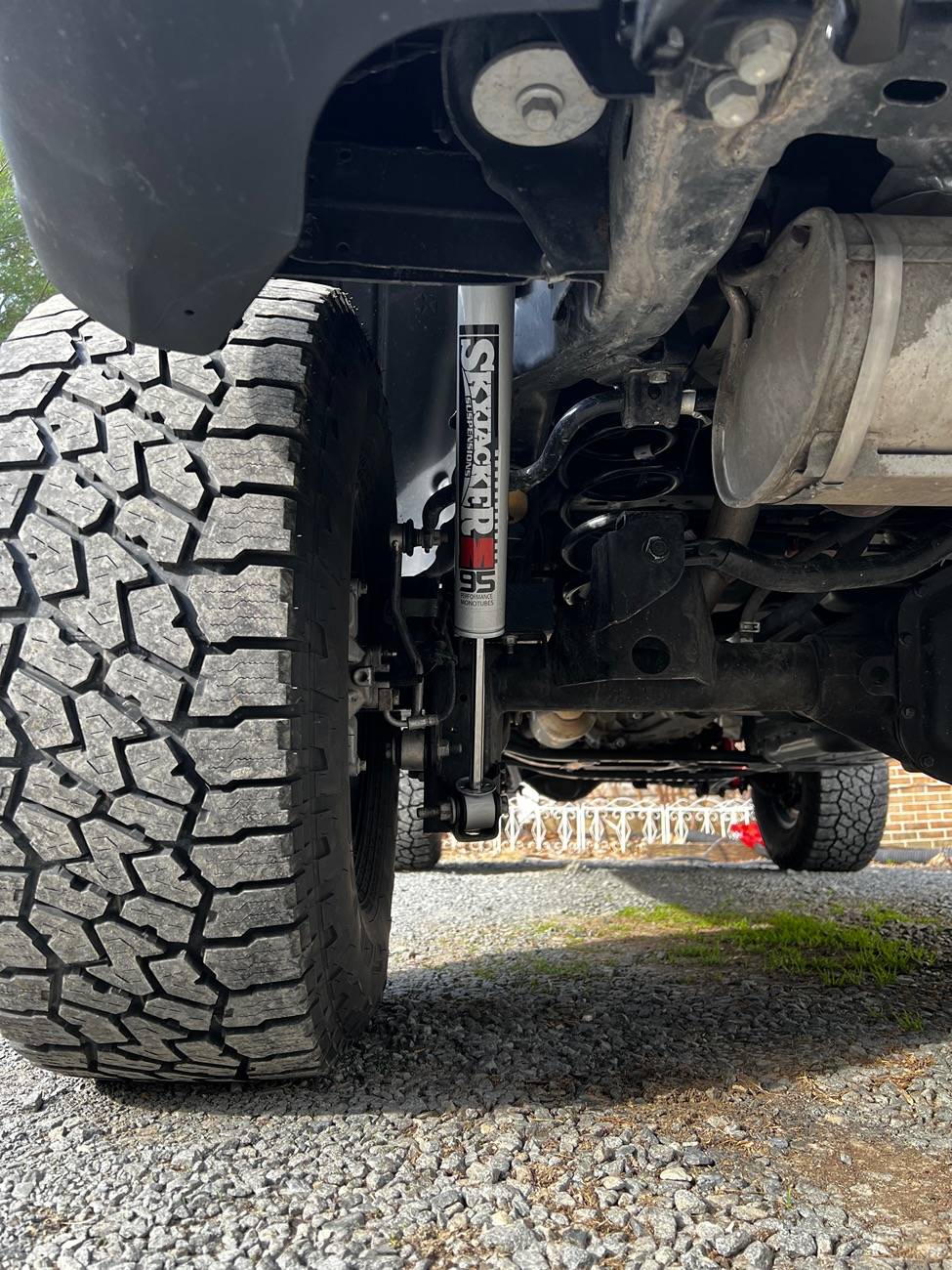

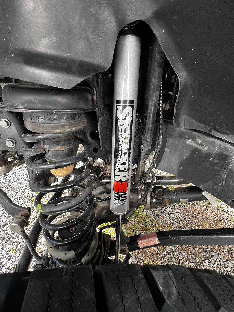

Got them installed!
I’ll give a ride report tomorrow or the next day.

I like that they are mounted body up, less unsprung weight.
Yeah supposedly since they are a mono shock design they are supposed to be pointed up to protect the body if the shock while crawling

Shock review
So I’ve been riding around on these shocks for about a week. I’ve put about 300 to 500 miles on them and did one wheeling trip over the weekend.
Disclaimer, I am new to jeeps and new to offloading, and my only experience is my stock sport shocks that I never went off Roading with, the Rubicon XR shocks that I took off Roading a couple of times before they started leaking, and now these shocks. So I do not have extensive experience with Different types of shocks or different offloading rigs but this is my experience with the skyjacker M 95.
My initial impression of the shocks is mixed? Leaning towards positive. To be clear, they are a $400 set of shocks mono tube that are not adjustable. I got some discounts from the place. I ordered them from and a $55 mail in rebate putting them at just over $300 shipped to my house. For that price I am happy with the purchase as long as they hold up for the next 50,000 miles plus.
On road I feel the shocks are responsive. I do feel they are slightly stiffer than the Rubicon shocks I had. I really wanted softer shocks initially however I have found with these shocks while there is more road feedback the shocks deaden the road feedback (I’ll try to explain). I’m not a shock expert or a pro reviewer so I will try to explain that the best I can. Typically when I would go over bumps with the stock shocks, there would be the initial bump, and then the settling down after the bump or pothole. With these shocks, what I have found is the Jeep gives slightly more feedback on the bump but settles immediately after the bump there is no “aftershock” (that’s how I’ll describe it).
I will also say, although there is more feedback and maybe this goes hand-in-hand, but I do feel more connected and planted to the road which I initially did not think I would like, but I am enjoying.
Off-road, I believe the shocks worked very well. I do believe they gave me a little more travel in my front end. The reason I believe this is because I had some rubbing for the first time when I was wheeling the other day and I have not experienced that with the stock rubicon shocks and my current suspension set up.
I think to know for sure, I would have to run a trail that I have run before for a proper compare and contrast. The trail I ran this weekend was a new trail to me. There was a bit more rocky area and rutted out uphill mud climbs, but all in all I think they performed well .
