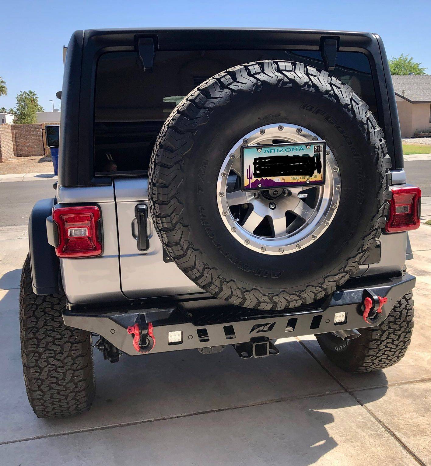

I installed the Rusty's carrier over a year ago. Couldn't be happier. And also no rattles what so ever. I drilled the holes and found that I my eyes don't even notice the extra support. A 37 inch tire pretty much covers it up. With the extra weight of the tire I welcomed the extra support of the brace as I am constantly getting into the back of the jeep. I could agree with some saying they don't think it's needed as the carrier is plenty tough enough without it. I think it just helps. To each is own.
