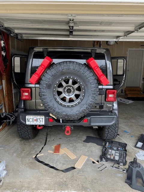

Based on other Rugged Ridge and Smittybilt parts - I would not think of trying their carriers. Some have had good luck but have not.
My choices were down to the Rusty's, ACE, and EVO.
Choose Rusty's due to robustness, ease of installation, and the e-coating - their customer service was world class. Liked the EVO (simplest) but do not want it rusting. ACE does not sit flat parallel to the tailgate and is more complicated than it needs to be.
Had a chance to finish and drive it today. On the road no movement and no rattles. It does sag a 1/8-1/-4 inch when opened but shuts well and is spot aligned when closed (better than factory). Will do some trails soon with it.

Have had it on for a few thousand miles. Mostly road but have pounded on a few trails as well. Put a heavier tire on it and now the combo is approx 105-110lbs.
I have taken it apart and adjusted better for a closer fit to the tailgate. I drilled a hole it it and used the factory rubber bumpstop in place of the metal bolt on. It does a better job, it allows me to get closer to the tailgate, and it is safer on the sidewall of the tire.
The sage is an alignment issue - my fault. I need to take apart and remove one of the shims since I am using a heavier set-up. I think that will cure the alignment. Other than that, still no movement, rattle, etc. while driving road or no road.
