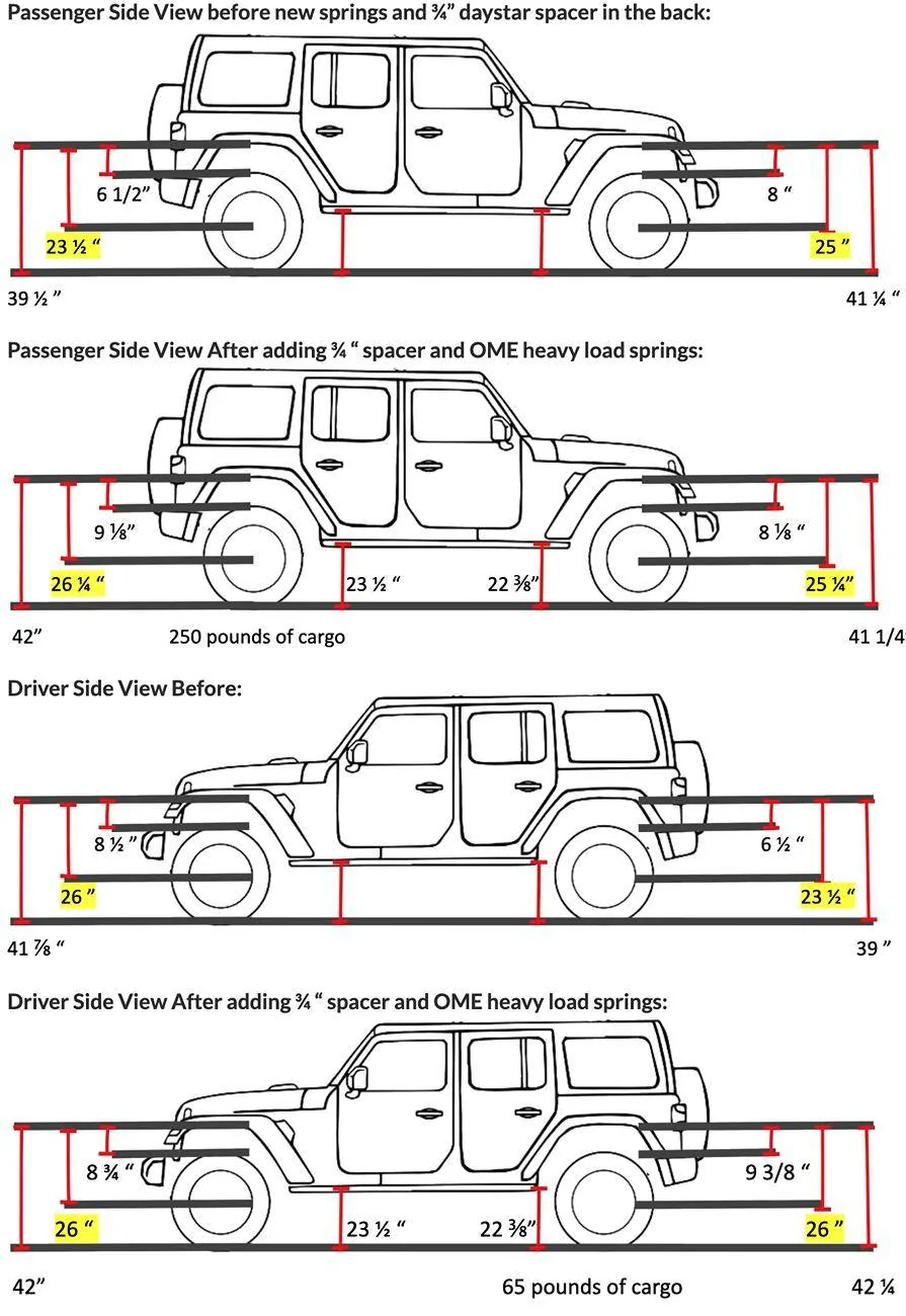

Does anyone know the stock suspension heights in the front or back, I have 24 Rubicon X with 35s which would be same as JL Rubicon with extreme recon package?
So I installed the OME springs in the rear and here are my measurements. Assuming the Jeep should be level or some both in front and back, looks like I am a little off on Passenger front tire 3/4" lower so may need to install a 3/4 inch space in front? The 3 other side all look about 42 inches.

why would you assume it's supposed to be "level"?
have you measured with a full load of passengers and/or freight? that's what really matters.
Not sure, I am getti g different info. what should it be? I will probably add another 150- 200 lbs when fully loaded for a trip.
