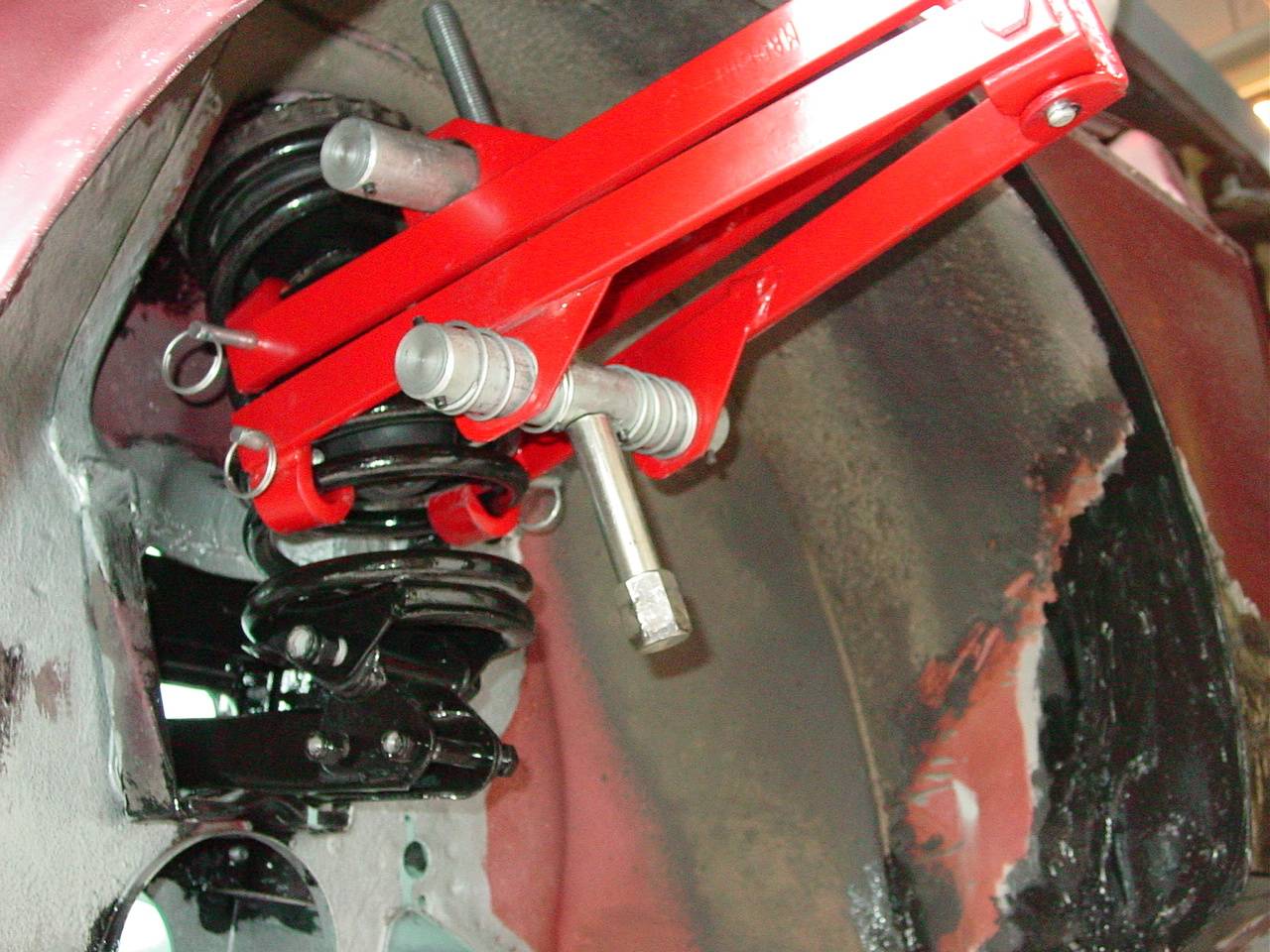

Is there a way to do this without taking the wheels off? Or is that the only way? I was reading a spring compression tool can be used but they seem sketchy. Will the steering need to be adjusted if I add a 2 inch spacer to front only?
It would be very tough to do with the wheels in place.
A proper spring compressor would make it easier, the scissor style are best for that application:
Jeep Wrangler JL Front end suspension spacer recommendations?? Sagging front end spring compressor
Yes, you will need to adjust the steering wheel, it's easy to do, check this video out:
