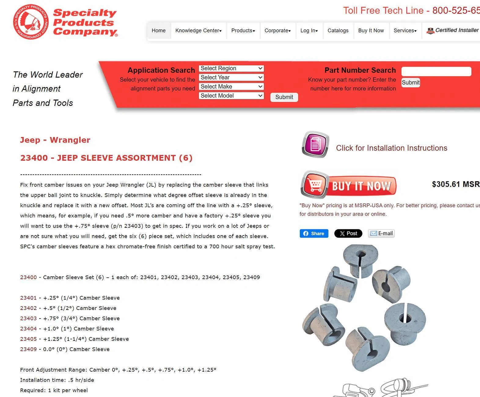

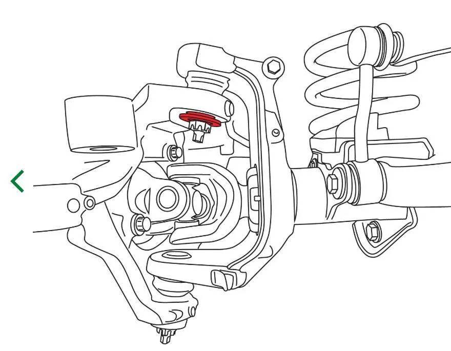

Have your front end inspected first.
Toe is adjustable.....Are you going to purchase alignment bushings and pay to have them installed for camber setting adjustment?
No clue...you're talking with a blank canvas here... :CWL:

Do you have a Manufacturer part number for those?

Holy crap bad advice here....alignment bushings??????
For a stock jeep something is going on. First off, how many miles and a little about your jeep.
Then look at getting tires balanced, rotate tires, check all bushings in control arms, tie rod, drag link, tbar....Steering stabilizer might need to be replaced but is only a band aide.
Check all other things first before rushing to replace parts and alignment.
