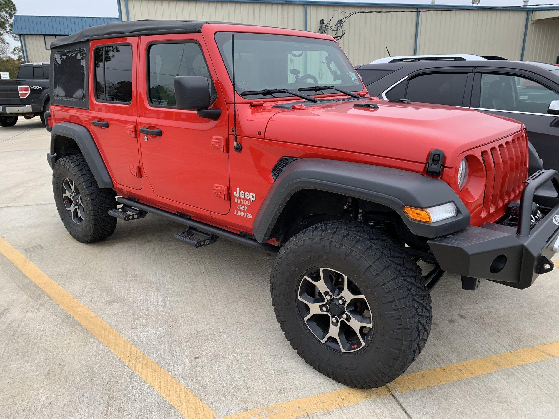

Hey all
I have the 2.5” skyjacker lift on my JLU sport and it has been great and sat almost level - I added a full width LOD bumper, skid plate and winch (about 165lbs) and I am about 1.5” lower in the front than the rear and would like to get back level. Would it make sense to add a spacer or go with taller coils? Thinking about maybe upgrading shocks as well with the extra weight.
What would you do to get back to level....

A spacer is the easiest and cheapest way to level it out. Skyjacker also has a 3.5/4 inch kit. You could add their taller front springs.

I have the sport kit - I can’t remember my exact measurements but I think I was about 3/8”-1/2” lower in the front before bumper and winch - sag may not be the right term but I would like to get it back as level as possible. I want to add adjustable track bar as well so I may try taller coils while I am at the track bar

Leveled up, went with the next length coils up front, upgraded to M95 shocks and added front adjustable track bar while I was at it.

Looks good. How is it riding?
Rides great, sounds funny but it doesn’t feel as “heavy” in the front. The M95 shocks are a nice upgrade and their adjustable track bar is pretty solid.
