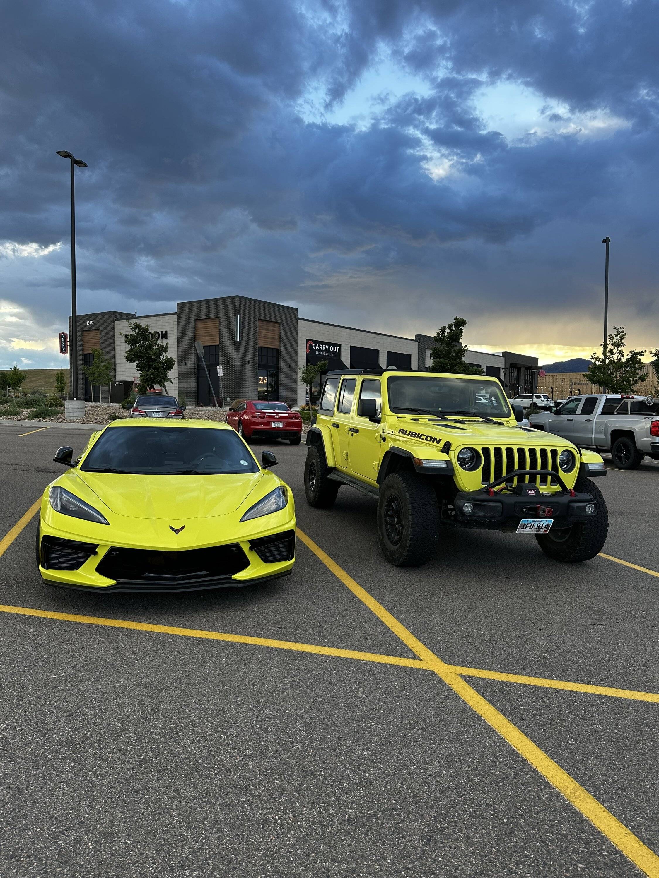

Will the Rubicon stock springs handle the extra weight?
Yeah. I have stock Rubi springs and front pucks on my mostly stock Rubi with a winch.
