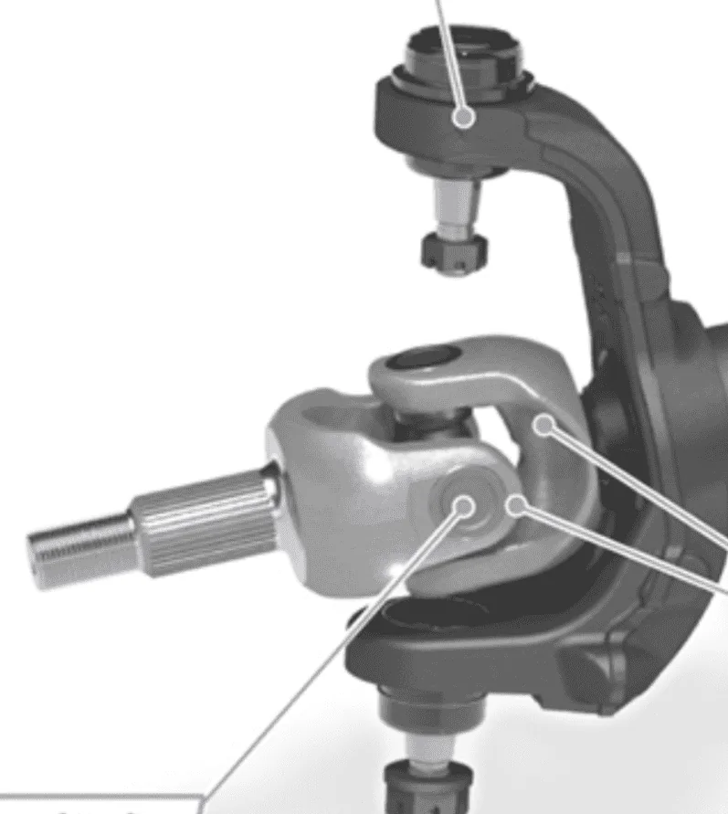

CVs do indeed have boots, but I haven’t heard many stories of people tearing them. As shown above, the U-joint is more mechanically simple, but that doesn’t mean it’s an issue most people should care about.

Not if you are turning...or have RCVs.
CVs are better if you replace them with a better CV? I would agree. RCV (hopefully) seems to have also addressed how easy it is for a twig to tear the CV boot.

I haven't, as of yet, heard of any issues with the CV either but it is a theoretical problem. If the boot does get ripped it could be a problem that you don't notice until it is catastrophic. The reality is, u-joints are simpler than CV joints. Now, I prefer CV joints for many, many reasons but it is a trade off that is worth noting.

on Jeeps, if you rip a CV boot you have to replace the whole axle shaft. No such problems with the simple ujoint thats fully serviceable.
