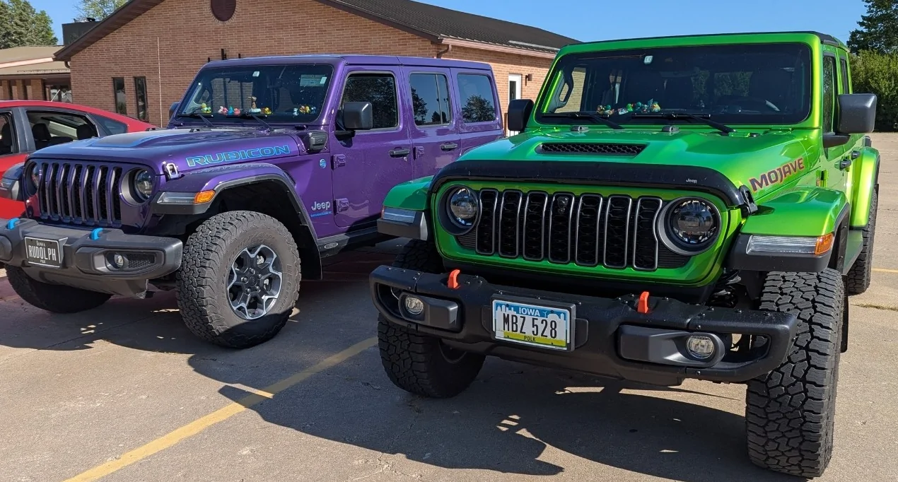

Apparently the steel performance hood is a thing now
@5:45
So they do have a whole warehouse of those 392/Mojave steel hoods to use up/get rid of.
It won't be a Rubicon hood per se, but just like the darned heavy steel hood on my Mojave.
So it won't be a standard Rubicon hood (on the left in pic) but will be the 392/Mojave hood, like on right in the pic.

That makes sense on the one they dropped today, since that's the 392 hood, which is steel, but the Rubicon X doesn't get that hood. I suspect then just a misplaced spec on that sheet.

My 2025 X hood is not steel.

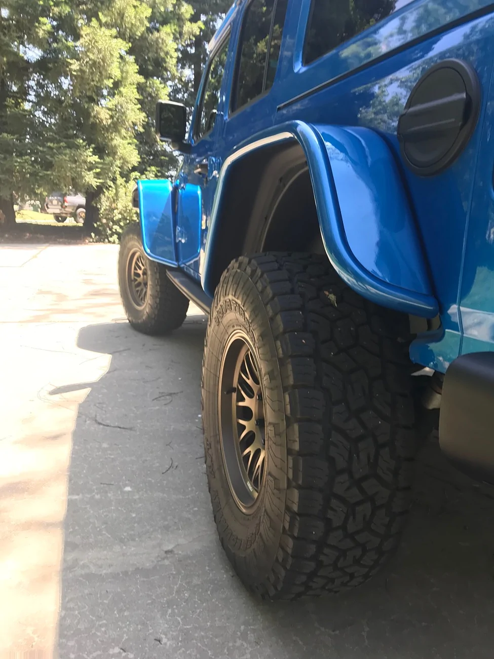

I have learned to live with fender gap after getting the new High Top fenders that make the 35’s look small. 37’s have to wait until I need tires. The gap doesn’t even set off my OCD anymore. …. much

Going to smaller tires isn’t exactly typical here but the flare extensions could easily be removed. They riveted into the same holes with one extra hole needed to be drilled for install. Leave the suspension including the bump stops alone. An extra ~ 1 1/2” gap (XR suspension lift) is minimal and small compared to mine.
These fenders are designed to accommodate 37’s on a non XR.
Jeep Wrangler JL Question for experts about full time transfer case availability 6EAA0B3E-7A37-4EEA-BDDB-5DB0D460A685
… Swap for 33’s, remove extensions if wanted, recalibrate, done.
don’t sweat 1 1/2”
As @Dusty Dude said , 33’s with 4.56’s would also be advantageous in town.
