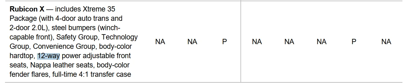

Yes that shows the power seats - but the standard transfer case.
Sadly, that transfer case is included only with a "package" (P) and that package is the recon package with the big tires and lift.
That's the one and only way to get it - the recon package -which lifts the thing about 2.5"and adds to the difficulty getting in and out for people like us.

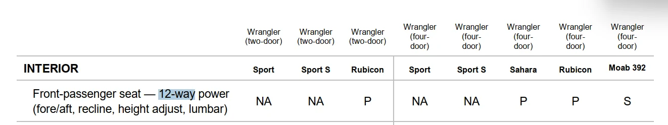

The power seats come with a package as well, but what's really bad is even the options PDF posted here DOES NOT SHOW HOW you get them!
Power seats are part of a package in the Rubicon and Sahara - but, what package?

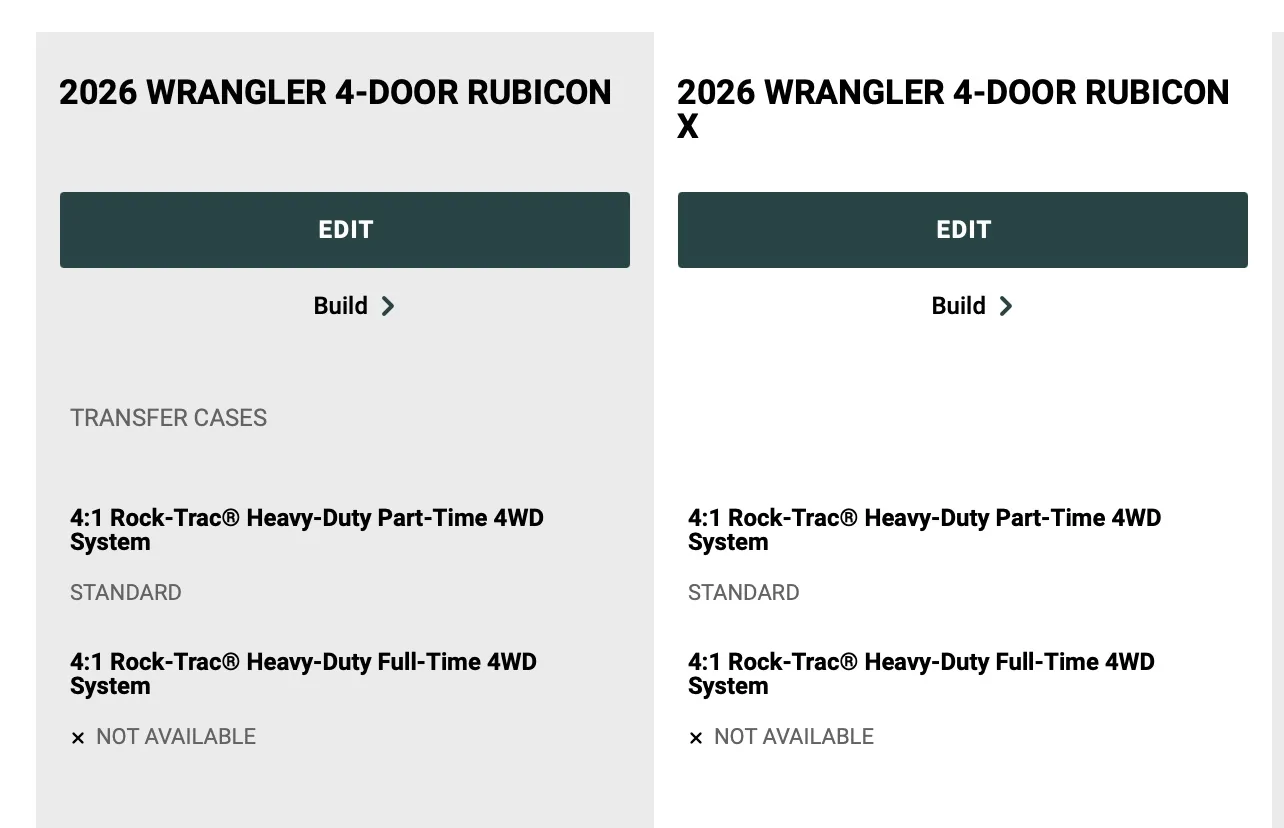

Did Jeep drop the full-time 4WD transfer case for 2026 X? I know I've been seeing new JTs in the X package without it. From their compare tool:
For the JT it will not show up on the window sticker or comparisons
The comparison tool sucks.
The only way to get that transfer case is with the recon package, and the X automatically has the recon package - but it doesn't show up anywhere on the build or comparison site.
Frankly, you can't rely on anything Jeep has posted on their web site. It's horrible, worse than that, even - worthless.
