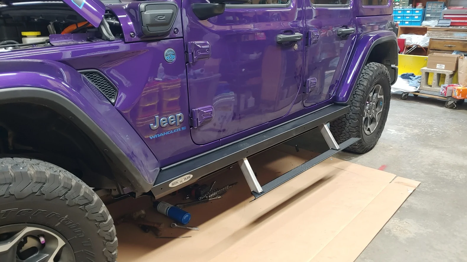

Sort of like these, perhaps?
Jerry here knows all about these. He helped get them on the current JLU 4xe Rubicon
I put then on my JT, and they are on my current JT (2025) as well.
They'll come off this JLU and go on any new one.

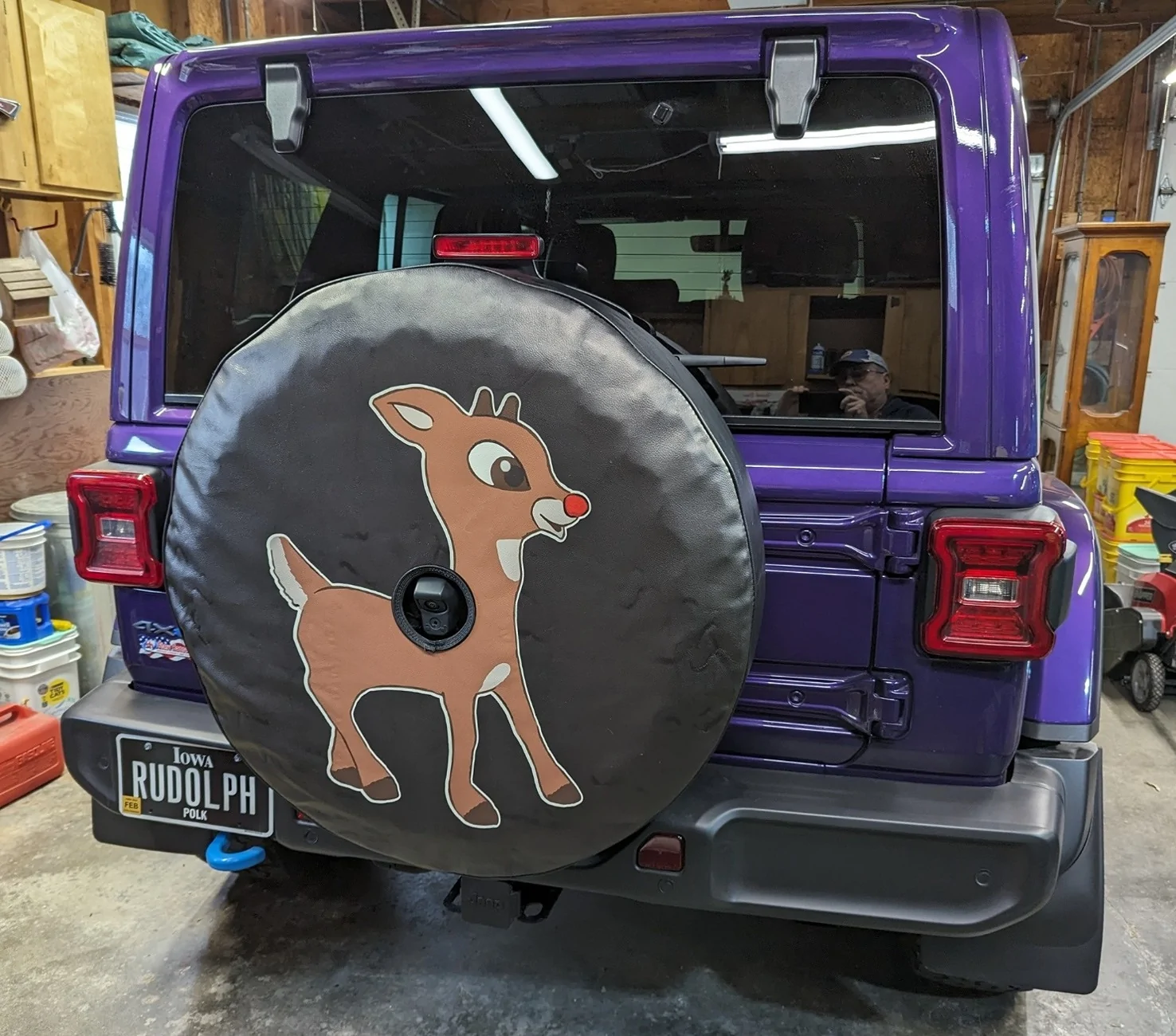

She's gonna be really unhappy not being able to use her custom tire cover! She's a Rudolph nut like no other in the world and she LOVES this tire cover -

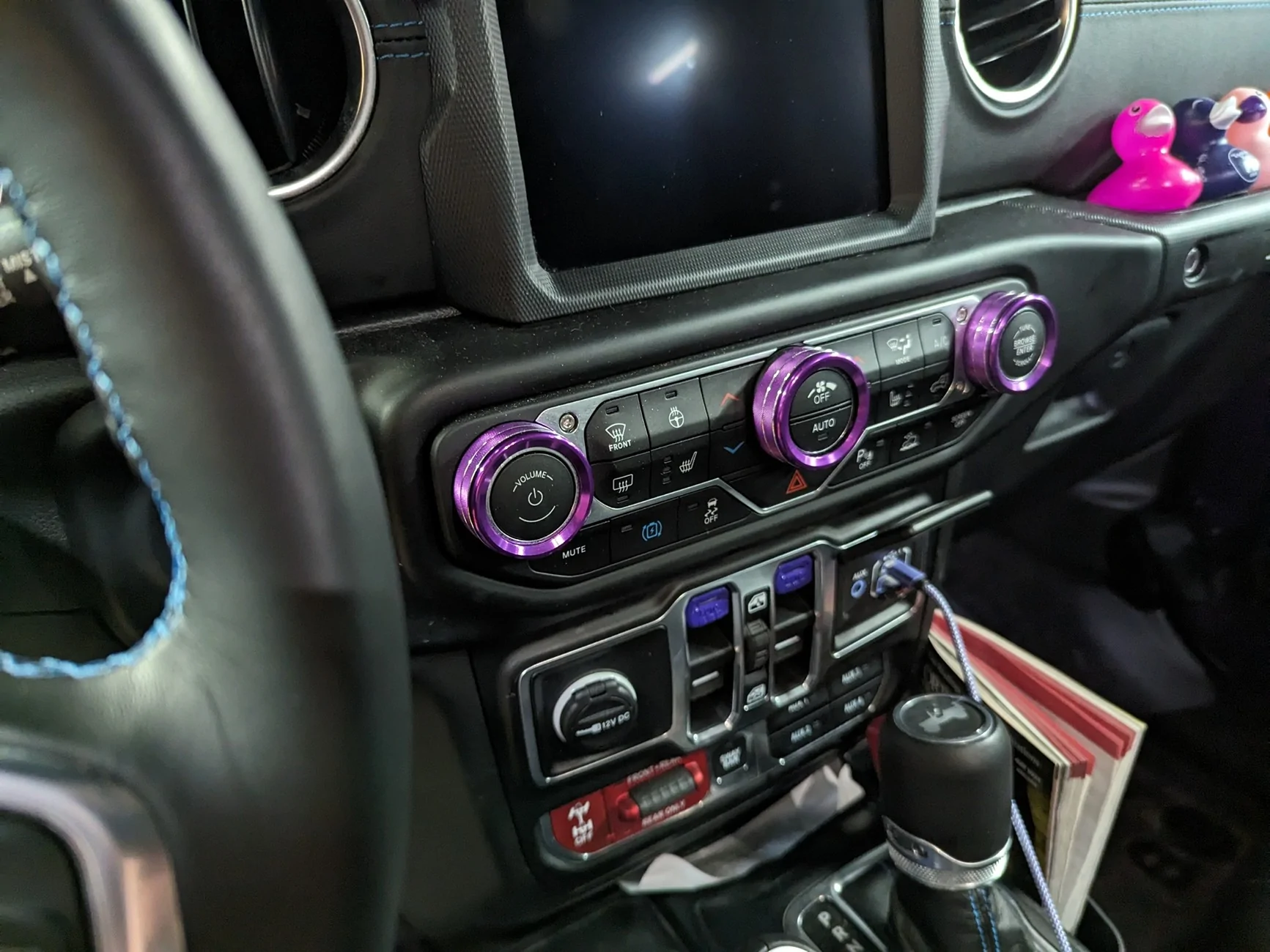

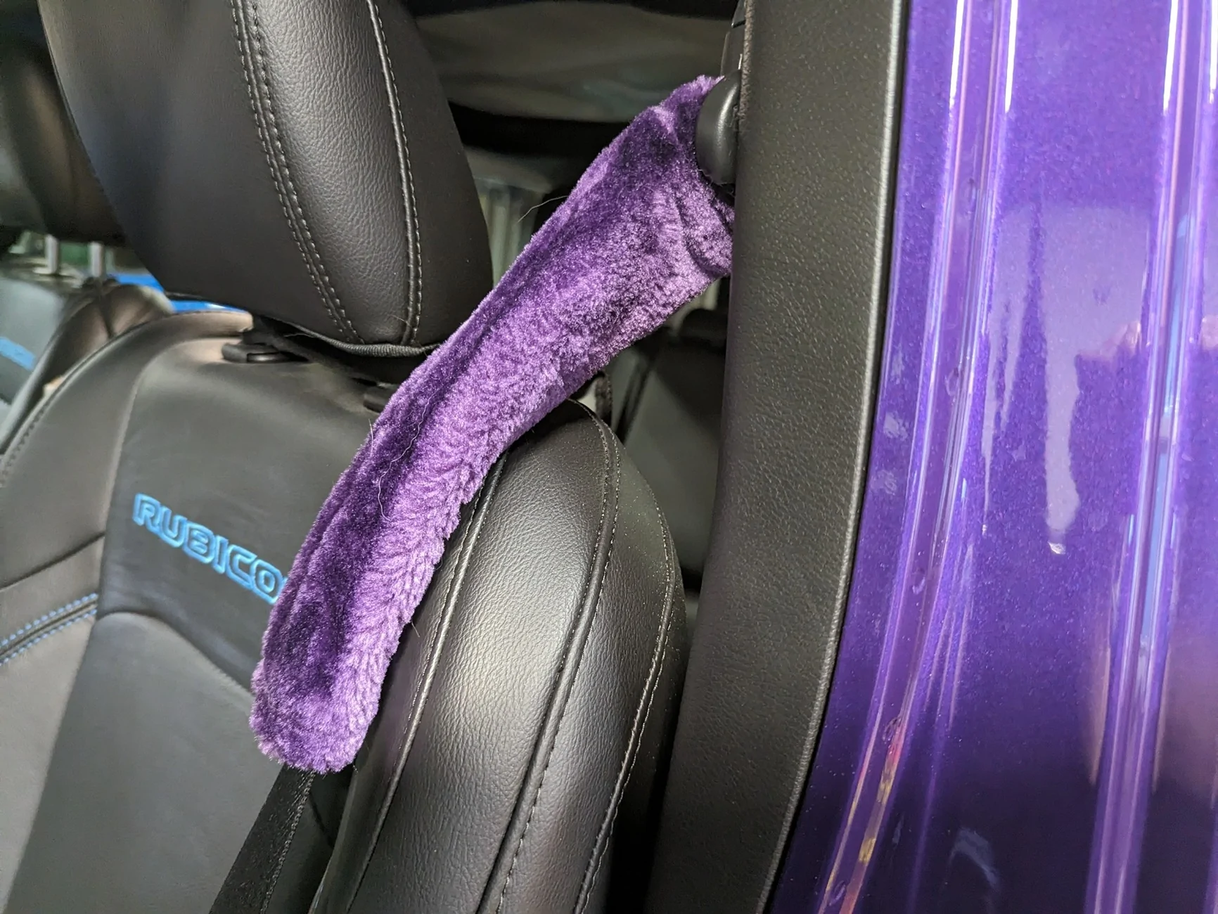

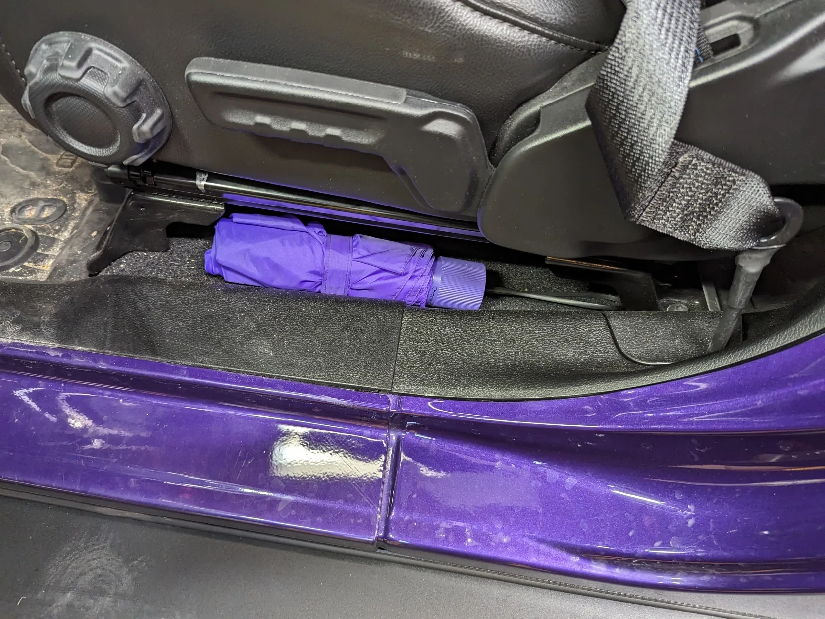

And to say she likes purple (2 purple hats, purple shoes and socks, purple jacket)
Jeep Wrangler JL Question for experts about full time transfer case availability PXL_20240521_170152814
Jeep Wrangler JL Question for experts about full time transfer case availability PXL_20240521_170201552
Jeep Wrangler JL Question for experts about full time transfer case availability PXL_20240521_170156101

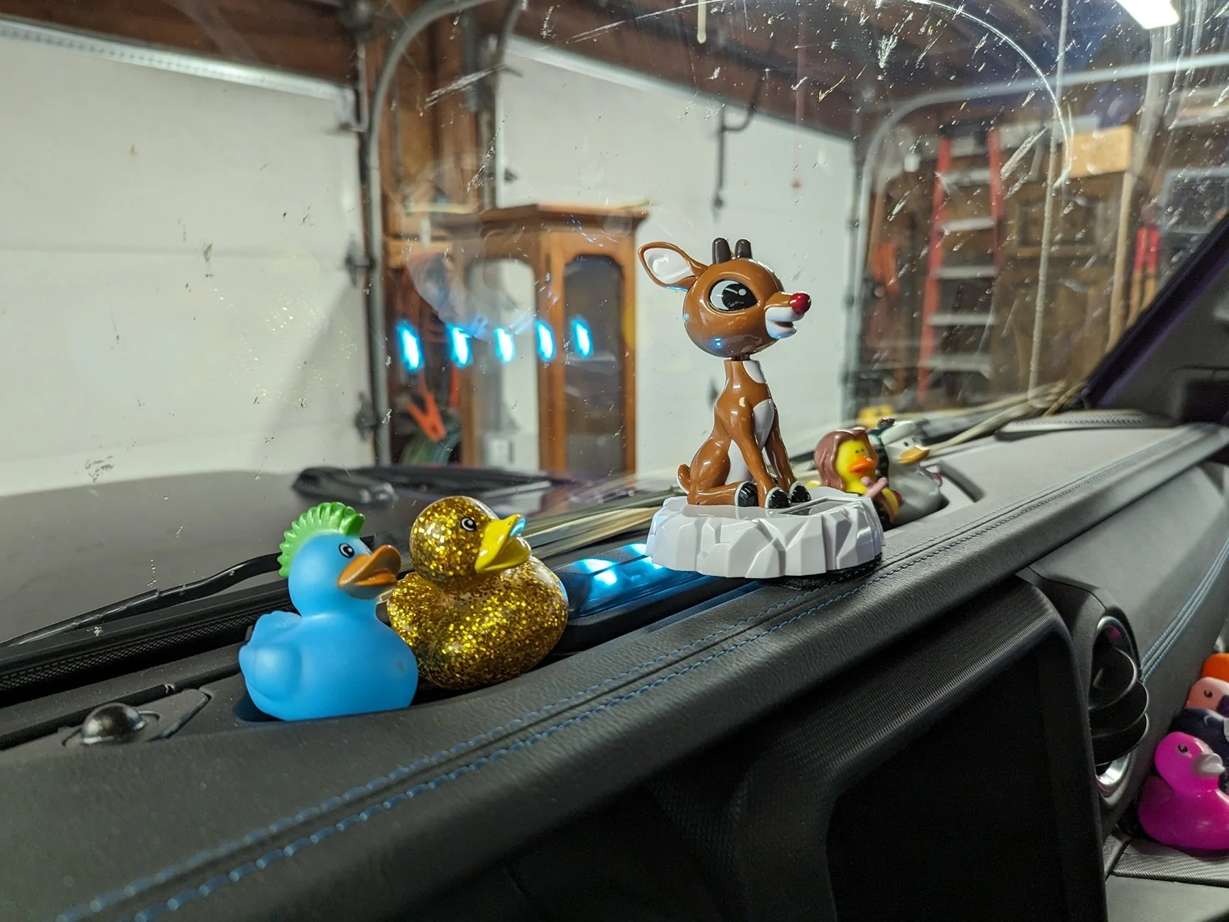

Rudolph is even front and center on the dash

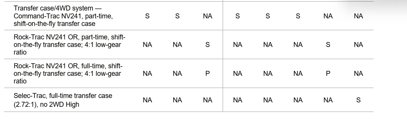

Just checked - it's not only not available at all, look at the only way it's available in the Moab 392 JLU - no 2wd option.
It's ONLY available in the Rubicon X with the recon package. No other way.
Any way you can show that whole thing, so I can see what trims each column is representing?
