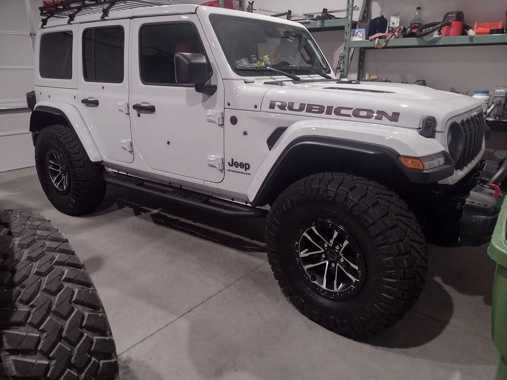

We bought a 2024 Rubicon X, took it straight to discount tire and put on nitto 37x12.5 r17 tires and have no issues on the trail. It comes with 1.5 inch factory lift, after 2024 all have full float axels. I include here a before and after picture.
Jeep Wrangler JL Rubicon vs Sahara Trim B4 tires
Jeep Wrangler JL Rubicon vs Sahara Trim After 37s
