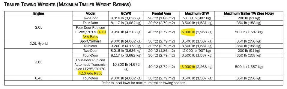

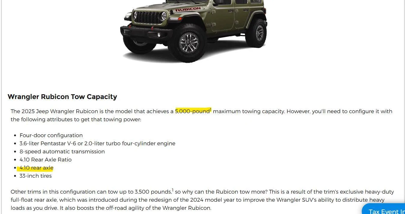

They've done a terrible job marketing and documenting it.... Both the 4 and 6 cylinder engines with base wheels in the Rubicon gets the 5k. The Xs bigger wheels drop it back to 3.5k. I had no interest in the 4xe so I never paid attention to whether it gets the upgraded tow capacity
If that is the case, it makes me wonder if the Xtreme comes with the full float rear axle (I would hope that it does). Reading up on it, it looks like both the 392 and the 4xe Rubicons are still limited to 3.5L because of their weight and suspension.

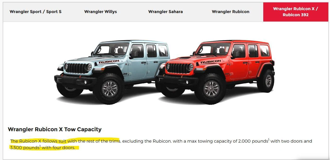

I *believe* this is only for a very specific trim/option on the Rubicon, not just all Rubicons (but happy to be proven wrong).
You are spot-on. The Rubicon X Xtreme Recon has the 5000 lb towing capability. "Normal" Rubicon models and below are rated at 3500 lbs.
Yes, the Xtreme Recon has the new axle.

Interesting. Your graphic is right and I was off with regard to the normal Rubicons. Most of the entries out there say 3500 for all models, including Rubicon, but a deeper dive shows that the 5000 lb capacity is based purely on having the floating rear axle that was new in 2024+ Rubicons. The other models continue to use the semi-floating axle. Thanks for the vector check! 👍
