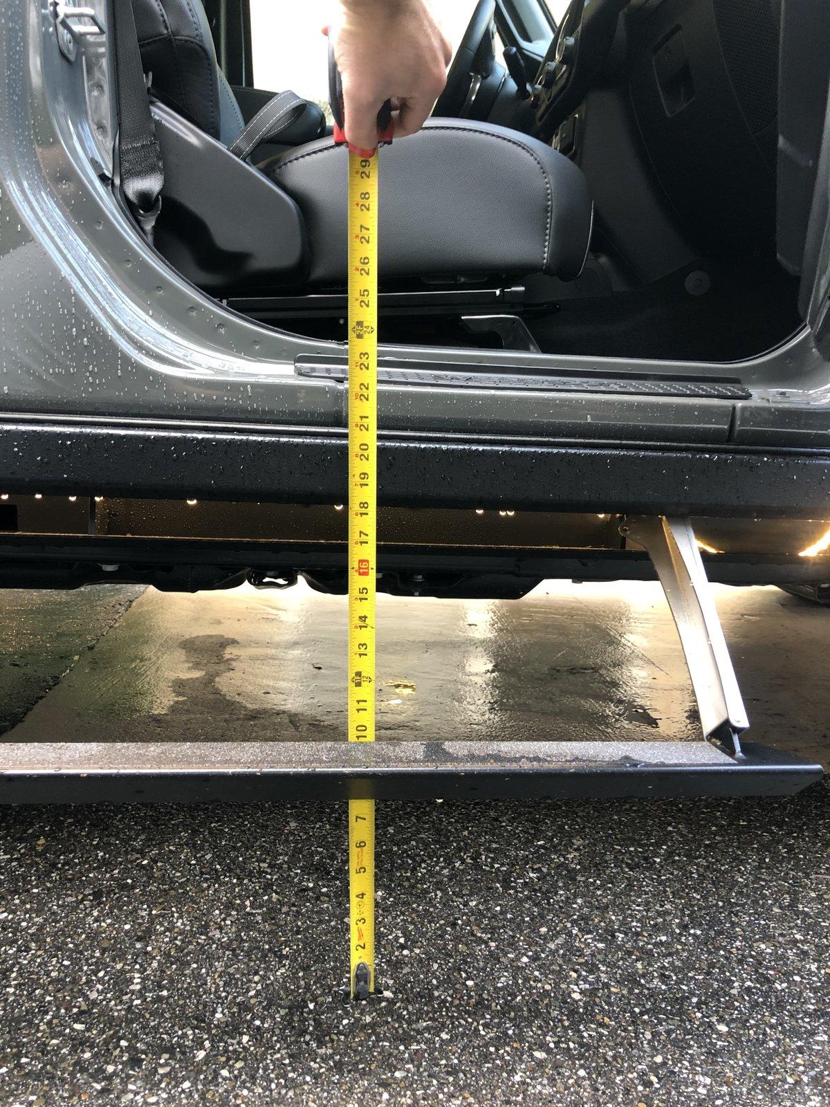

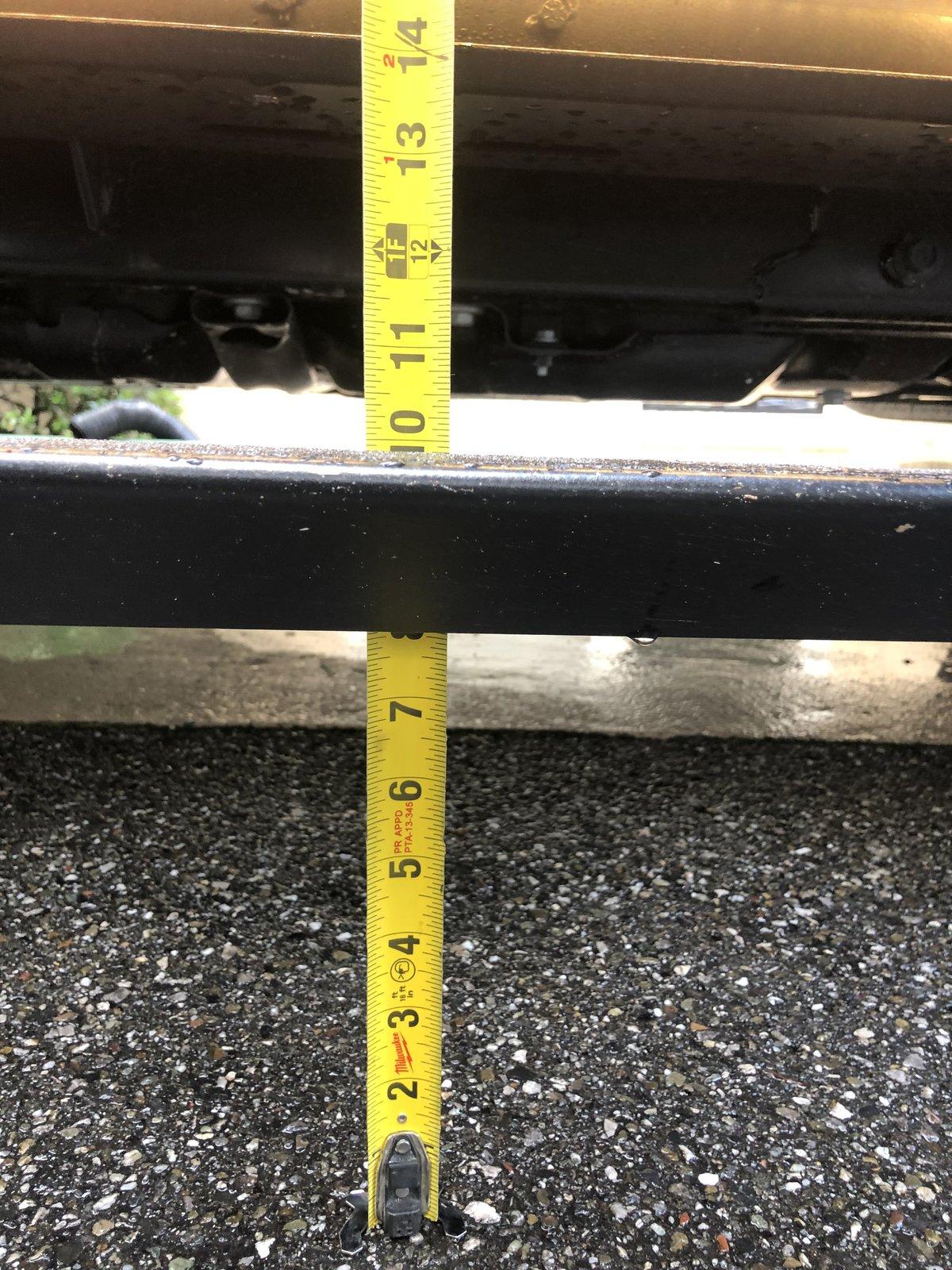

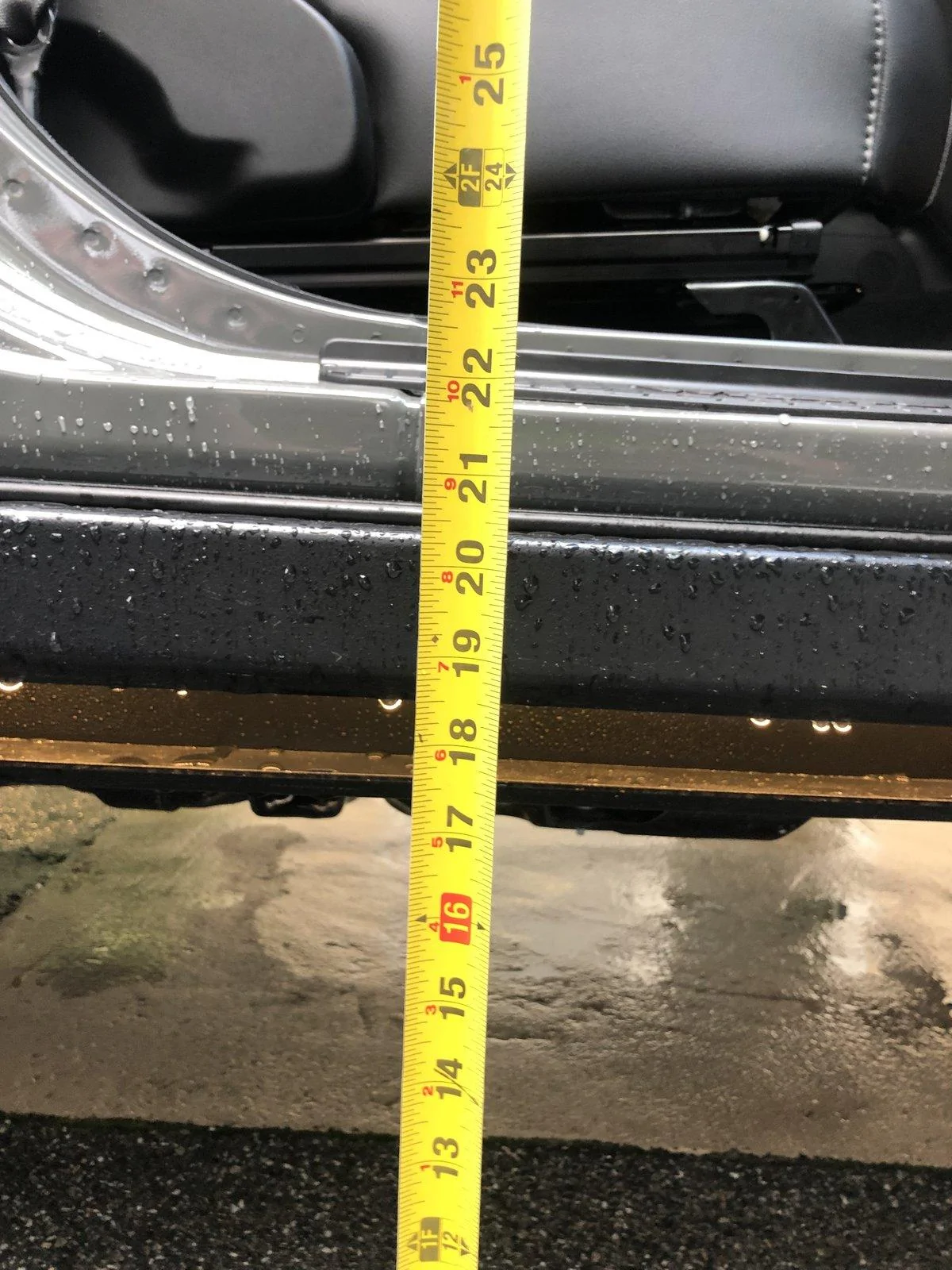

Are you running bigger tires or stock? Wondering how high it is from the ground on stock. Probably 8 inches?
Jeeper
Sep 25, 2017
166
103
Acura MDX 2015, Ford F150, Honda Odyssey,
I have 34x10.5 KO2’s (not stock). Here are some visuals. Compared to stock this is probably 3/4” taller.
