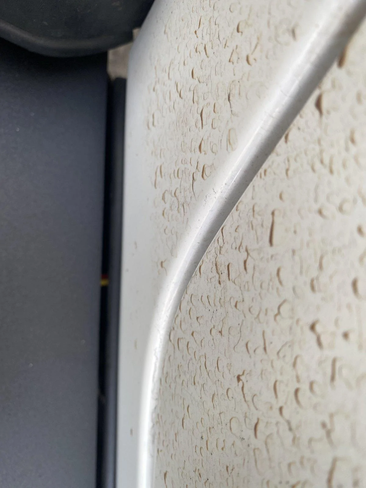

I have a two door manual. I used the grommet that’s on the passenger side and passed through the wire there. Then i installed the harness in reverse. Drive is passenger and passenger is driver (Works perfectly by the way) then i extended the switch wire to the driver side and it works perfectly. I did the wiring first, took me a couple hours. Then the actual install of the steps, maybe an hour and a half. The hard part is routing the power wire through the grommet on the passenger side. You can alway use the grommet that underneath the passenger side where you see the plug at. Another spot. Ive use the grommet for my Under the seat air compressor and the mopar aux.When my steps were installed the shop had to call rock slide because I have a manual also. They were kinda pissed that the instructions didn’t include option for running the wiring for a manual.
I honestly can’t say how they figured it out but they got it done.
I can try to snap photos of my wiring if that will help.
