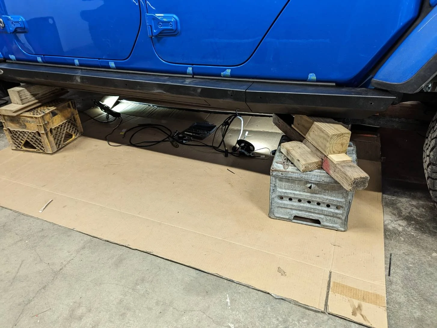

if you do need to take them off - you can do something like this -
Jeep Wrangler JL Rock Slide Engineering Power Steps Issues PXL_20230325_150813080.MP
This setup allows me to take the bolts out (as already described above) and slide the step straight out.
I did this for the install, but also did this for a bolt issue - no trying to line holes up, simply slide the step out or in on blocks at the exact right level.
