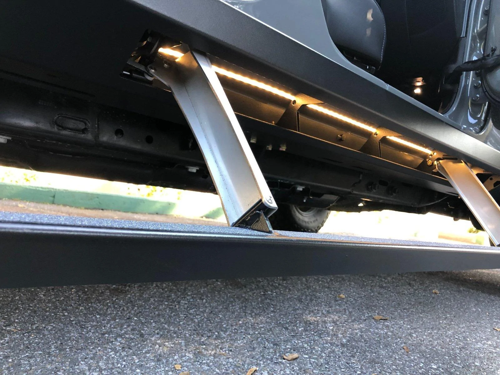

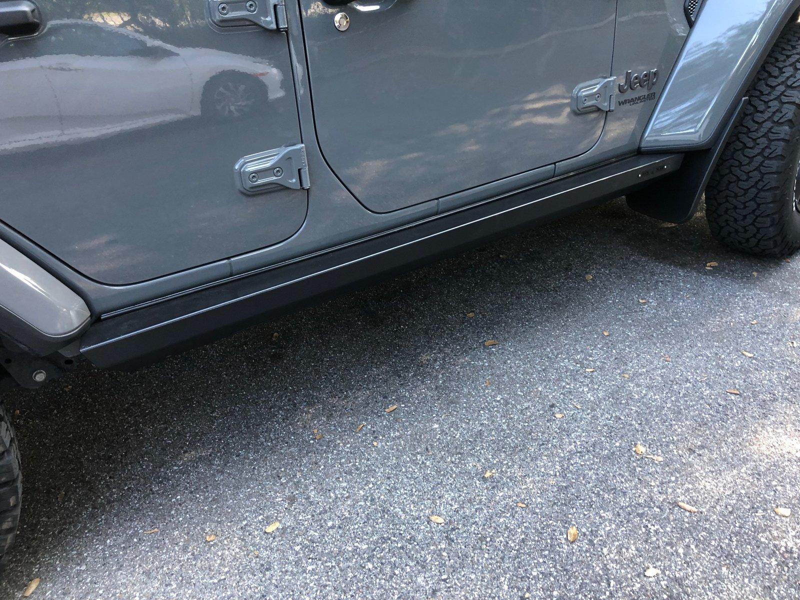

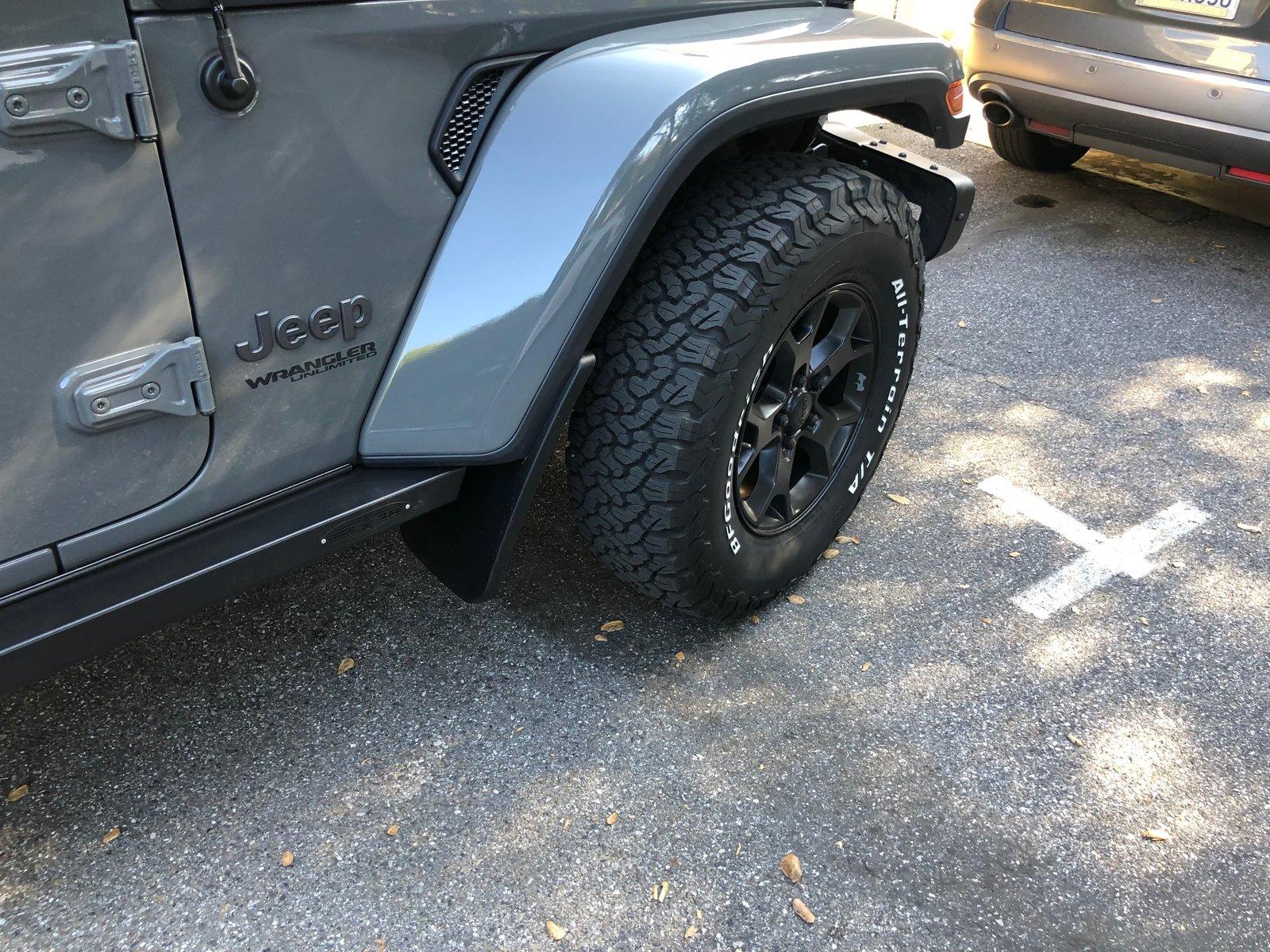

I did the install. Took me a while. Probably 5-6 hours. But I was cautious about the body bolts thing (diligently used a heat gun) and wanted to have a very clean install. I also installed LED strips I found on Amazon that are a "warm" white color (just my preference) and that took a bit longer. That said they were much cheaper than Rock Slide light option and work the same. Quality of step is very high. I hope these last years and years. Very happy with the install. And am very appreciative they included that "button" mount that allows you to place the button next to the OBD port. I would have not enjoyed drilling into the plastics to place that guy. Also, they play nice with the splash guards in case anyone is curious.

I am using 34x10.5 BFG K02's. They are 1.5" larger than the stock set up, which result in a 3/4" rise because half that increase is below the axle and half is above it. So the step is not significantly higher than it would be on a stock tire.
The Amazon lights make absolutely no sound. Even if you don't order the light option, the wiring harness still comes with designated wires for lights (they just don't send you the LED strips). All you have to do is splice them together which is easy with the following supplies.
Rock Slide actually sent me the lighting kit despite the fact that I didn't order it (or pay for it) and it is virtually identical (except the strips are just 18" long) as what I used from Amazon. My cost was under $25.

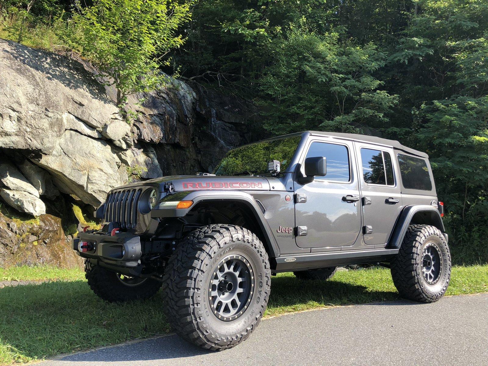

Just got mine installed a few weeks ago. Love them!
Looks great! That’s what I’m going to go with I believe. Can you trim them like you can the amp steps ? Also do they just come straight out instead of rolling like the amp steps do? Thanks.

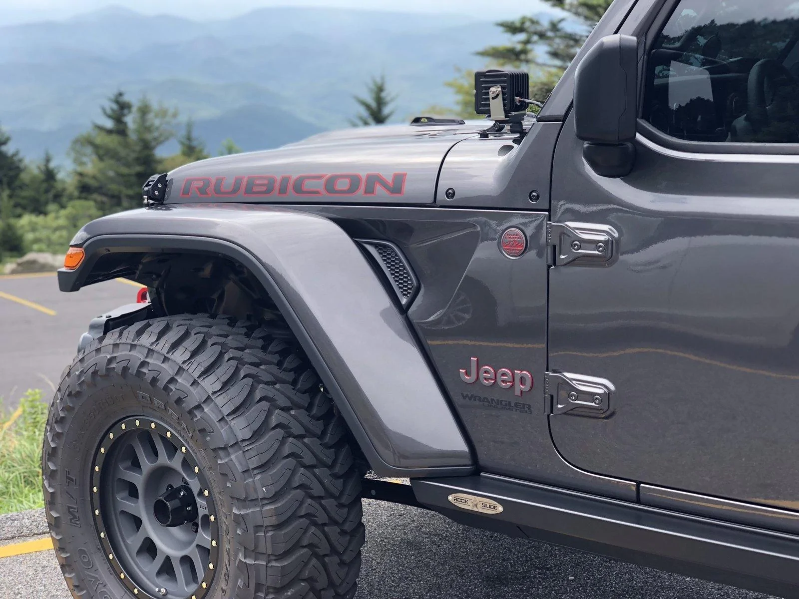

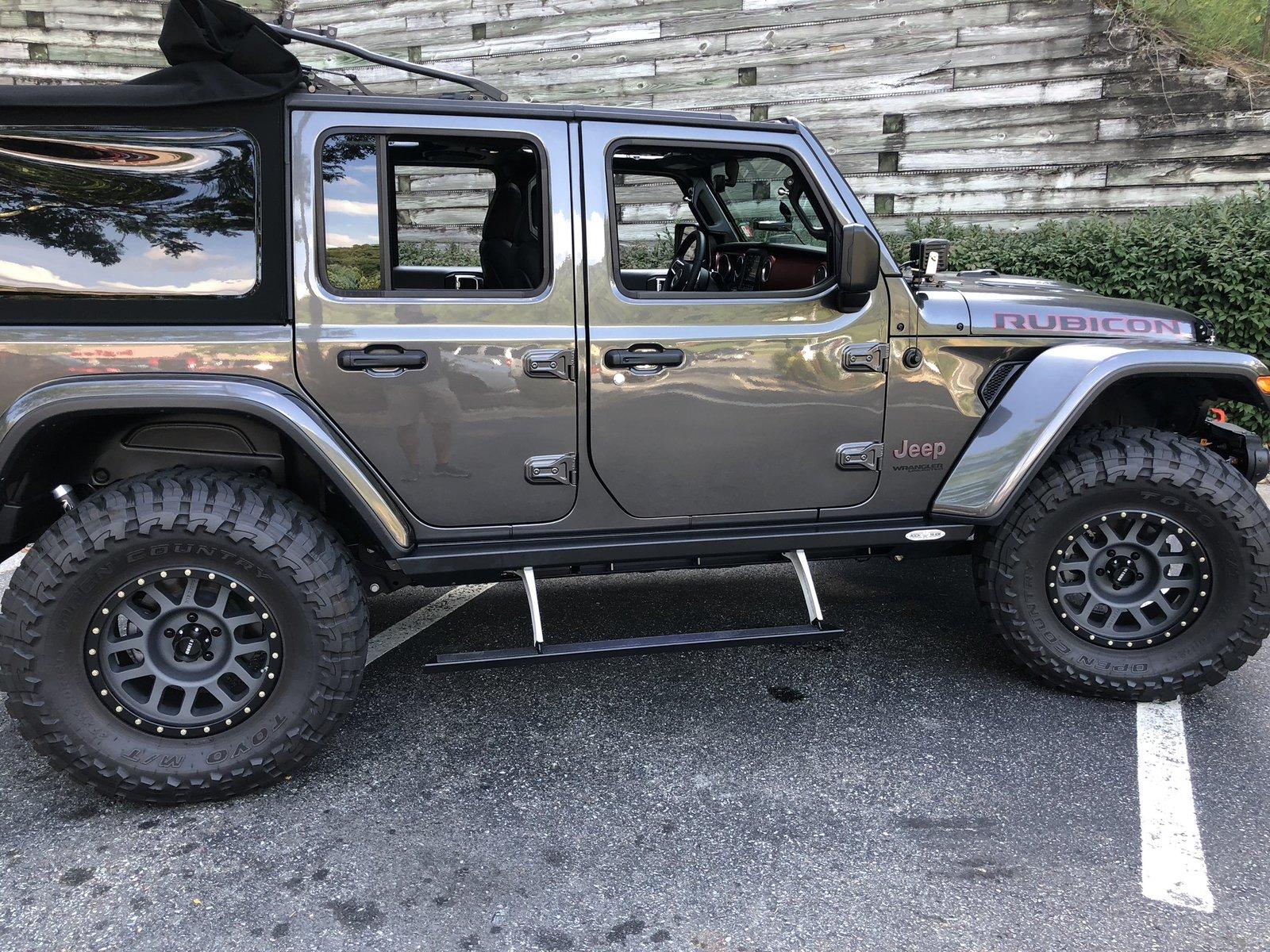

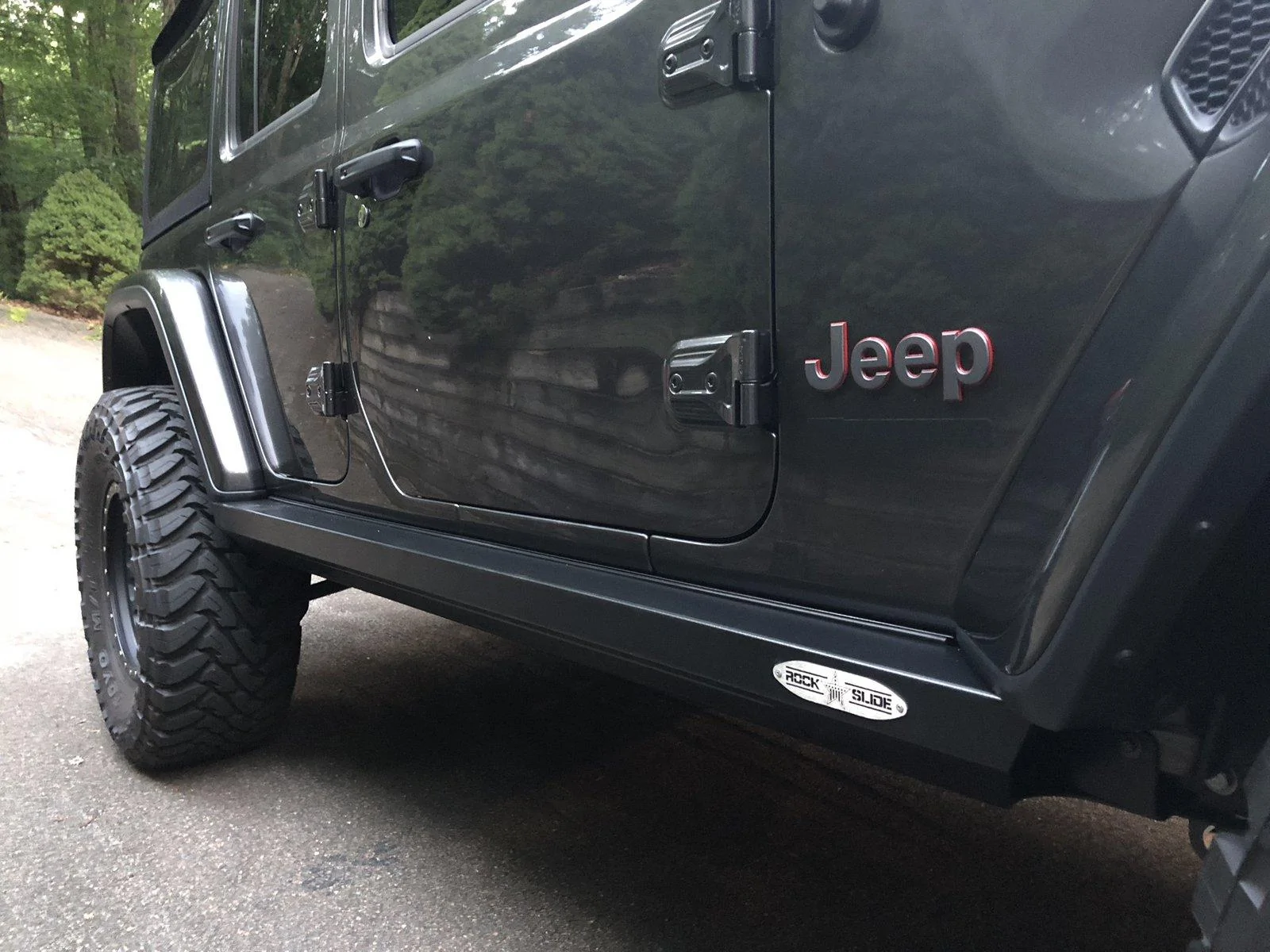

I have 37" tires with RSE steps, no trimming was needed. They are placed between the plastic fenders, so I don't see where any trimming would be needed.

I see what you are saying now, in case it helps you to picture them on your vehicle, here is a link to a short video of them in action, between my 37" tires. I know others have removed the rear inner fender and trimmed about three inches of the pinch seem on both sides of the rear tires to allow for more room.
